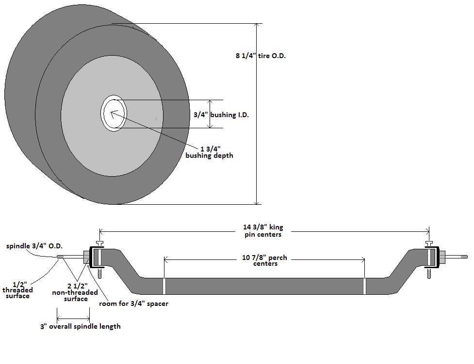

    I've got a guy in Phoenix who is supposed to be building one to my specs, exactly 1/3 scale. He's also building spindles for me, to my spec. I'll build the hairpins and a transverse spring.
    Shoot me a PM and I'll give you his info. I can't give you a good/bad recommendation on him yet, other than the quote was very affordable. If/when I get the axle I'll post pics.

    Get some flat stock-1/8" x 1" or 3/4", cut out pie pieces top and bottom after making a cardboard template for the amount of "drop". Then squeeze the gaps closed and weld. For the top and bottom of the "I" beam, weld on some 1/8" x 1/2" flat stock, following the contours of the "drop". I welded steel pipe to the ends, and bored them out to accept flanged bronze bushings for the 1/4" stainless machine screw kingpins. For the turning knuckles, more 1/8" flatstock, bent to fit the kingpin bores, leaving a bit for bronze washers top and bottom. The axles were welded onto the knuckles as well as the brackets for the steering arm and tie-rod. I drilled holes to lighten, then ended up carving out oval slots to really lighten it. I weigh 230 lbs and the axle/whole ch***is easily supports my weight.

    this is what we use for the drop axle

    nice drawing for the front beam that should look BAD A**** when finished:D:D

    Thank you. At 39 I'm still an aspiring artist with no time to draw. I scratched that out in about 15 minutes.
    Thanks for the pics of how you set up your steering, very cool and simple. I love how the steering links from the back!

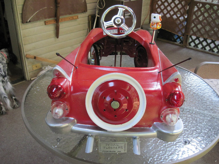

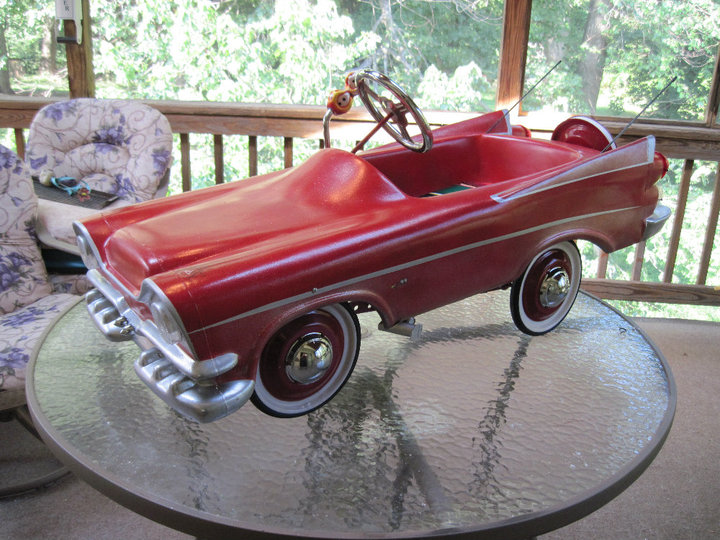

    Here is one that I just finished up last week. It's a 1957 Dodge Body on a mixed parts set up. It was fun to build. :D
      131.6 KB
      553
      116.6 KB
      453
      95.8 KB
      448

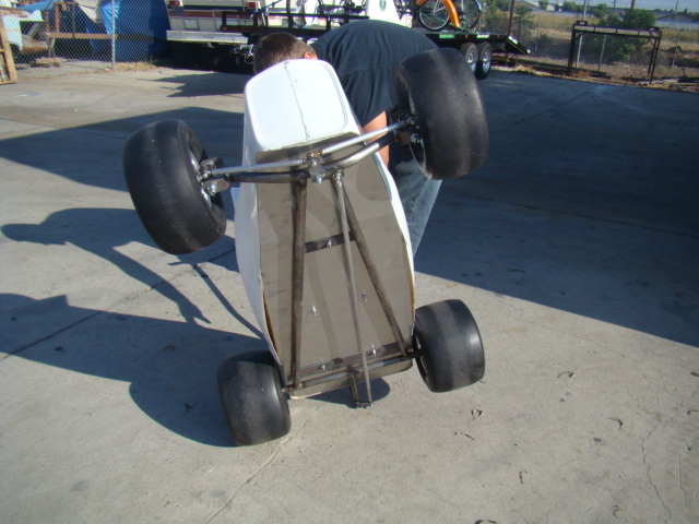

    i got the stroller from the pinstriper today..
    By br0kenb20 at 2010-08-07

    just got the stroller from getting a fresh coat of clear..finally time to get it put together.
    By br0kenb20 at 2010-08-18

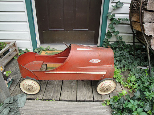

    Here is one I saw going to the tip (dump) the other week.

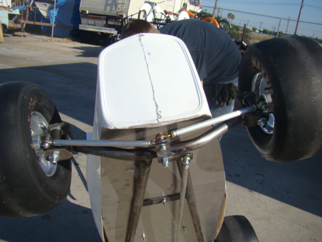

    i finally got the hinge figured out..heres some pics..
    By br0kenb20 at 2010-09-03
