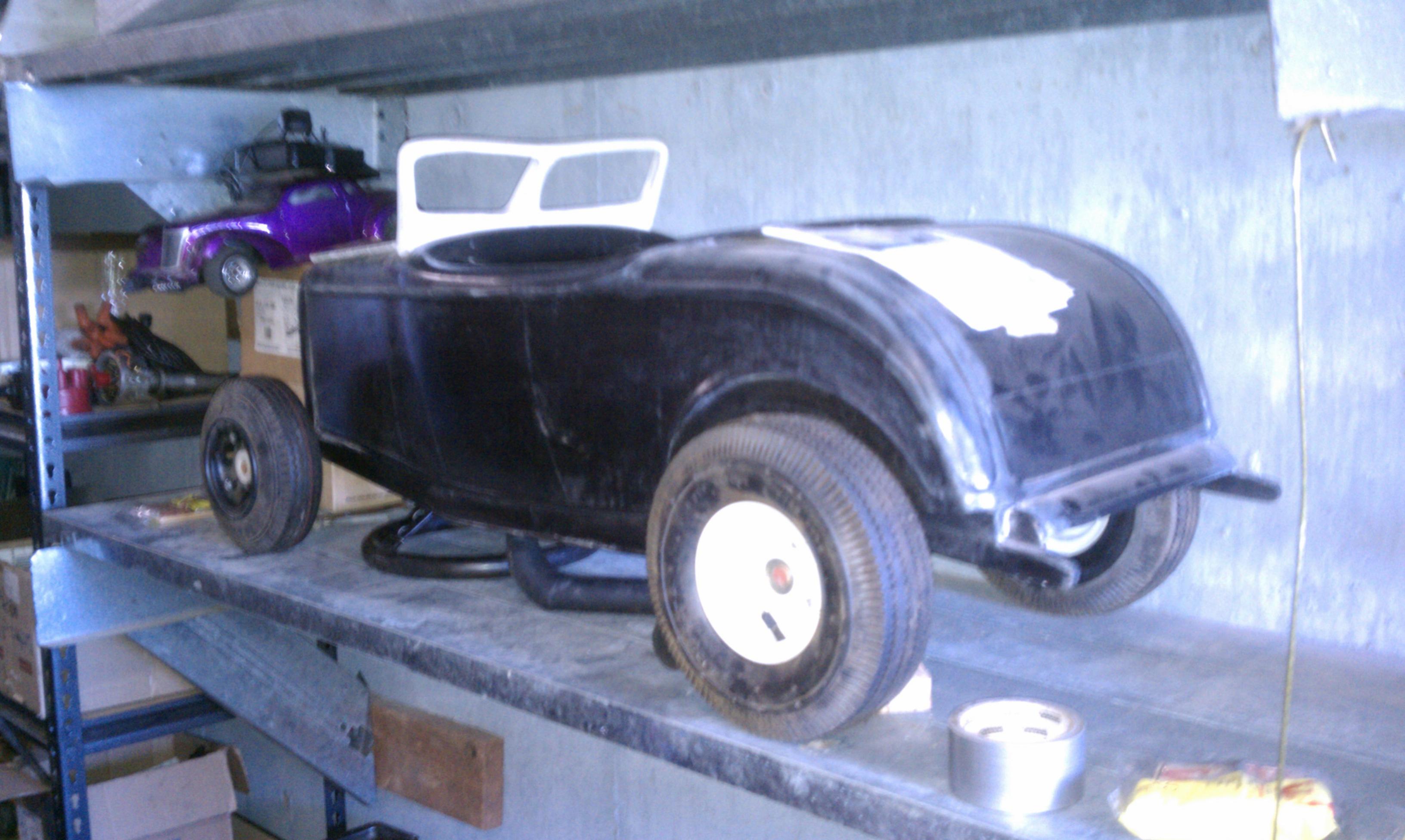

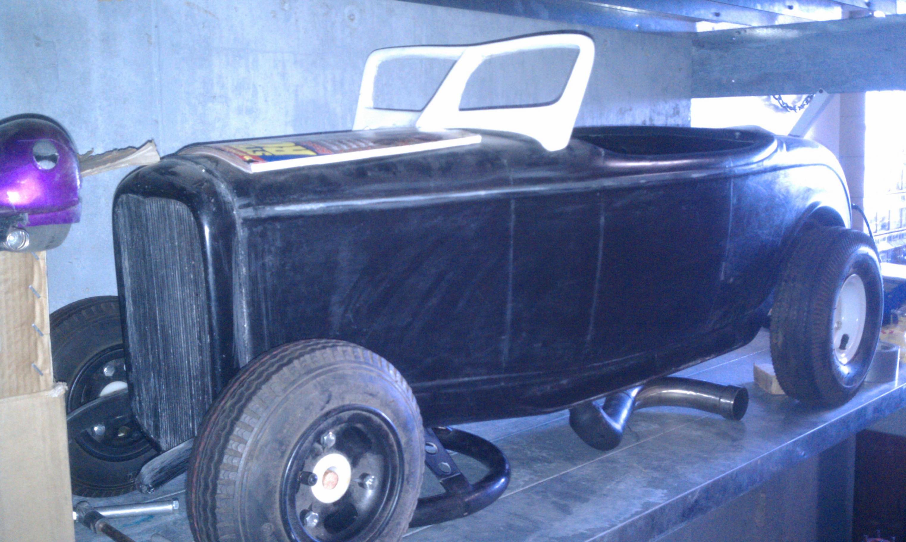

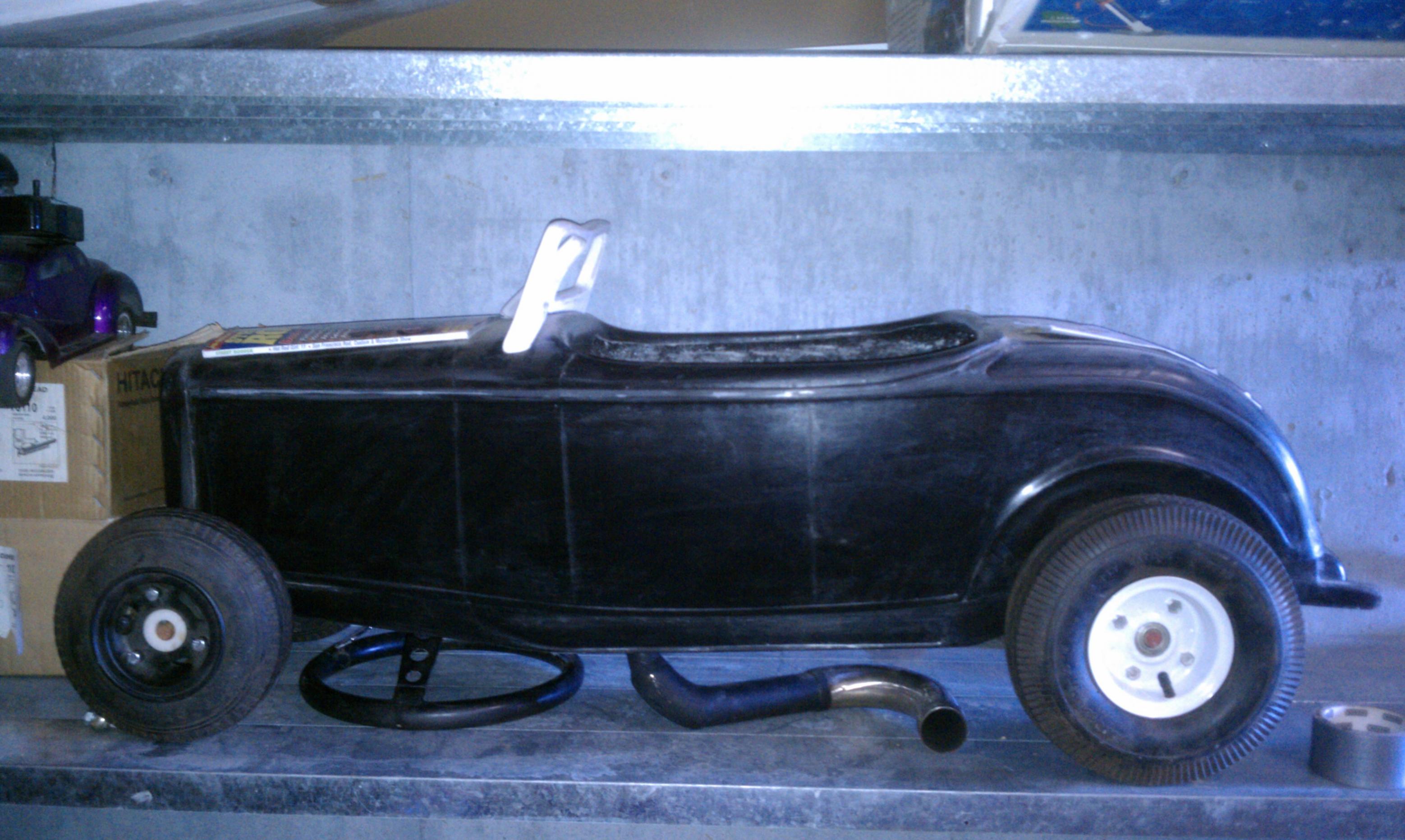

    Pop Tops is gone??? That ****S! Their tops did nothing for me but the bodies are *****IN and the guy who did them is really nice. Here's a pic of mine, it's a VERY true 1/3 scale (except for the windshield).

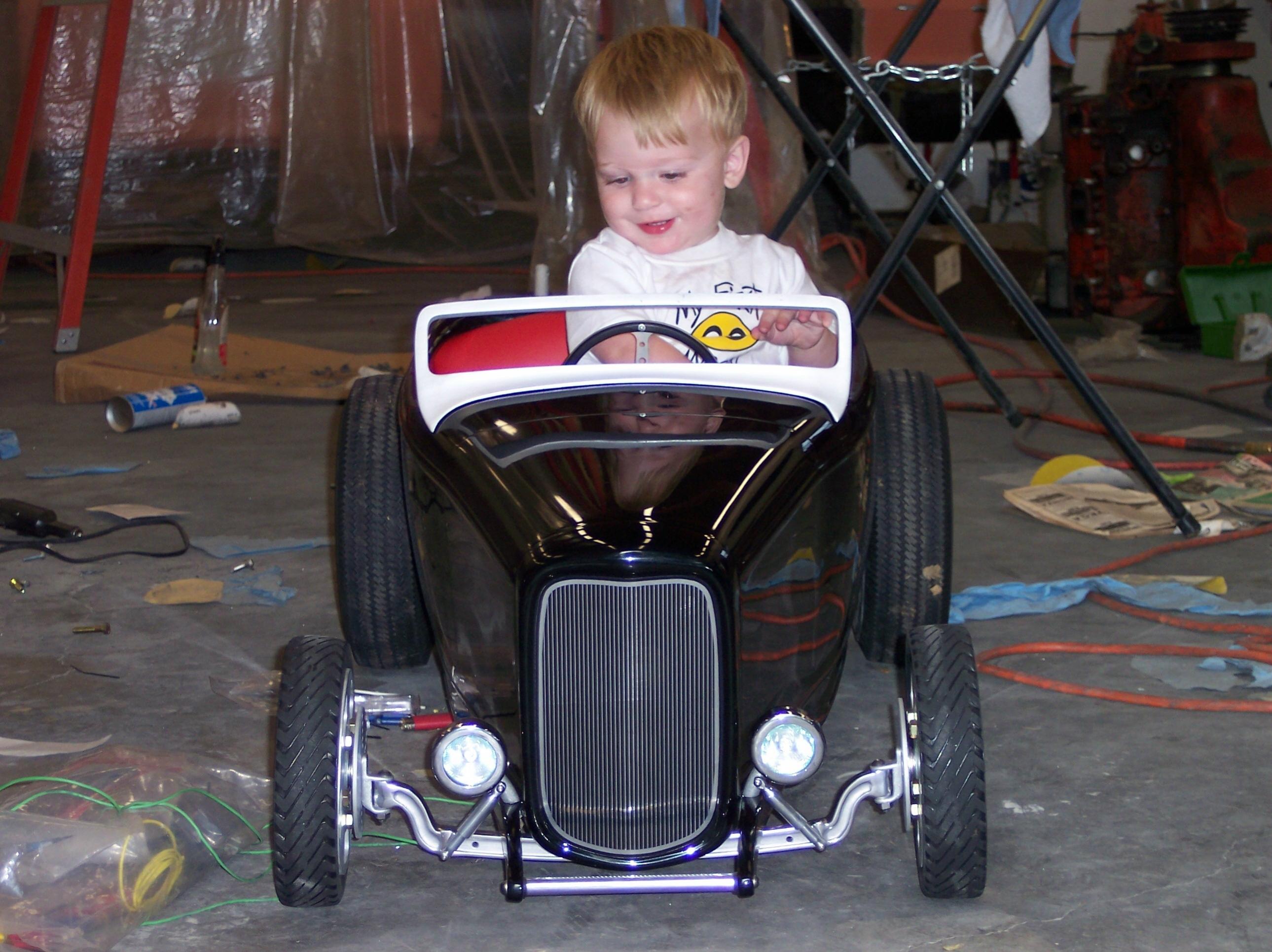

    I called the # listed on the Pops Tops website and was told the company no longer existed. He did give me the email address of Scott Gordon (who actually made the bodies) but no reply so far. I posted pics at the start of this thread of one I built 5 years ago for my son. This one was built from an Aero Fibergl*** body, but it appears to be the same body that Pops Tops made (same mold at least). I am now building one for my daughter (my son won't part with his...even though he's outgrown it). I like these bodies because they actually look like a 32 Ford. I really hope to find another one, any help in locating one will be greatly appreciated!!

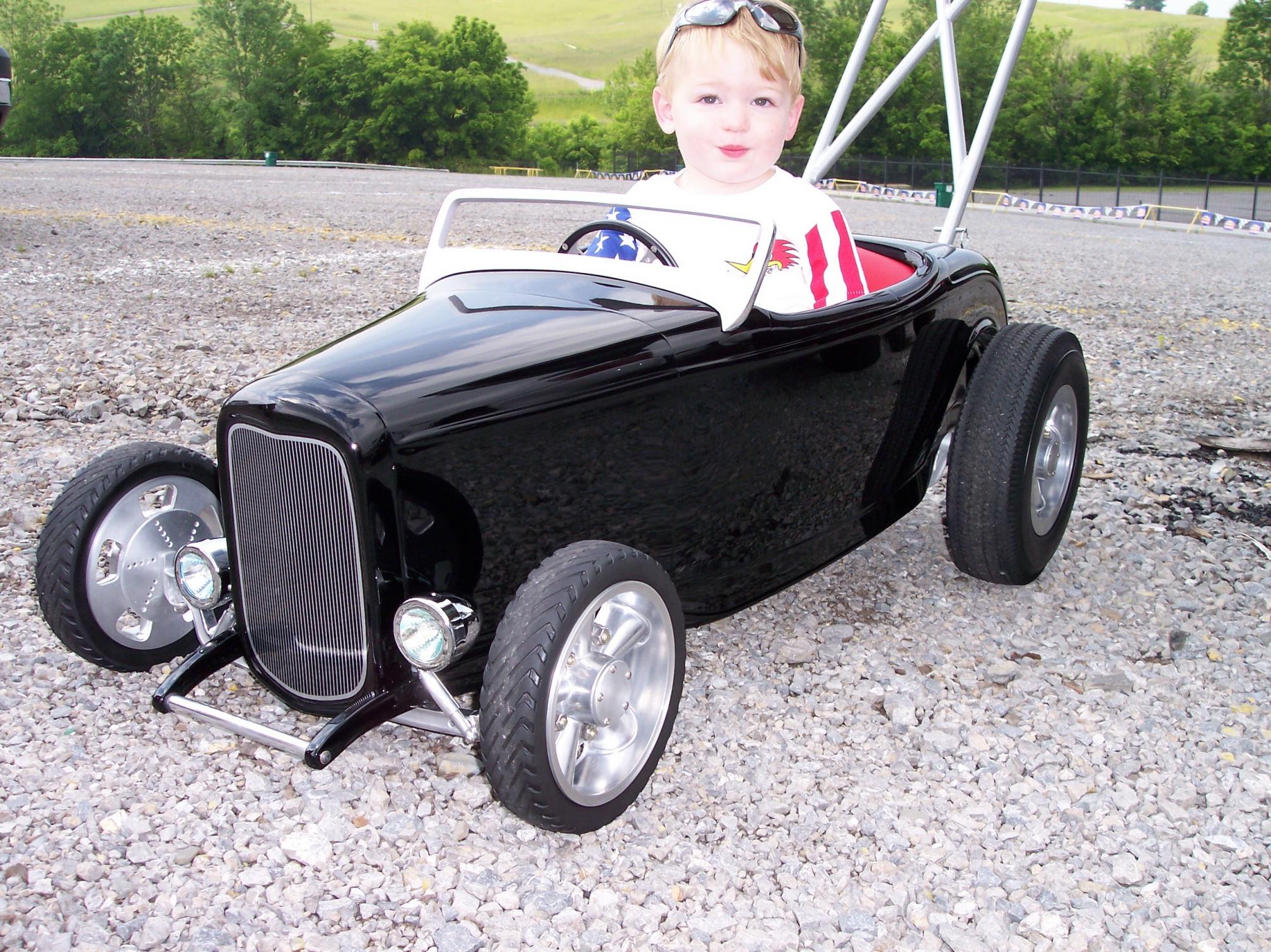

    Joined: Apr 12, 2010
    Posts: 134
    BROKEN PEDAL CAR
    from Visalia CA
    Wow that black pedal car is awesome. Did u make the drop spindles ?

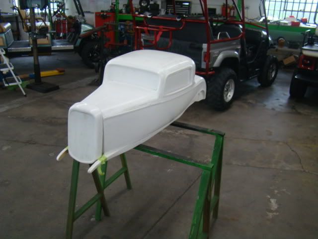

    here is the 32 body we sell.. doesnt have the frame rails... i do have a 32 3 window that has the frames rails that we can make into a 32 low boy
    here are some pics

    From what I understand, Ralph Galliford originally built the mold for the body. Years ago he built a totally *****in 1/3 scale pedal car of a '32 Roadster (painted in Socal colors). I have seen this body made by Scott Gordon, Aero-Fibergl***, and I am told that Poliform makes one as well. I am waiting on a picture of the Poliform body...if it is the same, I will go ahead & get it. I have to get going on this for my little girl so she can ride in the spring! In the meantime, if anyone comes across one, let me know!!
    As for the questions...yes, I made the spindles. They are just flat stock bent to match the axle, with an axle stud welded to them. Eric, I'll pm you on the axle...

    im digging it..clean and simple. What kind of wheel are the fronts ?
  20. thequietwon
    Joined: Mar 21, 2006
    Posts: 600
    thequietwon
    Those are Astro (I think) 6" gokart wheels. I used the outer halves & made the inner. I turned down the wheel lip on a lathe to make it look more like a car wheel. The tires are off a lawnmower. When I built this one, that is the only wheel I could find. I think they are too big, that's another reason why I turned them down...to make them "appear" smaller. In person, though, they look good.
    For my daughter's I have scored a set of miniature kidney Halibrands...4"s for the front & 5" for the rear...

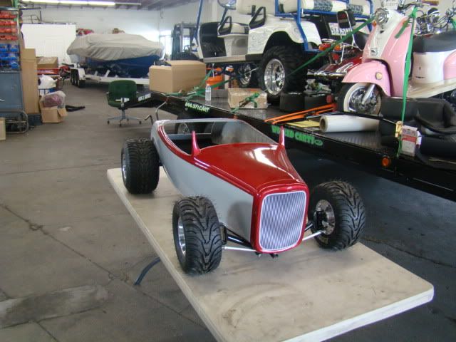

    I picked these up today!!

    The guy I bought these off of made it all out of steel with a aluminum deck !! It has amf wheels and hub caps and is powder coated !! He was going to sell them on eBay made a few and they did not sell for what he wanted ..
