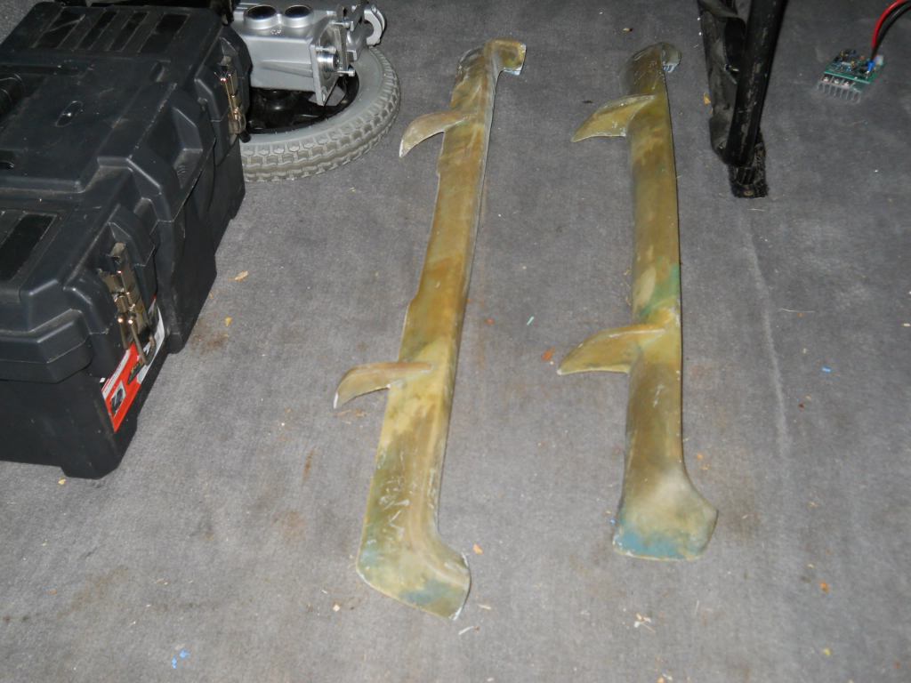

    got some stuff from the chrome shop today..hinges for the suicide hood. before and after the chrome..heres where they go.

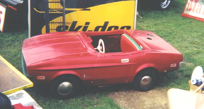

    Here is my latest project (not HAMB friendly)

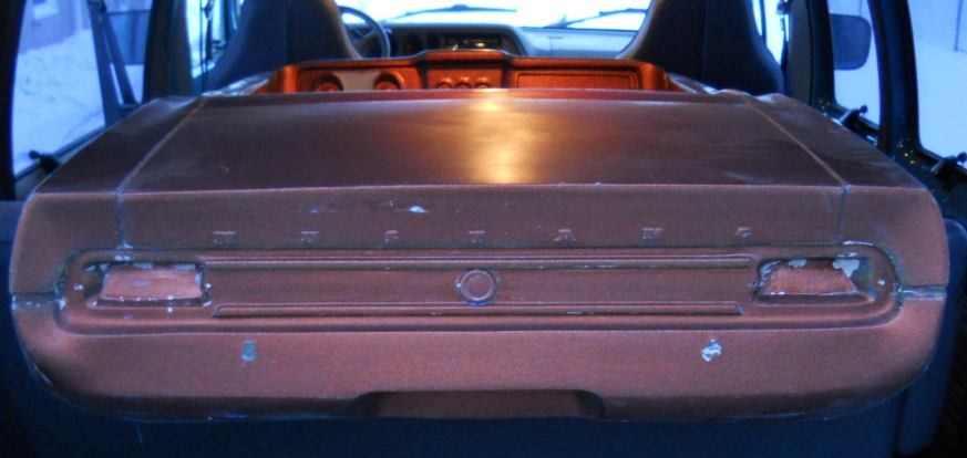

    It's a 1971 Mustang Junior by the Conval company a 3/8 scale highly detailed go kart that was made for dealership promotions. They were gas or electric powered with working headlights, taillights, brakelights and horn. The body had a big hole in the hood that needed fixed, photos are in the back of my van since it is too cold and snowy here now.
    I am thinking it needs to be painted Yellow and black just like the Elanor in the first gone in 60 seconds movie from 1974. I am working on the taillight lens mold this weekend so I can remake the original style lenses.
    The one in red is a more complete one showing the side view.

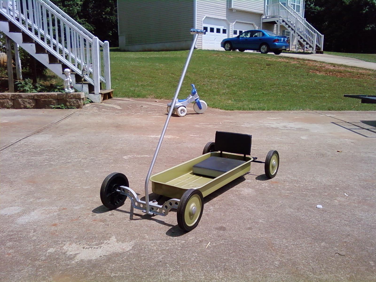

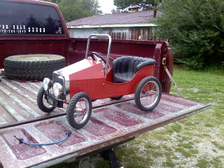

    Here is the two I built for my kids.The wagon started as a $25 cheap wal-mart buy.The roadster came from clist for $20.I got a bunch of half inch square tubing and built some frames for both.The drop axles are just cut out of 1/8" plate.I made the center first and beat and torched the tops and bottoms to fit.Welded them all together and then drilled the center.The kids love riding in them at cruises and shows.Now if I can get my car painted and back together we can all have some fun.

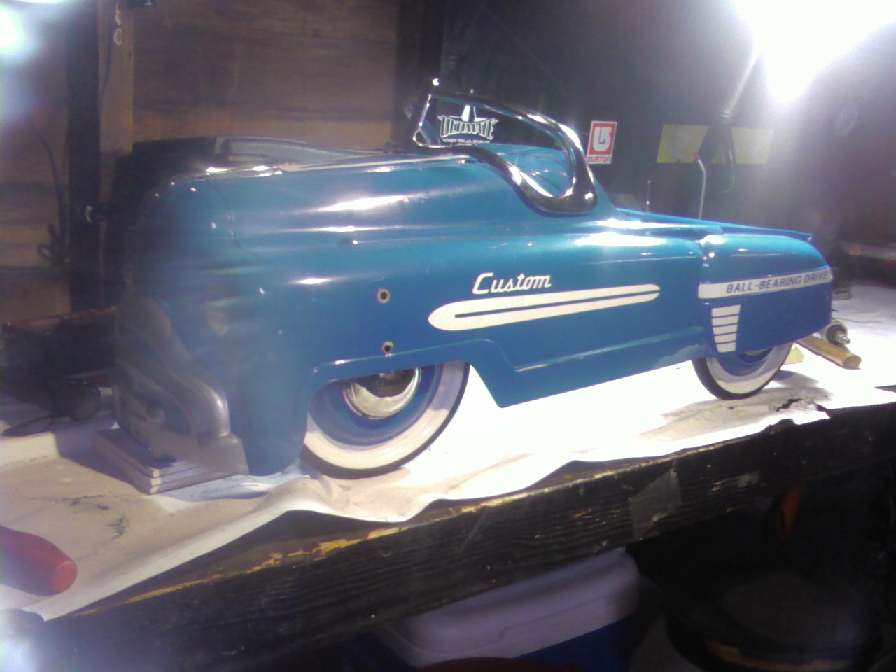

    Here is s sneak peak at one I just sent to the upholster shop to get the interior put in. I will show a build on it later. It is for my grandson I built 3 one for each of my grand kids for their 1st birthday. Powered by a dewalt drill motor. They have a blast.

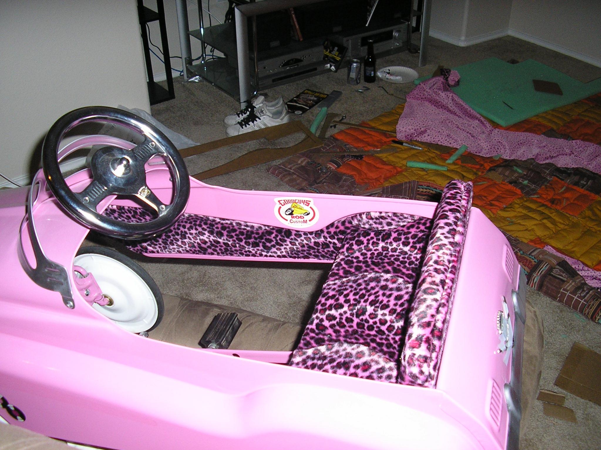

    I'm doing a 62 Caddy for my girl that has airbags like one of the guys on here only mine is gonna be a bit simpler and will hopefully employ some power of its own. (Thanks to your great idea!) Maybe RC? Who knows, anyway here's a few shots of my vision of my girls first hot rod, and the finished product.
