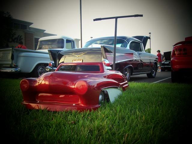

    Took these at last years show in Myrtle Beach. It was used by a pinstripper.
