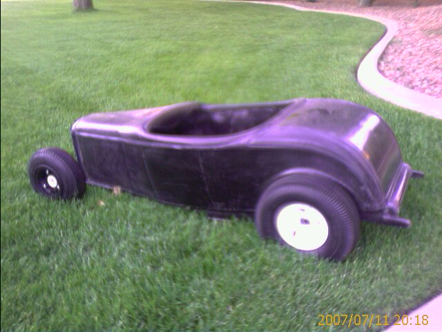

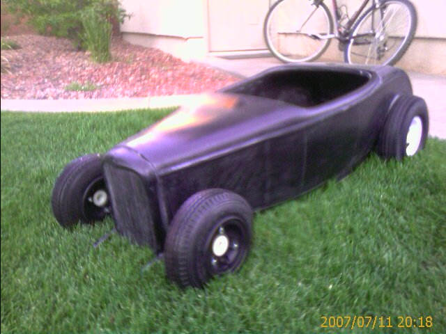

    i personally would have cut that center decal out and made it billet or something cool. Looks good though
  2. Mr Wicked
    Joined: Dec 15, 2009
    Posts: 69
    Mr Wicked
    from cali
    that would be cool but i havent found a customer that will pay for the time to build a billet grille..

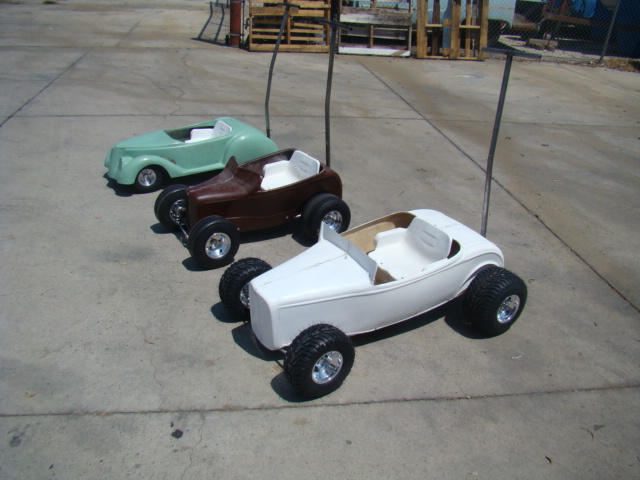

    here are some more we are working on
  4. James66g
    Joined: Sep 20, 2006
    Posts: 558
    James66g
    Dude were are you getting your rims at!?

  7. Mr Wicked
    Posts: 69
    Mr Wicked
    from cali
    they are go-kart wheels and tires... i have many different ones to choose from

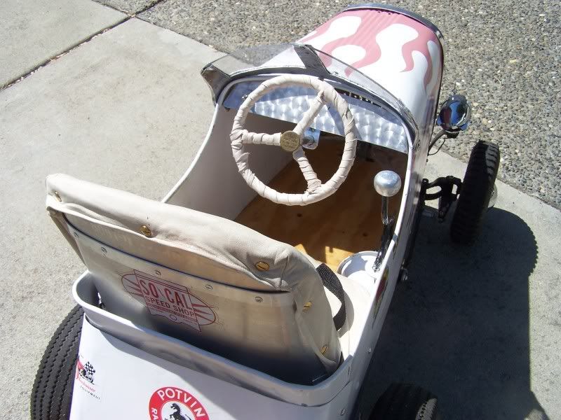

    1938 Steelcraft Pontiac with some tweaks. I removed the grill, axles, pedal ***embly, etc. I kept all parts!
    Aluminum frame
    Flathead piston diff.
    Dropped "I-beam" bushed front end
    Harbor Freight tires
  15. 1952henry
    Joined: Jan 8, 2006
    Posts: 1,680
    1952henry
    Aluminum aircraft style seat (riveted together) with leather cover attached with Chicago screws
    Aluminum riveted windshield frame with plexigl*** "gl***"
    Removeable leather top
    Aluminum riveted grill
    Rear steering, which also activates the steering wheel Made from 3/8" and 1/4" rod with br*** tag from old exhaust horn for hub cover.
    "Shift lever" activates 1930s bicycle horn
    Ebay headlamps, baby moons, and stoplamp lense.
    Aluminum "engine turned" dash
    I wanted it to resemble a '40s hot rod with Model A-style ch***is. It has a split 'bones and a transverse spring in front and wishbone/transverse spring in the rear.
    It was fun to build and my soon to be 18 month old daughter loves it!

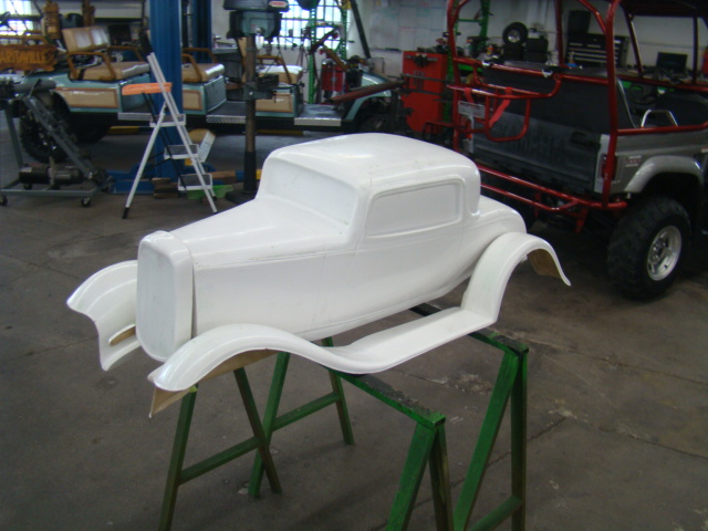

    Hello!
    I have searched everywhere for a Ford 32 body and the only place where i can find it is at wicket carts and they don`t ship to Sweden.
    Can you please help me find one 32 Ford body i really want to build a pedal car for my son
    Best regards Mikael
  24. daddio211
    Joined: Aug 26, 2008
    Posts: 6,012
    daddio211
    Mikael, look at post #76. These are by far the best proportioned bodies I've seen.

  26. daddio211
    Posts: 6,012
    daddio211
    It's about 48" long from the front frame horns to the rear frame horns. Measuring from the bottom of the ch***is (ch***is and body are molded as one) to the top of the cowl is about 12". It's a true 1/3 scale body, so if you have a deuce roadster take a measurement, divide it by 3 and that's how this thing measures.
  27. daddio211
    Posts: 6,012
    daddio211
    By the way, the windshield is nowhere near proportional. I won't be using it, but it's like $25 extra from the Bop Top guys.
