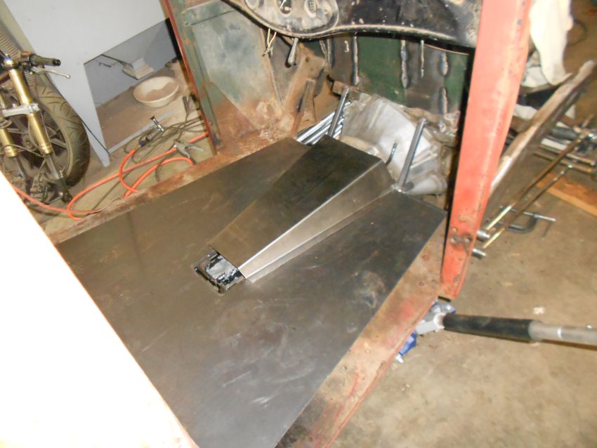

    clutch,brake and gas having trouble fitting all in with trans tunnel. has anyone else had this problem. thanks in advance

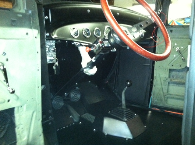

    Yep. I made a cut out in the tunnel for my foot.
    Kinda tough to see in this pic, sorry it's the only one i have.
    Worked for my set up. All depends on if you have room under the tunnel though.

    its my 34 truck and has a pretty big tunnel to clear the 6sd

    You don't have anything in there. What does not fit? Floor and tunnel should be last. Build the floor around the pedal and column placement. Otherwise, you'll do it twice. Build the floor, take it out to put in pedals and column, and modify or build a new floor again.

    You are sacrificing a lot of foot room with the square tunnel you made on the metal brake. Try making a round one with a slip roller or something.
