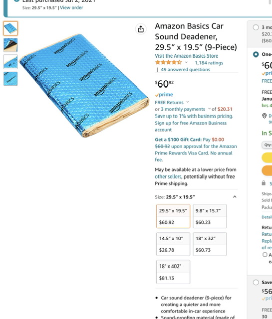

    There is Amazon blue sound deadener. I got two packs for the 57. But did it with about 1.
    I only did the floor so far. Don't forget that these butyl type deadener need seam tape along the edges.

    I have done 2 vehicles now, and continue to buy Noico or Siless, depending only on which I can find for the best price.
    For some reason the Amazon Blue was way more $$ per ft, and I felt the listings were misleading with quan***y per pack.
    You will see several thicknesses. I use the thin stuff for places I want to cover 100%, like the floor, then use the thicker inside doors and roof where I can't or don't want 100% coverage.

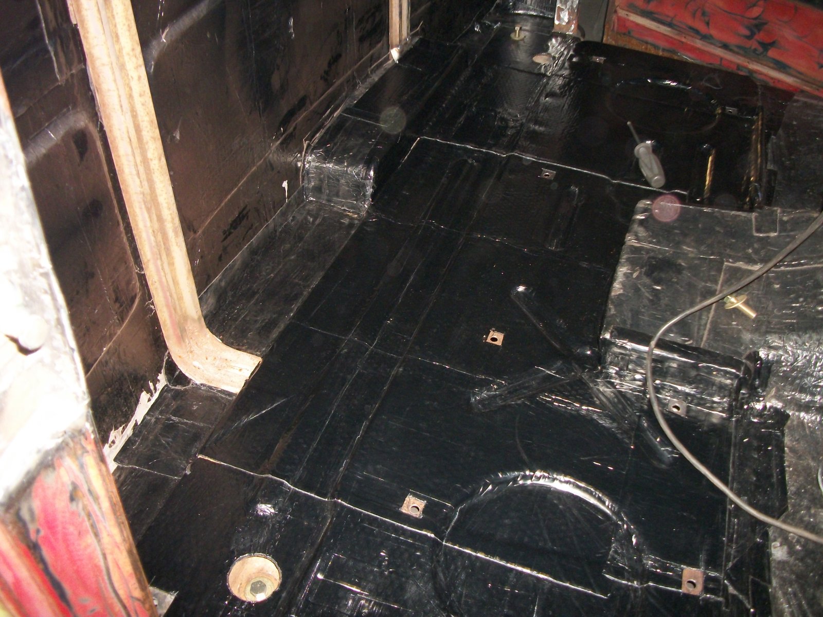

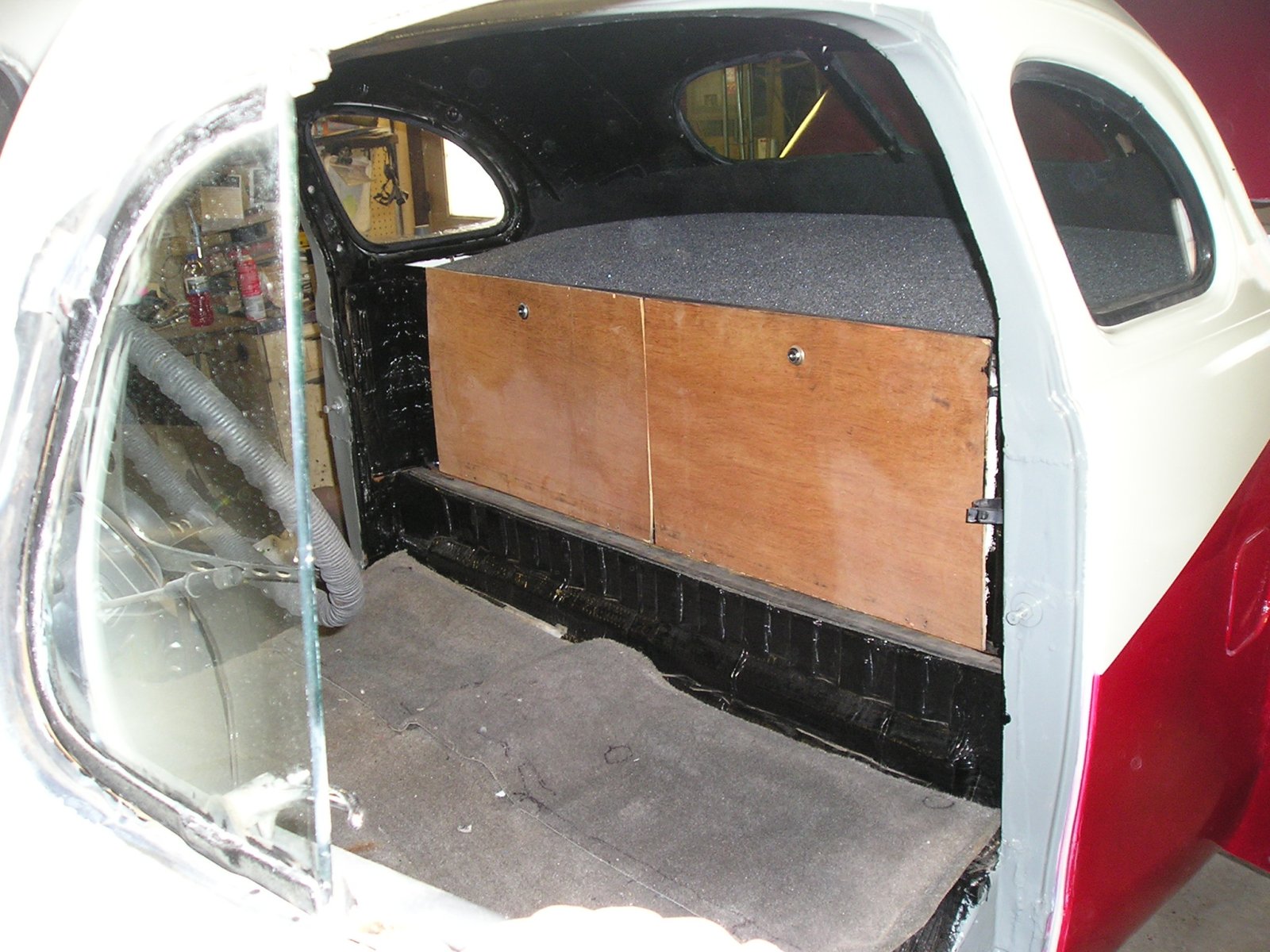

    Pictures or it didn't happen. I don't have pics of the installation process, but I have some of finished areas captured in pic of other stuff during the truck build (too much off topic stuff on the truck for this board).
    The last picture is in my 48 Plymouth coupe.
    When I put the coupe together, I used the silver coated bubble wrap stuff (from Menards) with 3M brush on glue on clean metal. Its a pretty good insulation, not much for sound deadener. I drive the coupe with the windows down at highway speeds. After 4 summers, the brush on glue started to fail. The next summer, chunks of the bubble wrap started coming off the bottom side of the roof while driving on the highway. A clean up and spray glue only lasted a summer. Even with a white painted roof, the missing insulation made the car much hotter inside.
    In 2018, I had to redo the rear window. At that time, I again cleaned to the bare clean steel, and installed the NOICO. I replaced the bubble wrap on every surface except inside the doors (nothing was inside of the doors). The bubble wrap stuff is still under the carpet, and on the firewall. Every place else the bubble wrap was replaced with the NOICO. At this point, its still as tight to the metal as it was when 1st installed.
    The car is cooler then it ever was with the bubble wrap, and the added sound deadener made the car a lot more fun to drive.
