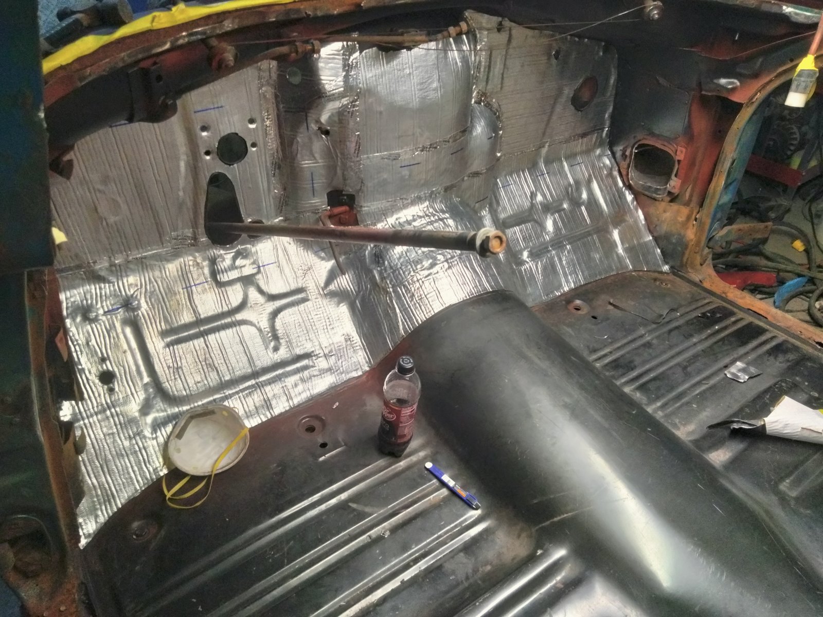

    I just put this stuff on today. Not for sound deadener, but to try and keep some header heat out.

    If any of this peal & stick stuff is actually well stuck to the inside of outer sheet metal, condensation can't form where ever the material is stuck. Condensation forms on the cold side of metal when the other side gets warm faster, and moisture is present. All of the peal & stick acts as an insulation preventing the condensation from forming. If you leave sections not covered, or if the stuff is poorly stuck, condensation can occur just as if there was nothing there. When pressed or rolled into place its stuck pretty tight to the metal. It takes some effort to remove to remove the well stuck stuff.
    The glued stuff works as well to prevent condensation, as long as the glue holds up and the material is held against the steel.

    So why did you not cover the underside of the cowl, and do you intend on covering at least the front 1/2 of the floor? You are leaving the job 1/2 done, in my opinion.
  5. I didn't cover the top of the cowl or the front floor because I didn't think that it needed it. I don't think I'll have a big heat issue from the top of the cowl, it's really not even part of the engine compartment. As for the floors, I'm not sure yet if they will get covered. I only did the firewall already because it was easy to get to while the dash is out.

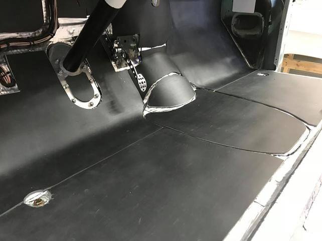

    27749892_532412997145140_5945443677072160913_n.jpg 27751994_1565490653488410_7221447507049820260_n.jpg I've had good results with FatMat products. I did the entire cab with "Rattletrap" which is their foil faced butyl product. From the top of the firewall to the seat base is also covered by FatMat floor liner which is a high density closed cell foam material. On top of that there's thick jute padding and carpeting. Heat and road noise are virtually nonexistent.
