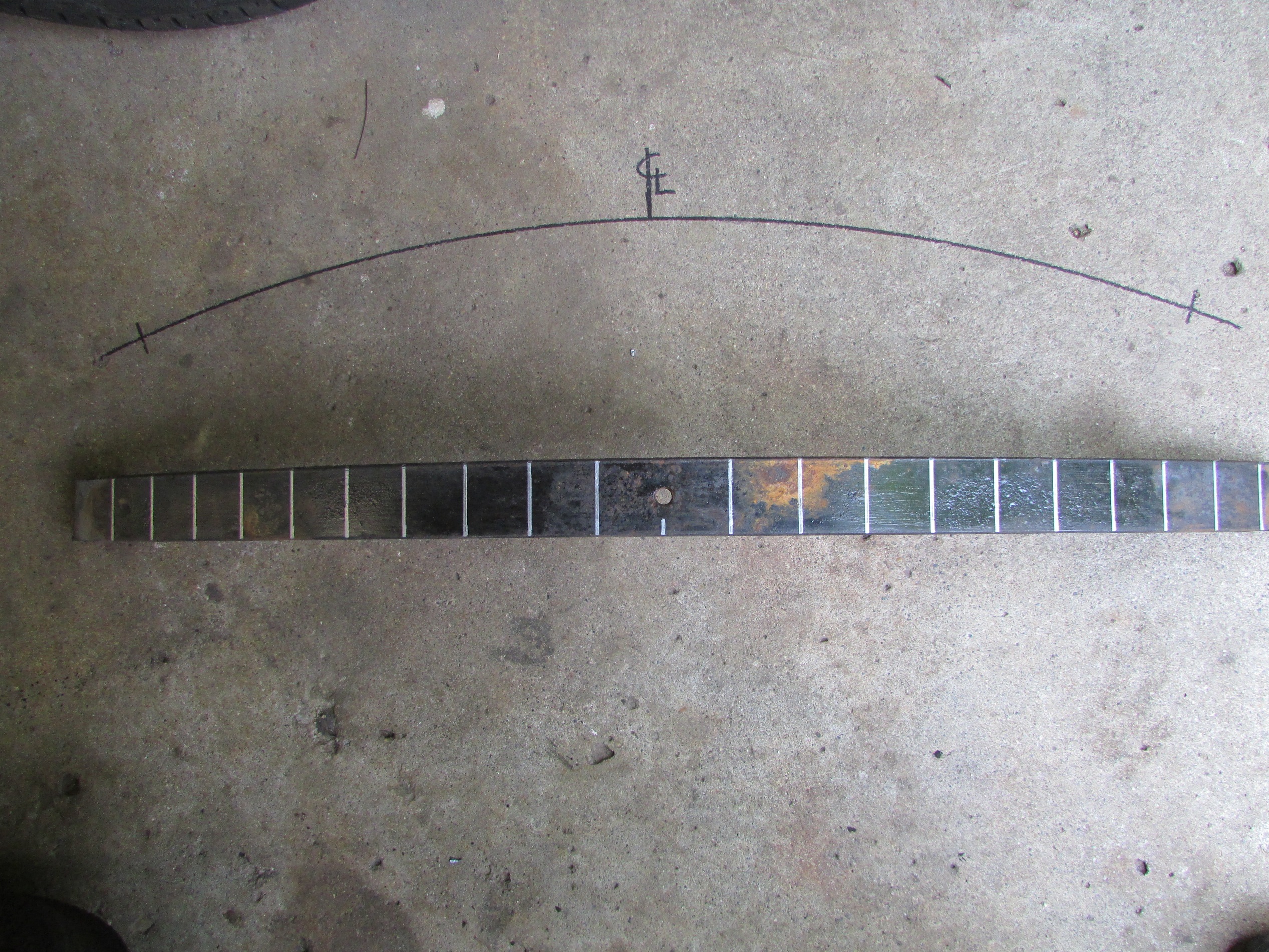

    So, I managed to get a couple of hours in this afternoon. Re-arched the front spring to create the reversed eyes. I couldn't manage to get any pictures of the process, a bit hard to hold the spring, pump the handle on the press, AND take pictures! I am reducing the number of springs in the pack to 6, down from 10. Going to sand down the edges of the ends of the leaves so they will ride against each other smoothly. I assembled the pack to work out the new holes in the spring clamps, and the length of the through bolt.

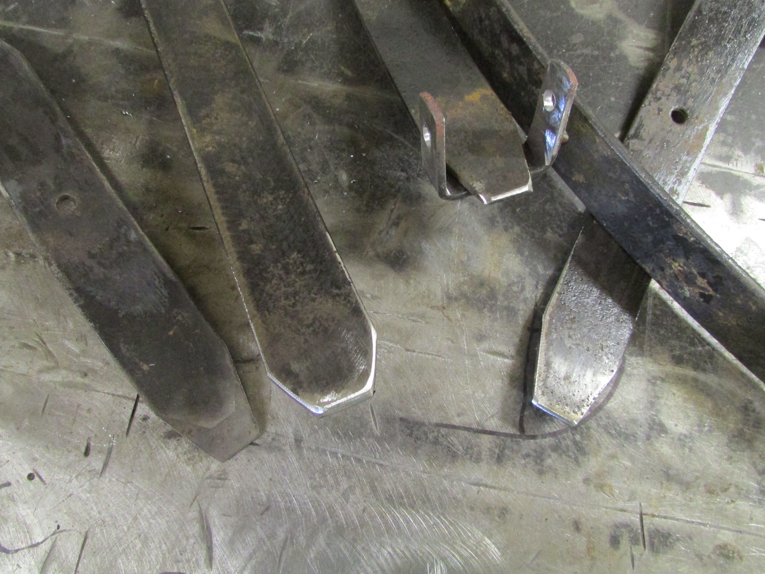

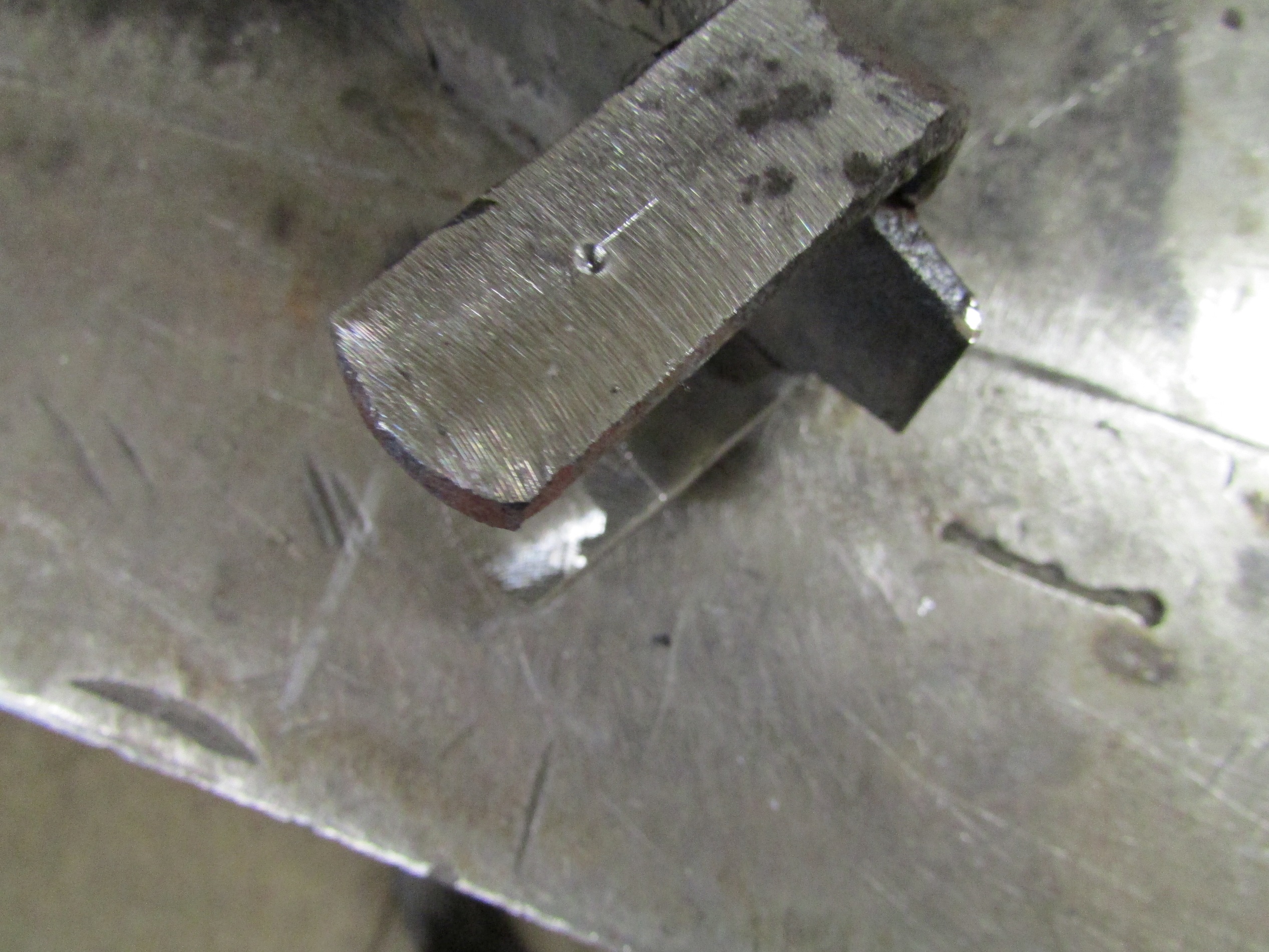

    So, with the main leaf re-arched effectively reversing the eyes, it was on to reassembly. Before the spring pack could go back together a couple more steps need to be taken.
    As I am removing some leaves from the pack, the spring clamps need to be modified. You can cut, shorten, and then re-weld, but I decided to just weld up the original hole, and then drill a new one.
    With that done, the ends of the leaves needed smoothing out. Basically you are removing any sharp edges which have a tendency to dig into the leaf below. doing this makes it easier for the leaves to move against each other, and smooth out the ride. I also tend to remove any sharp edges on anything I make, just so it holds paint better, as paint tends to pull back from a sharp edge living it thinner. So a quick swipe over with the sander took off the sharp edges on the tops of the ends of the leaves.
    I cleaned up the shackles, and made sure the grease zerts allowed grease through. Everything got re-greased and reassembled. I put in a new socket head bolt to hold the leaves together, clamped the leaves together, and installed it back on the car.
    For a total of 5 hours work and $1.59 for a new bolt, the front end is now lowered 2 1/8". In other builds for other people I would have just bought a new main leaf with reversed eyes as it would be cheaper than the time to re-arch the spring. With this build though, I am on a very strict budget, so if I can modify rather than spend, then that's the way to go. In the process, it feels like I am doing what some young guy would have done in the late '30s when he had very little money and Speed Shops were a thing of the future.

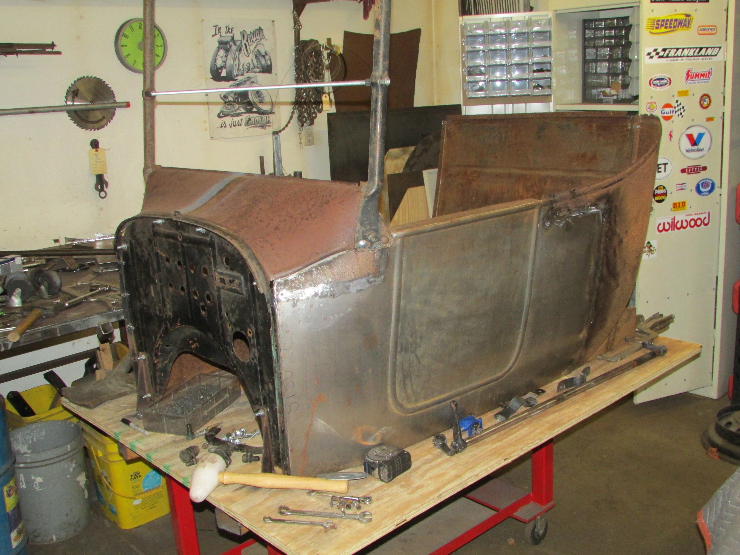

    Sort of forgot about the work I had started on the body.
    The body panels I bought were rough, I knew what I was buying and the price reflected it. They were cheap! Early Ts have no steel inner structure, it was all wood. I have just the sheet metal, no wood. So the body just flops around. So where to start? I bought a 5' x 4' sheet of plywood and screwed it to a cart. I then marked the centre-line and a grid out on the board. I started with the firewall because it is the thickest and so has the most structural integrity. I modified the stock brackets and screwed it to the board. Then the cowl top was bolted to the firewall. The left hand body side was for a low cowl, and was not in the best of shape with some creases and rust through. I came across an unused Howells touring side panel. It was a low cowl as well, but again it was cheap! The firewall and cowl top are high cowl. So I used the Howells piece patched into the original side and added some metal to the cowl side to mate up with the cowl top. I screwed it to the board. I then used the front of the rear door opening left from the touring part to repair the drivers door opening. The right side rear corner piece was full of mud and dents, so I used a torch to remove the mud, and straightened out the creases.
    That's where I am at with it at the moment. The right rear corner is ready to be welded to the door surrounding and screwed to the board. This will have to wait for awhile until I am recovered. Some pictures to go with the ramblings.
