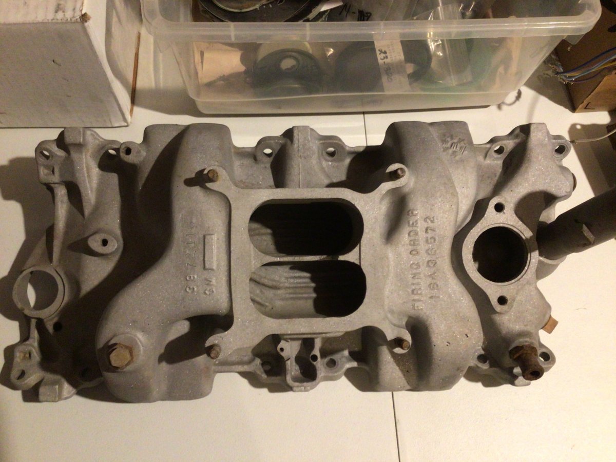

    Came with 2 shields and a handful of rivets. Date on the bottom is 8/4/1969. It’s 4 months younger than me...
    Squirrel, I agree with you - it will look right.
    Deuces, 1Nimrod and Ron Funkhouser like this.

    Here’s the picture:
    09FF86A6-5D5F-4909-8E9F-686E2D696A56.jpeg 09FF86A6-5D5F-4909-8E9F-686E2D696A56.jpeg

    It was already said, but I'll say it again. And HEI distributor will not fit with a Winters manifold because of a rear intake runner.. You will have to use a points type distributor, and convert it to Pertronics or some such.

    I happen to have an old 1850 to rebuild that came with the parts I got with the 210. I guess that should be carb for this intake then?
    Are those hard to rebuild? I got the rebuild kit in the parts box as well.
    I’ll try the search...
    1Nimrod and Deuces like this.

    Very easy carb to rebuild... I did one with the center pivot fuel bowls and a secondary metering block without the idle mixture screws... The carb ran like a champ on a "stock" HO Ford 5.0L 302.... I still have it...

    No need to converter it, it will work with points in it....
