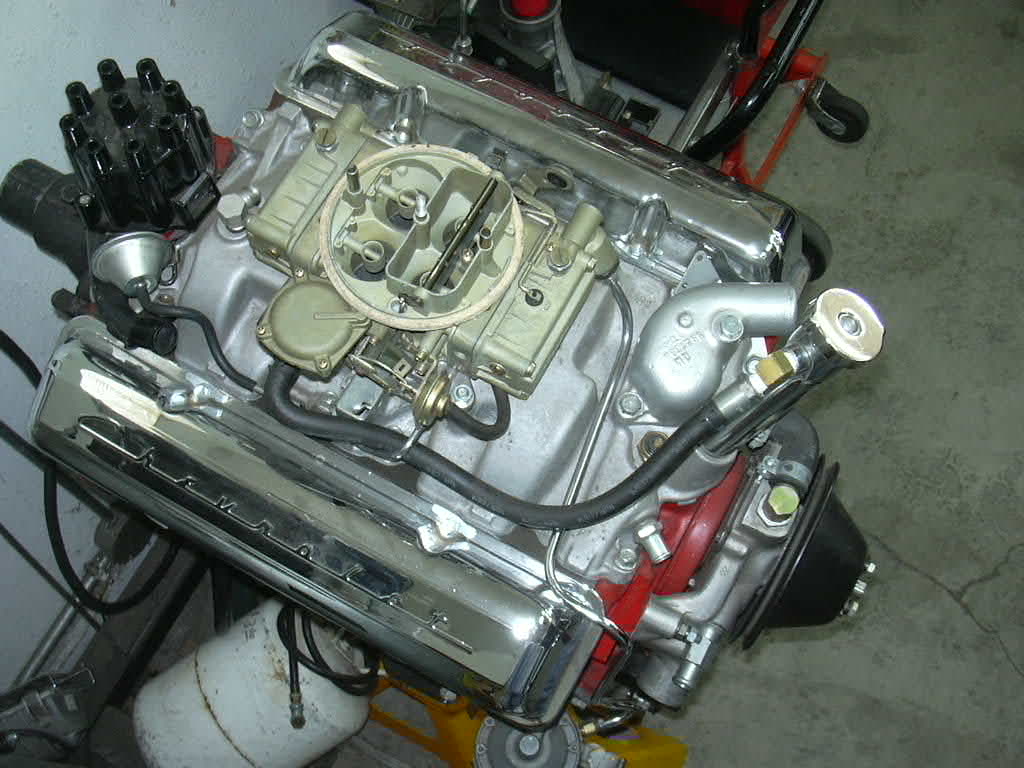

  12. ROADSTER1927
    Joined: Feb 14, 2009
    Posts: 3,232
    ROADSTER1927
    This one has run on a lot of my small blocks and works great! thumbnail (35).jpg thumbnail (36).jpg thumbnail (36).jpg
    sidewayzz69, 1Nimrod and Deuces like this.

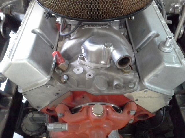

  22. 1Nimrod
    Joined: Dec 11, 2018
    Posts: 615
    1Nimrod
    What's up with the GM "CASTING NUMBERS" on the back of this Intake Manifold ??
    The first two Number's the (38 or 39) are cast looking, the way they should look when the aluminum Intake Manifold was first cast year's ago.
    The next six Number's 72116 however (to me) "LOOK STAMPED" into the Intake Manifold ??
    (Unless the picture is tricking my Old Eye's somehow ??)
    If you look closely you can see what looks like (to me) little grinding wheel marks were the last six "Cast GM Number's Were" It now (to me) looks as if someone changed the last six "CASTING NUMBERS" and "Stamped The Number's back onto the Intake Manifold" ??
    Please tell me, are my eyes playing tricks on me, or am I getting old and blind ??
    ☆Question-
    Did all the SBC V8 aluminum GM Winter's Intake Manifolds-
    (*Like ALL the SBC V8 Cast Iron GM Factory Intake Manifolds had Number's 1-8 Cast on their Runners*)
    -have "Casting Number's 1-8 on each Runner" To show Us the correct Number for that Spark Plug or Cylinder on each of the Intake Manifolds ??
    That's a Great Looking Intake Manifold, But is it a real GM FACTORY Intake Manifold or ??
    Something seems off (to me) about this Intake Manifold?
    Please School me on what is or isn't right on this Intake Manifold, so I can learn what to look for to make sure it's not an imposter, and to point out how to correctly identify GM WINTER'S Intake Manifolds.
    Thank y'all very much for your help...
    Dustin
  23. banjorear
    Joined: Jul 30, 2004
    Posts: 4,687
    banjorear
    Correct. A fair number of early Holley SBC intakes were cast by Winters for them.
  24. squirrel
    Joined: Sep 23, 2004
    Posts: 58,078
    squirrel
    could be that the changes were made to the core that was used to make the mold.
    That started some time in the late 1970s, I think. Early Chevy intakes never had the cylinder numbers on the runners, only the firing order.
    Looks ok to me.
    1Nimrod likes this.
  25. The casting numbers have been ground off. Most likely someone tried to change the number to fit the car they were trying to say it was for, or it could have been a manifold left over between years. The 69 and early 70 manifolds are the same but changed casting numbers. One thing to look at is the fill tube hole. Later 70 models were cast over and you would then have to machine out the hole to add the tube. 71 intakes were revised to omit the flat area all together. This manifold has also had the common little notch cut between the plane wall to allow a little cross flow, sometimes you see old race versions where it was hogged out to make it a single plane.
    The cylinder numbers on the runners started in 1971
    outside of the ground casting number the snowflake looks right and the runner design and thermostat hole tell me is a real deal 69 or 70 manifold that is off a production engine.
    Chevy also made a run of accessory/over the counter intake manifolds. They were 69/70 style only way to tell them apart is they moved the snowflakes position and then they also cast a little bowtie right above the casting number but other wise they are the same intake. Some have the fill tube hole machined out and some dont, just depends on when the intake was made.
    sidewayzz69, Deuces and 1Nimrod like this.
