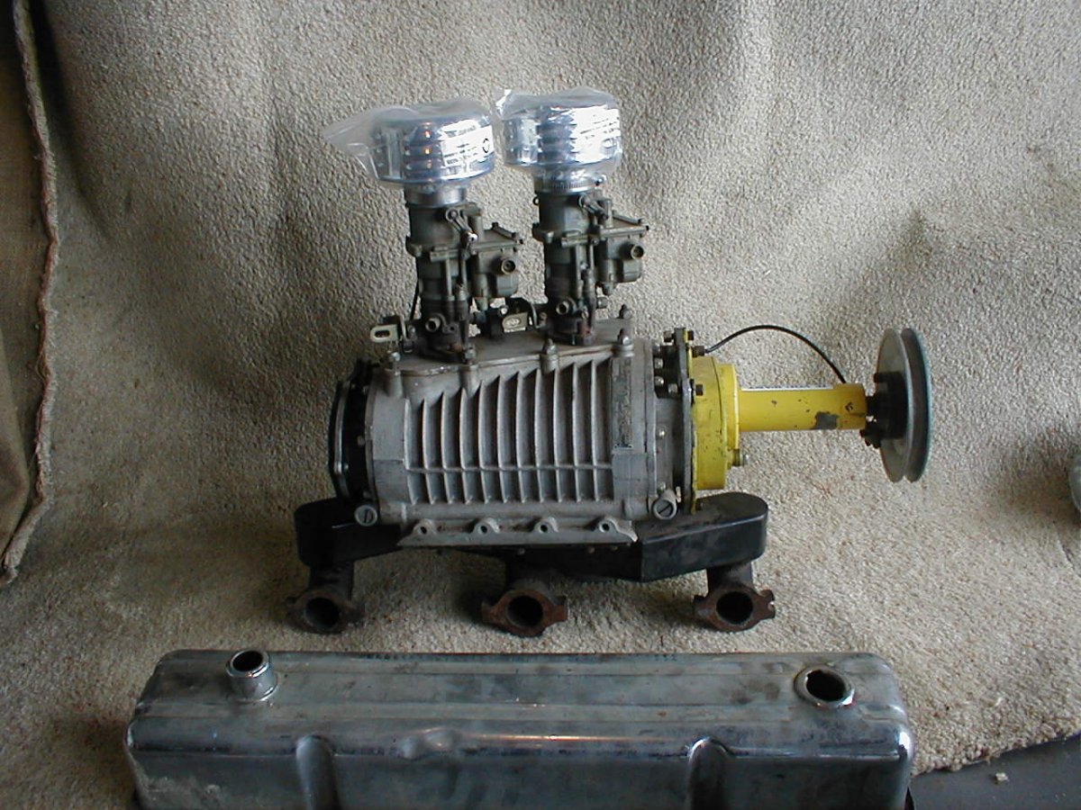

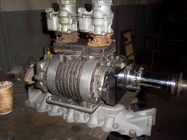

    My wade setup to suit a Chev 236.
    Period enough for me

    @Stovebolt , I am helping out a friend with a Wade blower. If yours pictures is a 34 then would you know if this unit is a 20? We are trying to get as much info as we can for this install on a stock flatty. Hard to find any tech on these old blowers.

    @vtwhead somewhere I have some files on rebuilding a RO34 blower 34 = 3400cc air per revolution.
    I would have thought a RO20 is a bit small for a flathead - unless it is a v860.

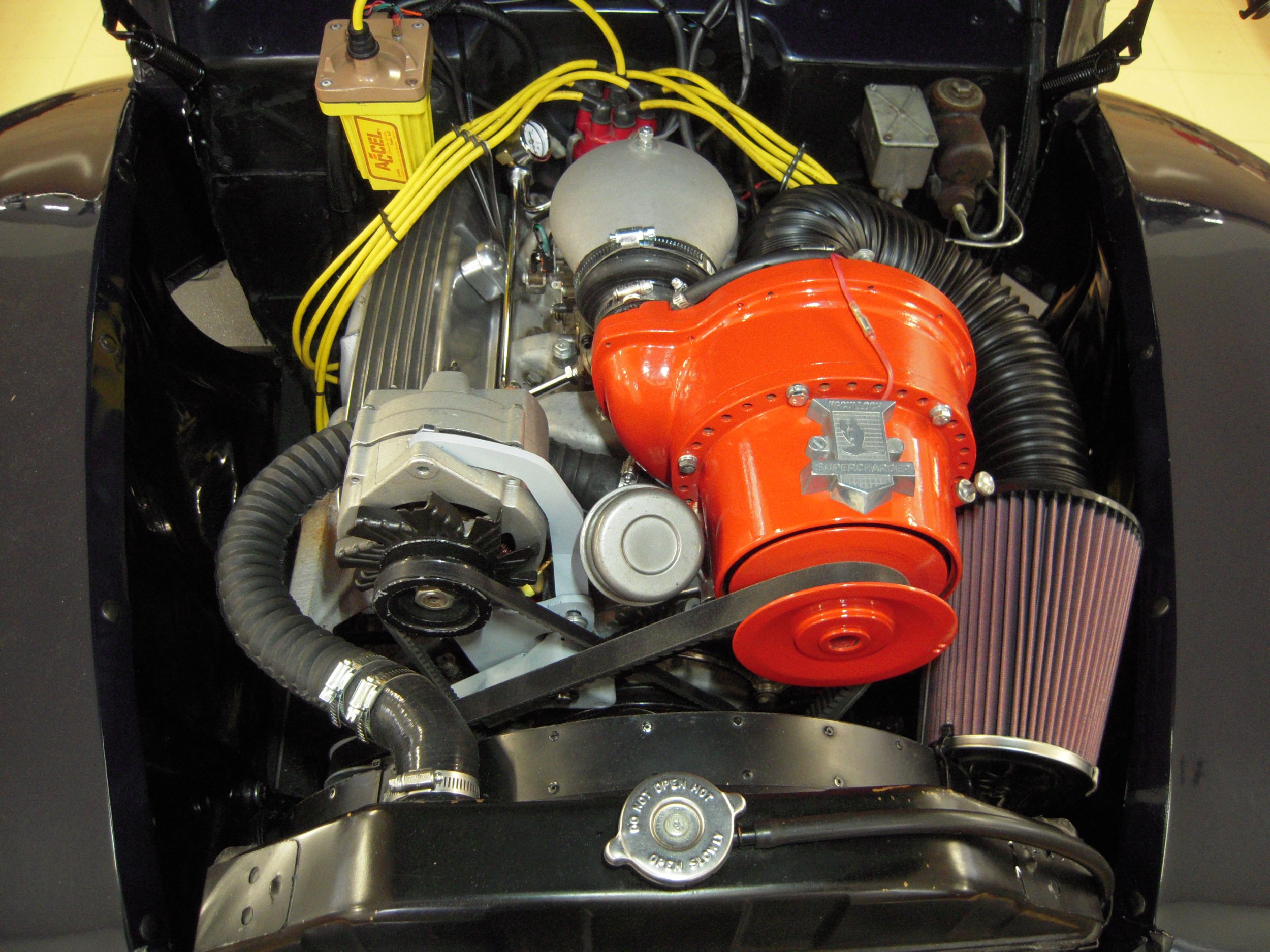

    I doubt you'd have enough room under the hood for the size pulley you'd need to spin the compressor side of a turbo to make any significant boost. The old McC and Paxtons had a ball drive planetary system that drove the impeller many times the input shaft speed.
    Craig Conley (Paradise Wheels) in San Diego owns the rights to the ball drive blowers now and can rebuild or supply parts. https://paradisewheels.biz/super-chargers
    Here is a Judson I had on a Nash Metro - I think it was a 1200cc what's that about 75 cu in. You'd need 3-4 judson.jpg of them.

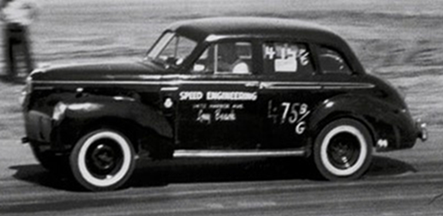

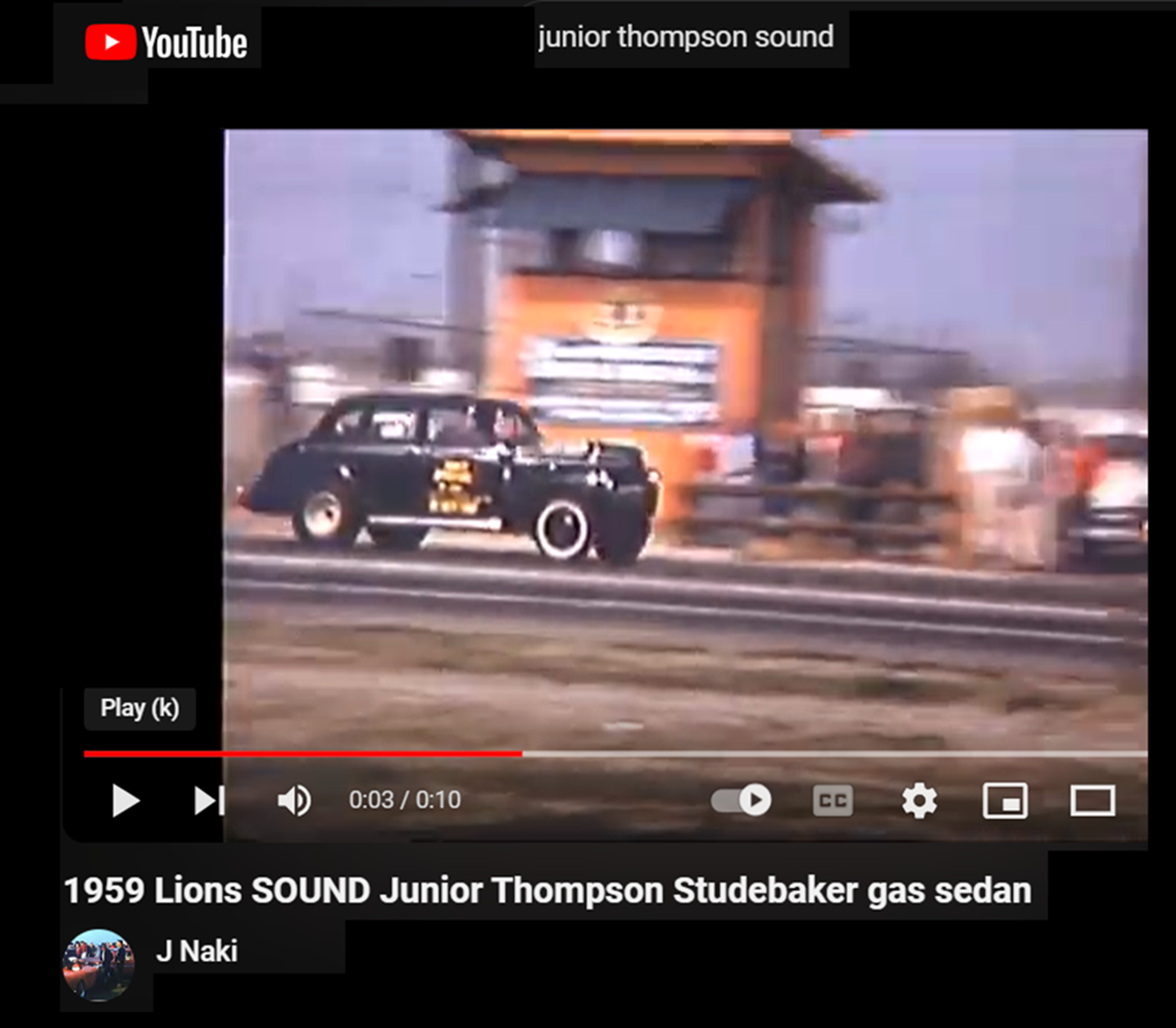

    The best example of the first powerful SBC motor with a Paxton style supercharger was the 41 Studebaker Sedan of Junior Thompson. It was put together in a small shop near our own Westside of Long Beach house by the owners of the Speed Engineering business. Tom McEwen and Ronnie LeGrand opened the shop and were well known racers from the Bixby Knolls Area.
    Note:
    Then, one day, a custom speed shop was opened, a few blocks from our last Westside of Long Beach house. It was in the industrial area near the Los Angeles River and PCH. The shop was called "Speed Engineering." Besides winning a lot of trophies at Lion’s Dragstrip for themselves, they helped build the fast 1941 Studebaker Sedan driven by Junior Thompson during this time.
    In 1959, we saw it at Lion’s Dragstrip almost weekly as they were at the Speed Engineering Shop to get some upgrades and race tune ups. The shop was in the same industrial neighborhood as Venolia Pistons, Clay Smith Cams and other speed shops in the race car world at the time.

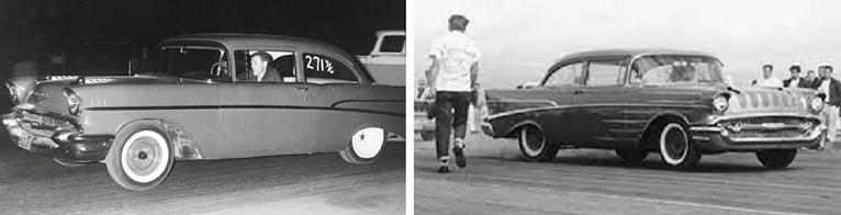

    upload_2025-6-9_4-21-46.png They even built several stock bodied Chevy sedans for the “stock” cl***es and then moved to the gas coupe and sedan cl***es with larger modified motors.
    As old time hot rod/drag race events are supplemented with tons of history and stories that have a life of their own, this was legendary. Then finally, as adverti*****ts came out with is 57 Chevy, front and center, Tom McEwen no longer could say the Chevy Sedan(s) was/were stock.
    So, the designation of D/Gas was on the 57 Chevy Sedan. Even that was questionable as what else was inside that supposedly stock 283 motor? Perhaps a Reath Automotive Stroker kit, plus a bore to make it a 352 cubic inches? Actually moving him to B/Gas status? Ha!
    Then the sponsors rolled right into the picture and the rest is noted history from Bixby Knolls. YRMV

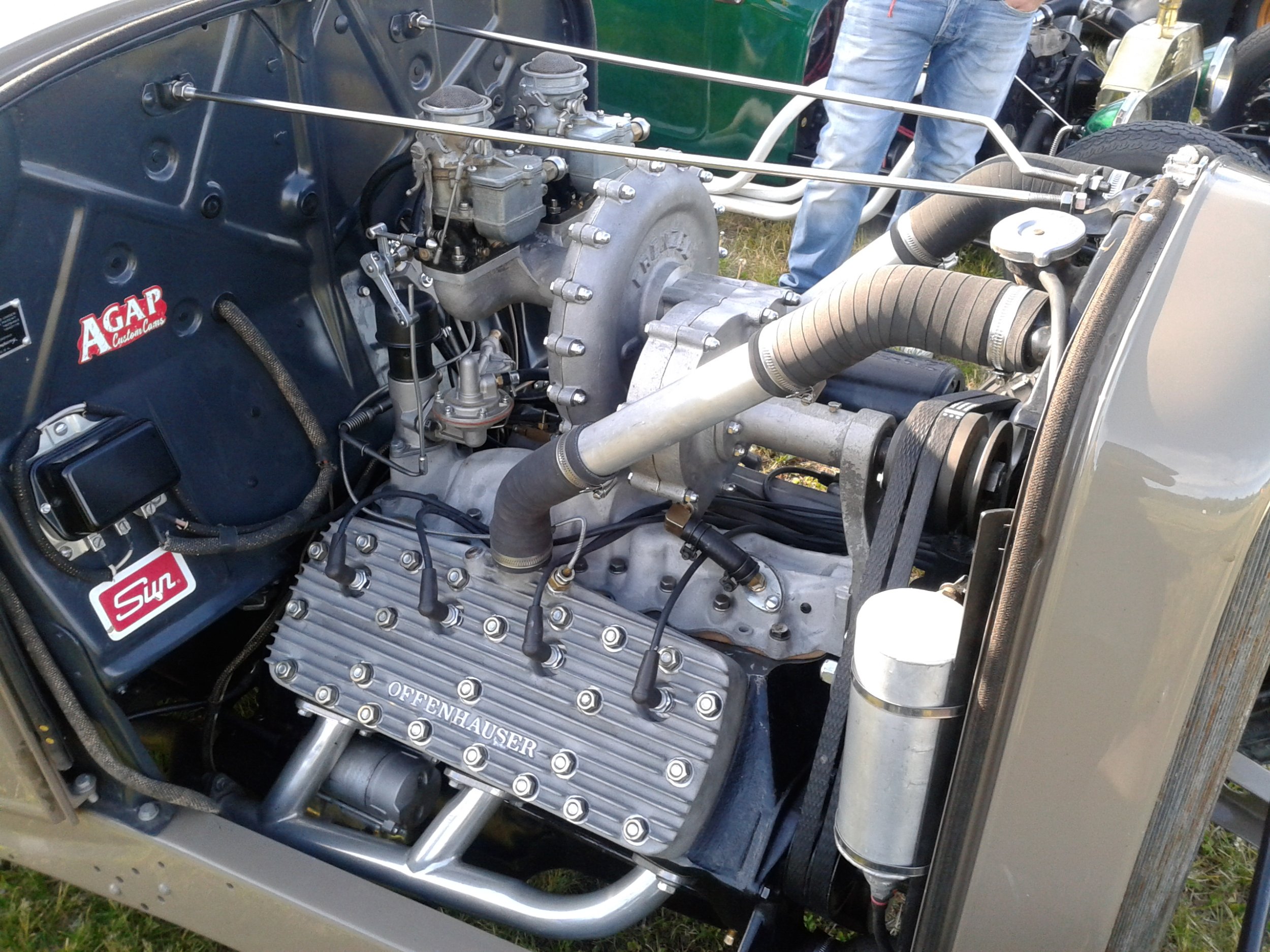

    McCulloch VS57 in my '40 Ford Convertible

    nice set up. i ***ume no hood blister required in the '40.
    any chance someone would have a photo of the mounting bracket for this style supercharger? i am not familiar with it so have a bit of trouble 'filling in the blanks."
