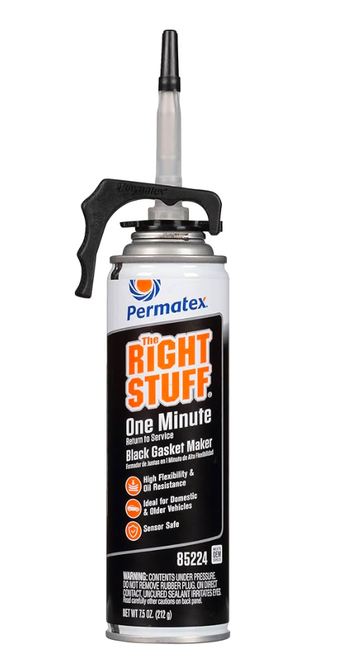

  14. You need to use …
    “ The Right Stuff “
    When I service my rear diff
    on my daily tow vehicle
    I use this product my
    primary diesel mechanic
    recommended years ago
    I pull the cover - let the fluid drain
    and then use paper towels to absorb
    the fluid the collects in the lower
    diff housing and axle tubes
    I used to spray non-chlorinated
    brake cleaner into the housing
    to clean off the ring & pinion
    but my mechanic pointed out
    that a thin film is needed after
    changing the fluid to lubricate
    the ring & pinion until the
    new oil is slung up to cover
    it after start up
    I clean the diff cover inside
    and out - then put it face
    down on a flat surface to
    make sure it hasn’t warped
    Then I clean the cover
    bolts and the diff casting
    surface - get everything ready
    and then spray a medium
    even coating on the inside
    diff cover flange and the
    diff casting surface after
    masking both with blue
    painters tape to minimize
    possible over spray
    I remove the tape & immediately
    assemble the cover to the diff
    making sure I do no over torque
    the diff bolts and squeeze out
    the gasket material
    I wait an hour or so and refill
    the diff fluid
    Jim
