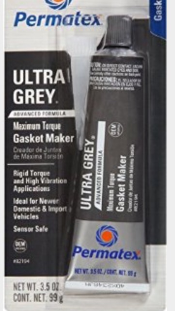

    The rigid "grey" 82194 Permeatex & it's caulking / cheese whiz tube styled counterparts is hands down one of the the best silicones introduced in years, unless your gonna remove the item being sealed a lot. It tacks up fast and is excellent as well as the other colors for end gaskets. Some guys like to make "punch like dimples in the surface for it to "bite" into ..... But not me. The gray is awesome & I usually paint my engines " gm Cortez silver with an old Bink's #7 spray gun so it blends in, for most street duty rigs I just go with the best looking color, but for top grip that grey is a bummer to remove. Silicone has to be one of the most misused products I've dealt with & sold in my 30 plus years in the machine shop/ garage/ parts business. Felpro rep friend years ago said it was s shame putting all their research & development in to a head gasket sealing surface only to see somebody ruin it with hi tack or spray paint........ Even though I've been guilty of copper coating before. But only on ****py graphite gaskets. I bet if all of the bolts came out of an oil pan that had grey on it it'd not fall off! Silicone flavors are like soda pop, whatever floats your boat .....blue, red, black, copper, clear, etc. I remember when the colors started appearing. Good luck sir. Flux.
    image.jpg Old package
    image.jpg New package

    I like the ultra grey sealer a lot. I also use the brown aviation sealer too. I have also used the purple gasket maker in the can with the brush in the lid. For the ends on a SBC I would use the grey.
