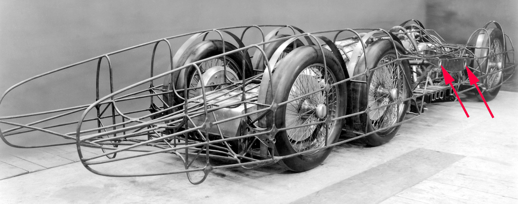

  1. Jim Hassad
    Joined: Aug 9, 2015
    Posts: 59
    Jim Hassad
    I'm sure that the wings were removed for transporting the car. If you look at the bare frame picture, you will see two stubby tubes that most likely were receivers for "spars" in the wings. They were planning on having plenty of downforce! It seems suicidal now, but just think, this is a potential 400 mph car with no rollbar or any protection whatsoever!! And they ran on a road lined with trees and the occasional overp***.

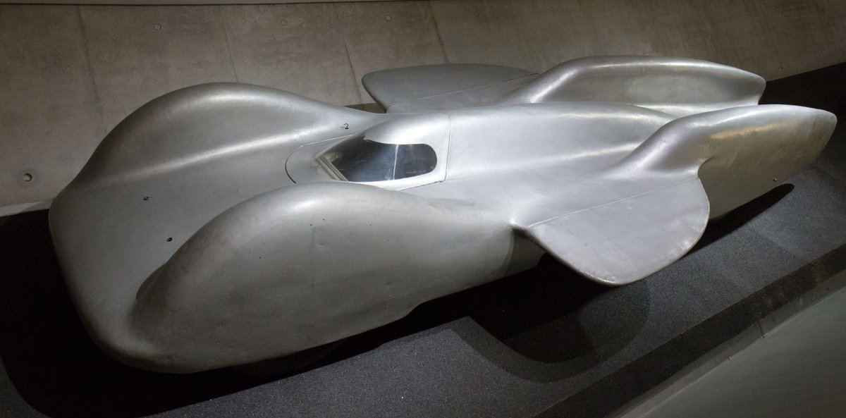

    given that the car had a coefficient of drag of .18 (which means it's equal to the drag of a flat plat 5"x5") there is no way those wings were moved. the resulting change in the airflow around the wing root would destroy the aerodynamics. wing roots and tips are the most critical to an efficient wing design. they are most likely in seperate peices so they can be removed for transport. the mount for the wing internal structure has two tubes that would receive corresponding tubes from this winglet.

    Rev this an interesting observation with the wing profile. The air going over an aircraft wing creates lift and with this shape in reverse to an aircraft positioning the force would be downward.
    They by this time were well aware of this and had wind tunnels to test I would ***ume for what would be the sweet spot for positioning of all aerodynamics.
    This land speed stuff makes all these profiles and attachments way more critical.

    I'm pretty sure they were fixed in a favorable position for the speed at which they felt they were going to achieve. It would have created downward pressure and it would have had to be very calculated (if it is truly fixed) as to much would slow it down and to little would create an unstable situation.
    But hey ya never know what was lurking in the sleek cruiser surfaces.

    Thanks for that insight and you're right. The larger/longer portion of the winglet is the bottom which reverses the lift to be more of a downward thrust.
    I'm still not seeing those pipes that were mentioned or the attachment mechanism. It sure looks like they'd come off for transportation, but I'm not seeing how they secured them to the car. The must have somehow or they'd come flying off at speed.

    The 2 holes look like tubes that the wing was likely attached by (slide in and pinned perhaps). It would have to be pretty darn strong and if tubes or bars (spars) were throughout the wing it would likely be up to the task. The video @lbcd posted shows a great shot from a low angle and you can see the profile of the wing is definitely reverse of an aircraft

    To understand why this works one first has to have a grasp of the basic principles of lift and down force. The illustration below shows a simple downforce generating wing profile.
    The air p***ing under the wing has further to travel than the air p***ing over the top surface. This causes the air under the wing to accelerate, resulting in a drop in air pressure, this creates a difference in pressure between the upper and lower surfaces. This difference essentially means the wing is pushed down by the higher pressure above, generating what is known as downforce.

    OK, yes. I see it. The pipes were in the wing and slid on to the support and pinned from inside. Genius.

    Word. Thanks for that. Make perfect sense and that one picture does show the upside down wing perfectly. Those Krauts were some pretty smart dudes.

    Yep right as rain flat on top curvy on the bottom will make downforce. I stand corrected. It's creating sink not lift, cool learned something today. PS - we're still better - Tongue out emogee!
