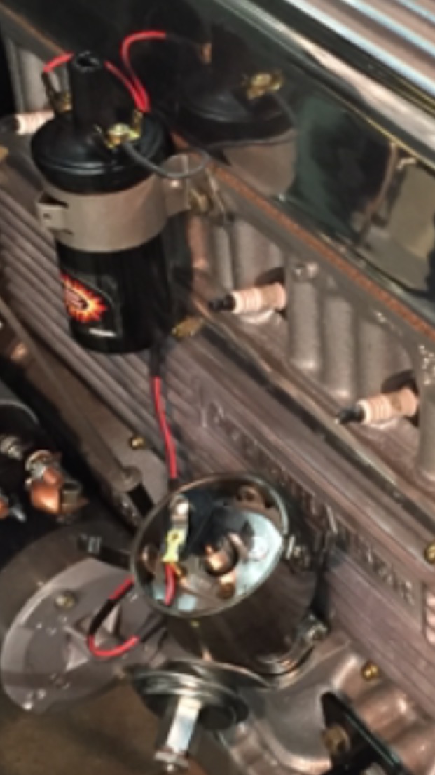

    Upgraded to a Petronix 12v neg ground ignitor along with a flamethrower 3 ohm coil in the 53 235 this week. I've installed close to a dozen plain ignitors & always get the correct low ohm coil for my own & encourage it for other customers. At work we sell roughly 20 units per year all plain ignitors & I've only had one come back in the last 10 years. I suspected on the returned unit "a 72 "302" Ford" , the gap wasn't set correctly between the unit & the magnetic trigger , I give it to another customer & it worked perfectly. Good solid product. Flux. image.jpeg image.jpeg
