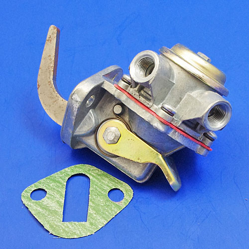

    Or, one of these:
    Mechanical pump with a primer :)
    Mike

  17. OK, that is a new one to me. What is it off of?
    Boneyard51 likes this.

    My John Deere has a fuel with a primer lever

    I think that one is off of a Triumph. With a spacer and longer bolts, English Ford sidevalve. They make them for Willys/Jeep engines (at least the 134). I think they have them for military Dodge 6's. You see them on Diesel lift pumps too. I Googled, I didn't see SBC. I can hardly imagine there is something you can't get for a SBC. I have one on my '65 Triumph Herald (1147cc OHV powerhouse). Without it, you chew a starter up if you let it sit a couple of days. I snapped one up as soon as I saw it. Mike

    Looks similar to the lift pump on my MF 65, didn’t know automobiles used them.

    Those fuel pumps were very common on agricultural engines. Those engines usually set a long time and you could use that lever to operate the pump. But the engine had to be turned right or they wouldn’t work. You don’t normally see them on modern automotive applications.
