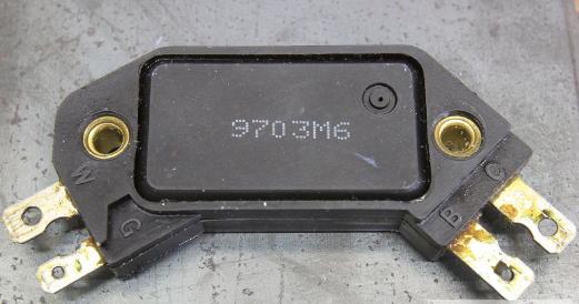

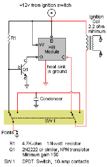

    That works OK! or you can also use a 4-pin GM HEI Module.
    But some mods are needed in the wiring to get an HEI to work correctly.
    A resistor is added between the points and "W" terminal

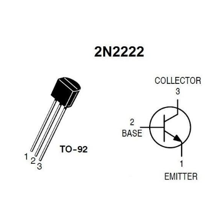

    In order for the spark to be at the right time, "G" terminal must be grounded as the points open. This requires an inverter circuit between the points and the "G" terminal. [a small transistor will do this]
    The points control the inverter circuit . This grounds out the G terminal when the points open.
    There is very little current in the inverter/points circuit so they will last forever.
    You can also add a 6 pole [DPDT] switch and keep the condenser.
    If you have a Module failure, a simple flick of the switch and you can run on Points/ condenser
    Q1 on the diagram is the inverter transistor.
    E B C = Emitter, Base, Collector

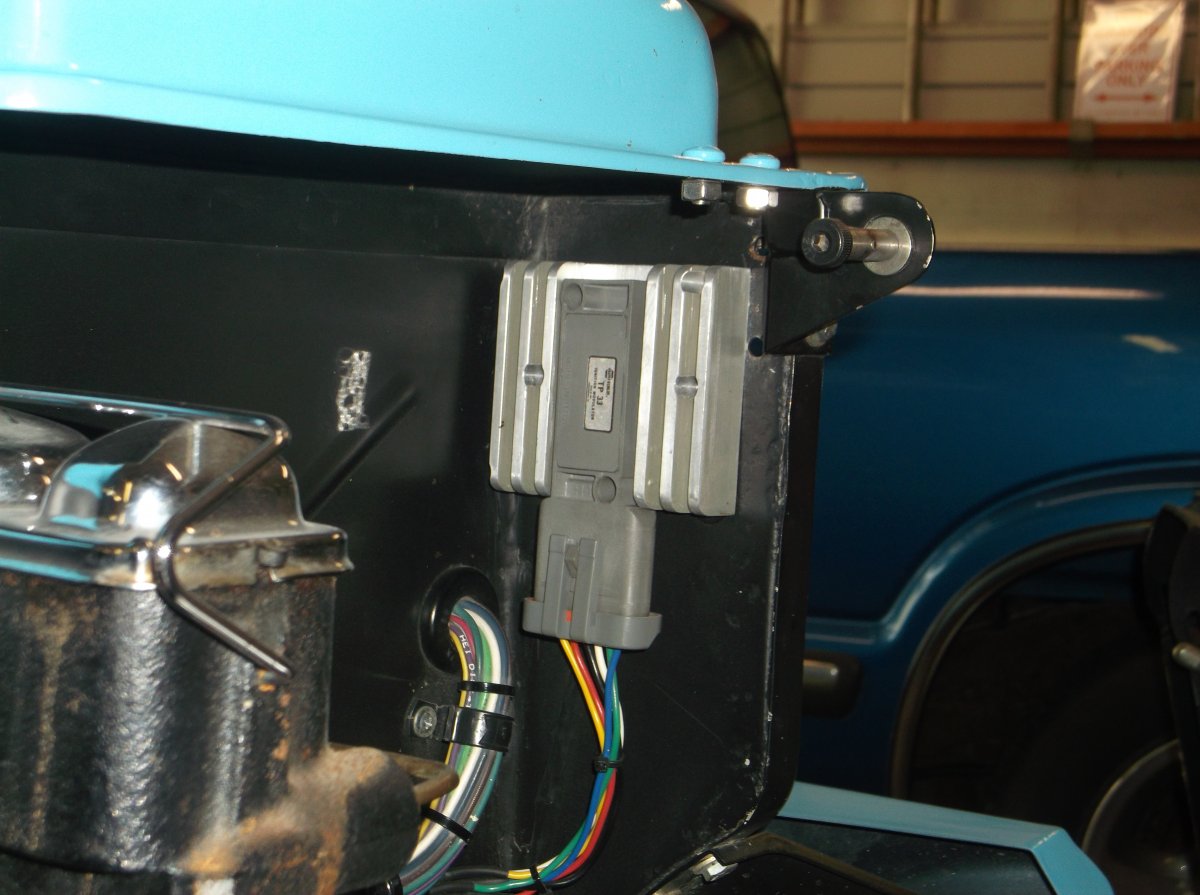

    I had an HEI module set up like this on a heat sink ready for install but never tried it. I saw the thread on the TFI and thought it would be a lot simpler to troubleshoot if it let me down. I have a spare module in my tool bag.

    The Ford TFI is a better unit
