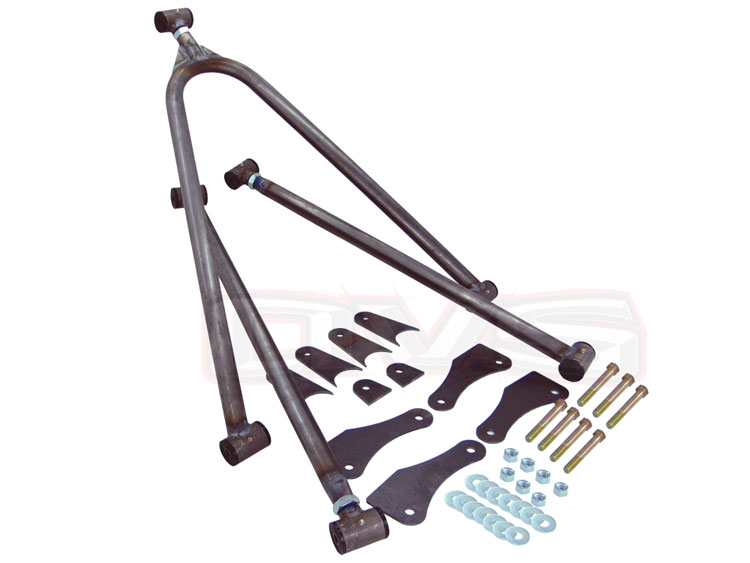

    117harv, thank you also for taking the time to post :cool:. By any chance would you have a photo of what you described above? (highlighted by me). Did any of you guys that run ladder bars with a full exhaust have any hair pulling moments with configuring exhaust? :D

    Instead of having two mounts on top you just combine them and make one. Since you are eliminating one of the points you have doubled the stress to one. A larger bushed end would be a great addition with this appl. Here is a pic of a kit offered.
    With a triangulated four bar, all bars are at aposing angles to stop side to side movement. As the wishbone angles are more severe, it alone will keep the rear centered and the lower links can be run straight with the frame rails if so desired, but abit of aposing angle wouldn't hurt.
    Another variation of the three link would be two long bars up to the trans. area and a third in the middle off of the diff. This is common with the banjo/transverse spring set-up using origonal ford rear wishbones when the torque tube is removed. This would work just as good with later diffs too.

    thanks harv, for explaining and the pic.
