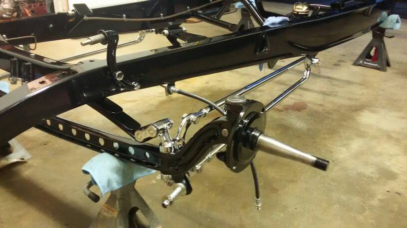

  3. Front suspension going in the ch***is and I can't paint and finish **** fast enough!

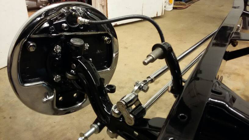

  9. Making some progress, painted the rear spring and rear drums and ***embled the front brakes, tie rod, and steering arm. Trying to decide if I should paint the shocks black or get some chrome ones.

    I'm normally not a fan of chromed backing plates as they impart a kind of "Mr. T" level of bling to a front end. But the blacked out inset with the chrome outer is a touch of subtlety that won't go unnoticed. Ditto a sparing use of chrome in other areas. A small chrome item here or a shiny bolt there doesn't overpower the eye and allows the entire car to be seen. The other extreme was the monochromatic look of the 90's. Shapes got lost in a sea of the same color. Every time I see too much chrome I just think too much money.

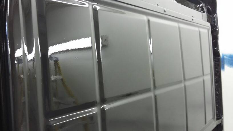

  23. Still bolting parts to the frame and doing final wet sanding on the body. It's finally cooling off a little in east TN.
    CTaulbert likes this.

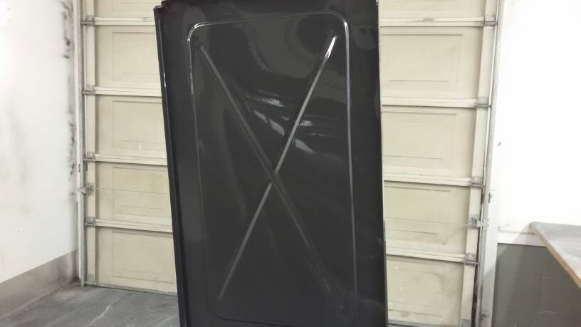

  24. Sprayed the bottom of the body and a few parts 1932 Tunis grey today. I am sure glad I don't have to sand the bottom of the floor anymore! Moving forward...

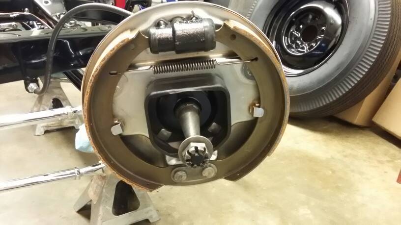

    I was trying to figure out how to quote the picture of the front brake ***embly that accompanied this post but couldn't...
    Your front brake shoes are installed backwards. On the '39-'48 Ford brakes the long lining goes on the front and the shorter lining goes on the rear. You need to switch them around.
  30. Thanks Dennis,
    I will switch them. Good eye,
