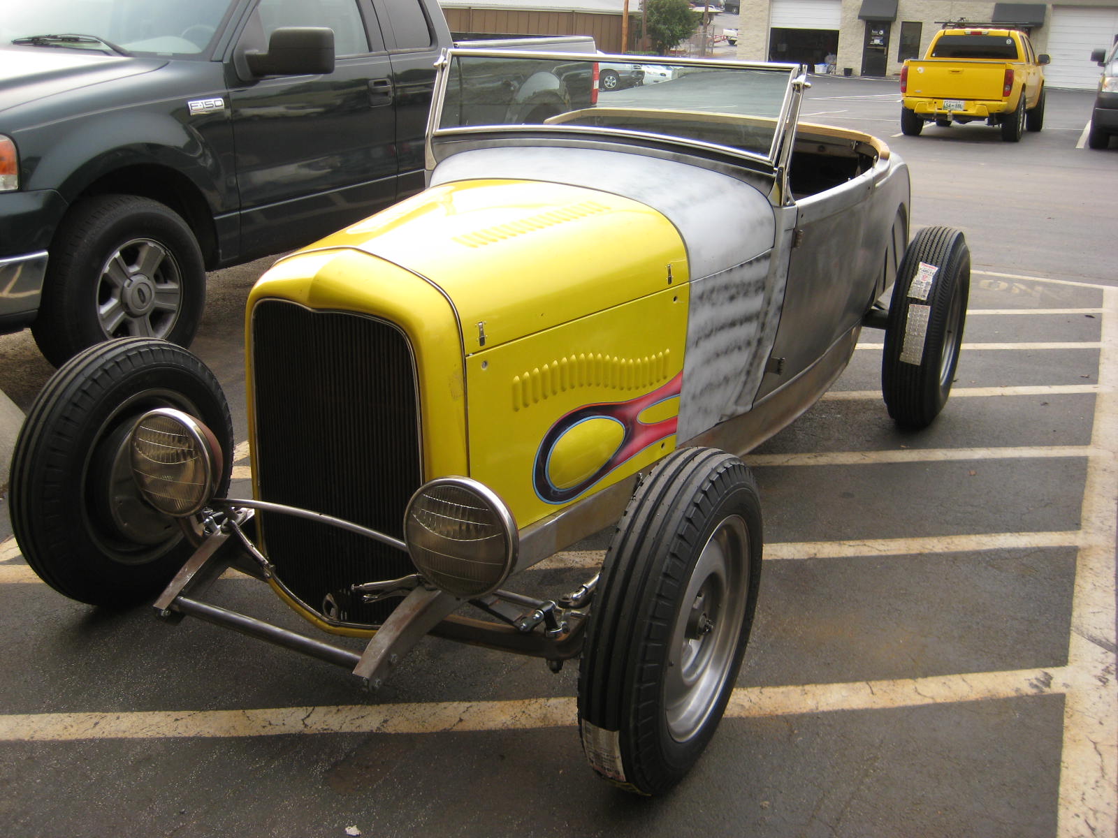

  4. Well, I finally brought the Pwood car to the shop so I can get serious on the fab work. The ch***is needs a few things done to it and I need to mount an engine & trans. I also figured out that all of the hood and side mounting tabs can be made by the clear impression on that wore the inside of the aluminum. I am going to put round backs and 40' ford brakes back on the car. My plan is to put the car back as close as I can to the original build and I have decided that I will put a SBC, Lakewood ****tershield, and a Muncie in the car as it was. Anyone that knows me, knows I am a ******** Ford guy but history is history. When I talked to Pete he said his plan was for the car to be painted Black so that makes color choice easy. Time to move forward.

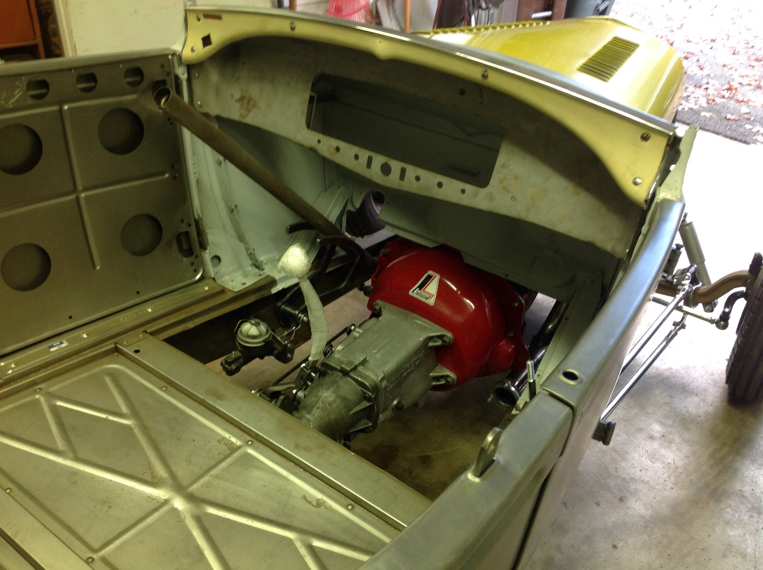

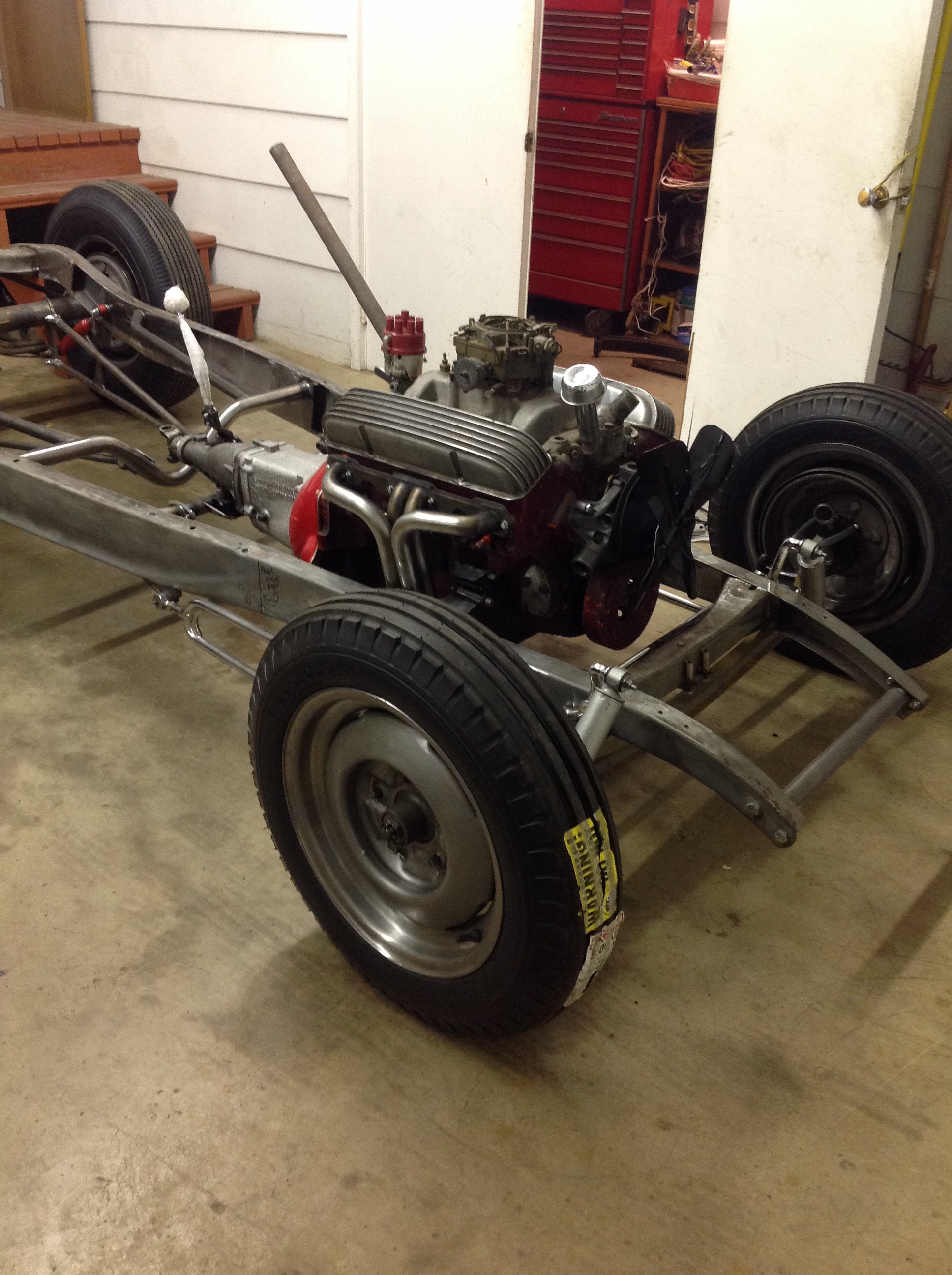

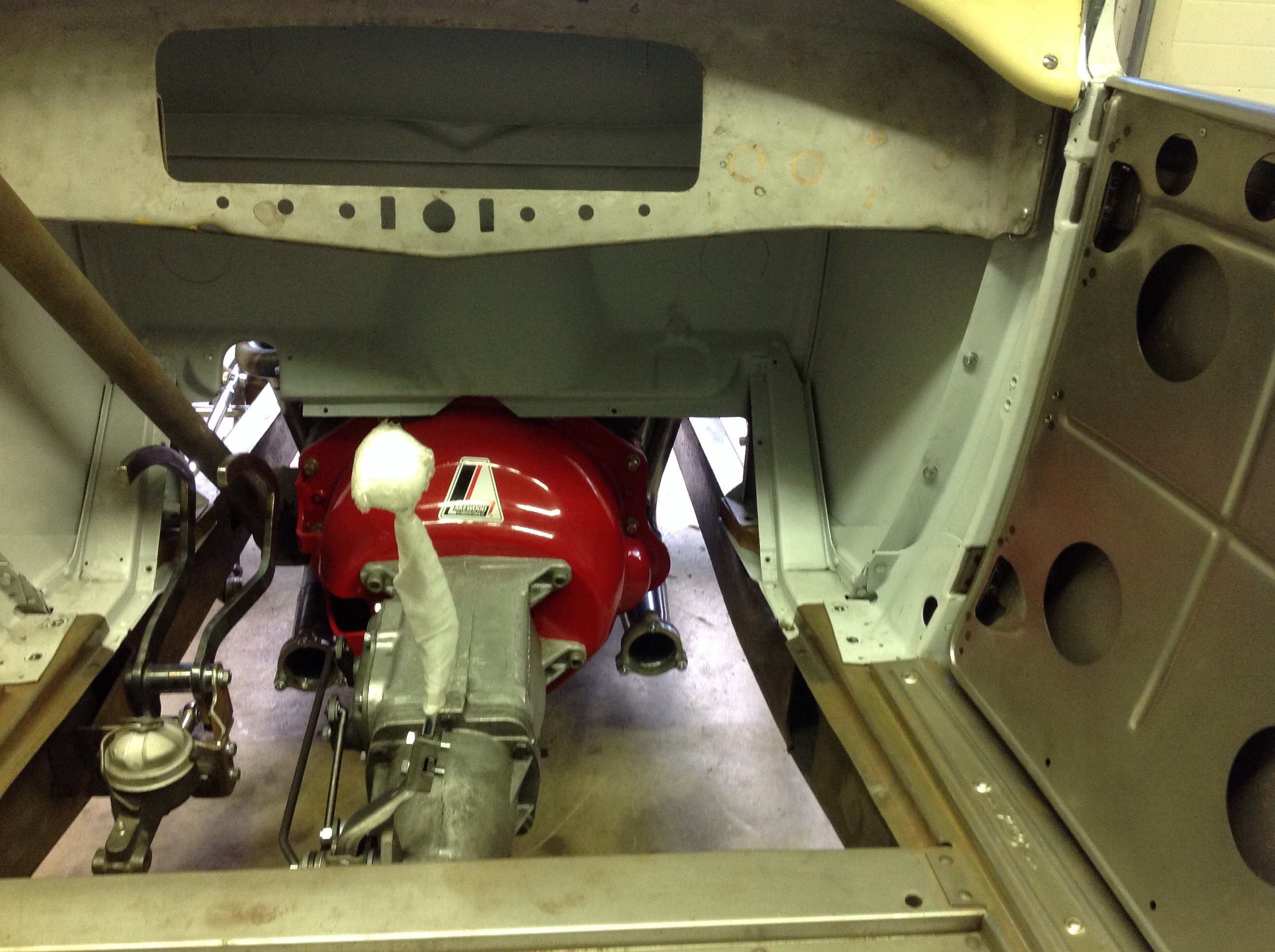

  13. Engine and trans mock up under way

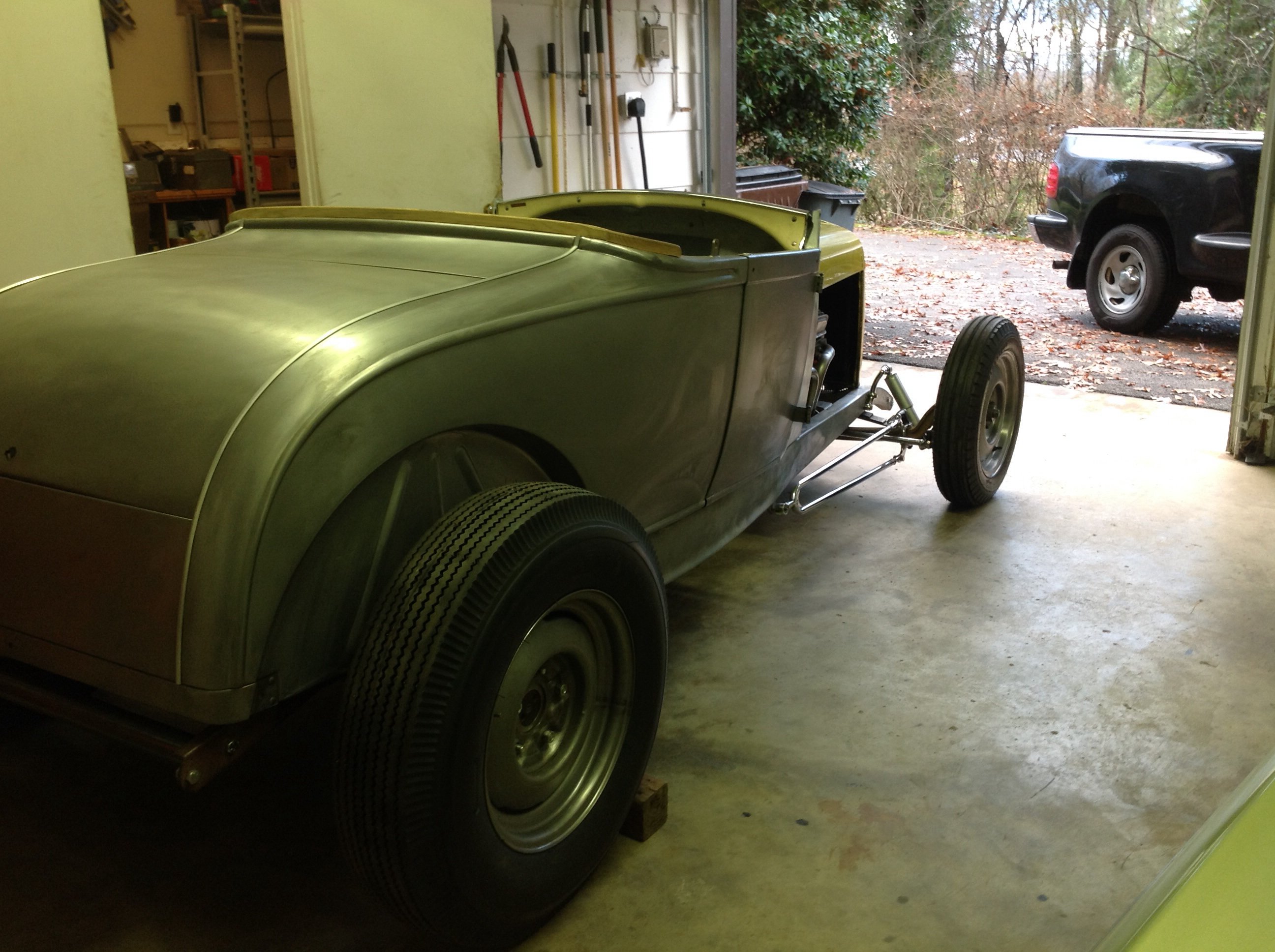

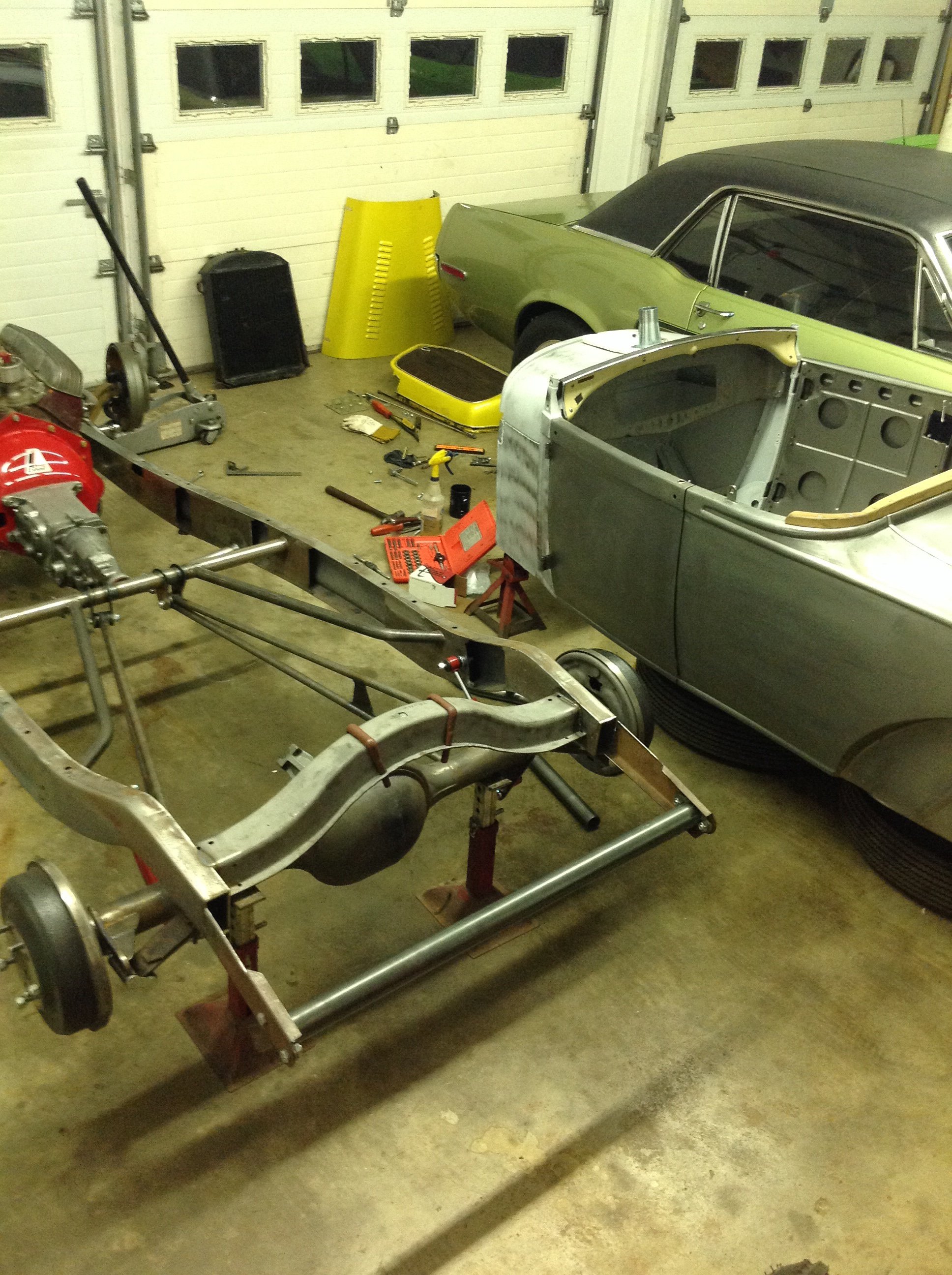

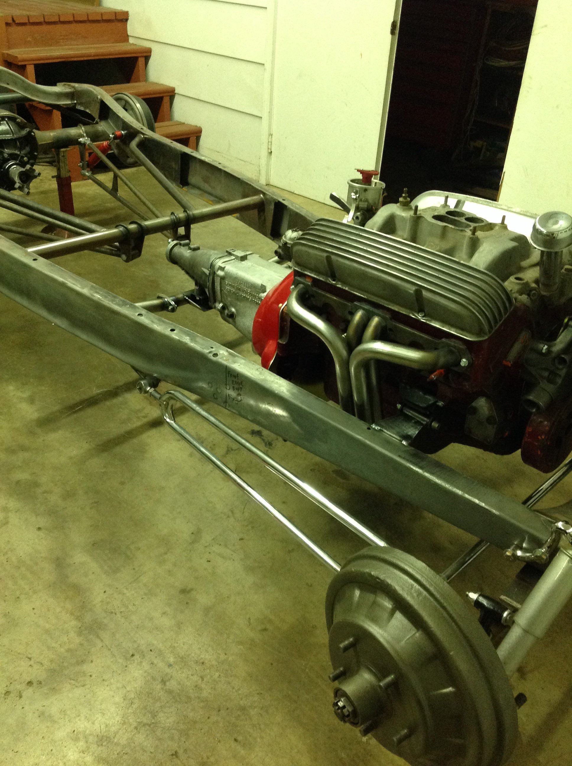

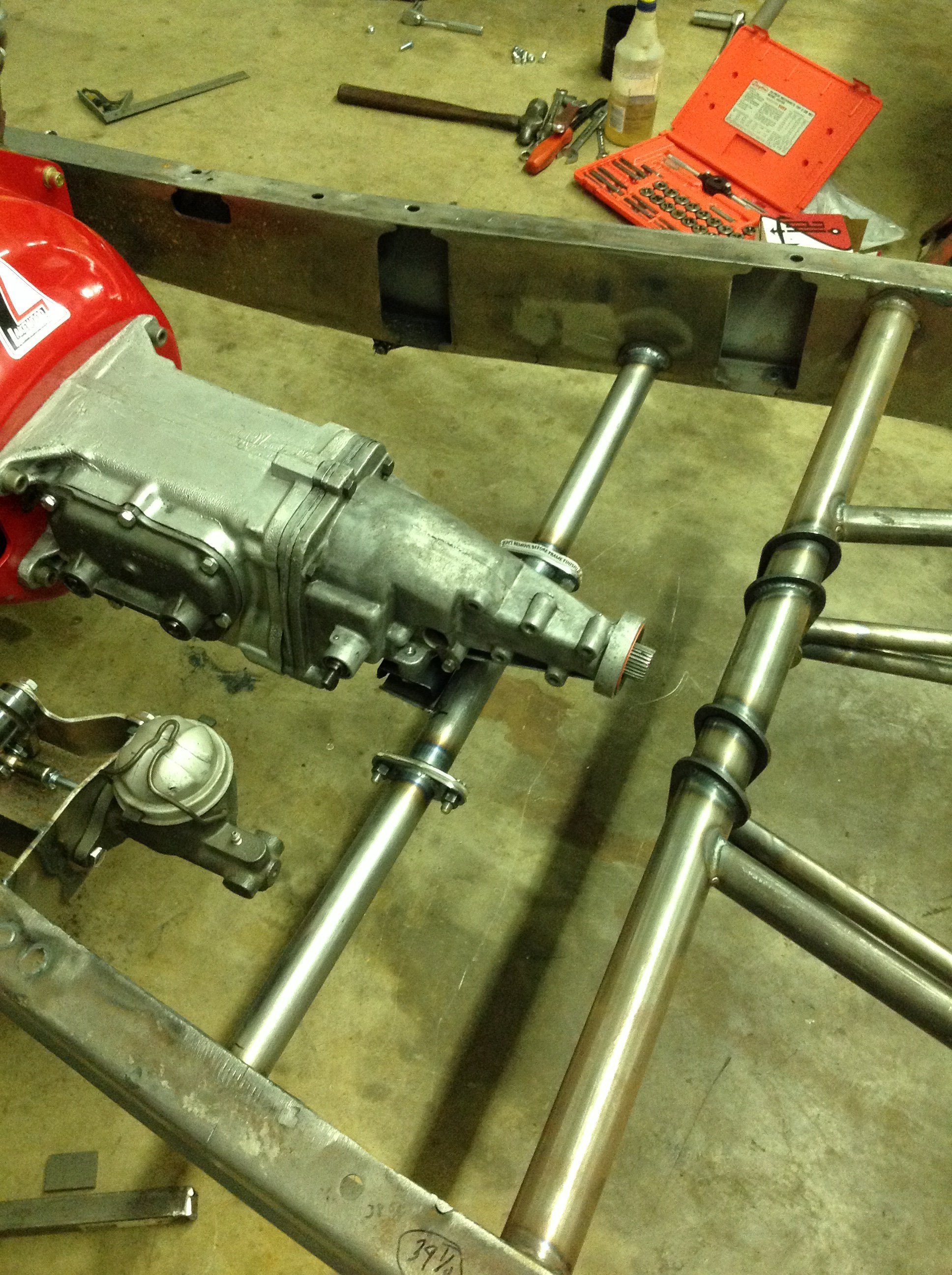

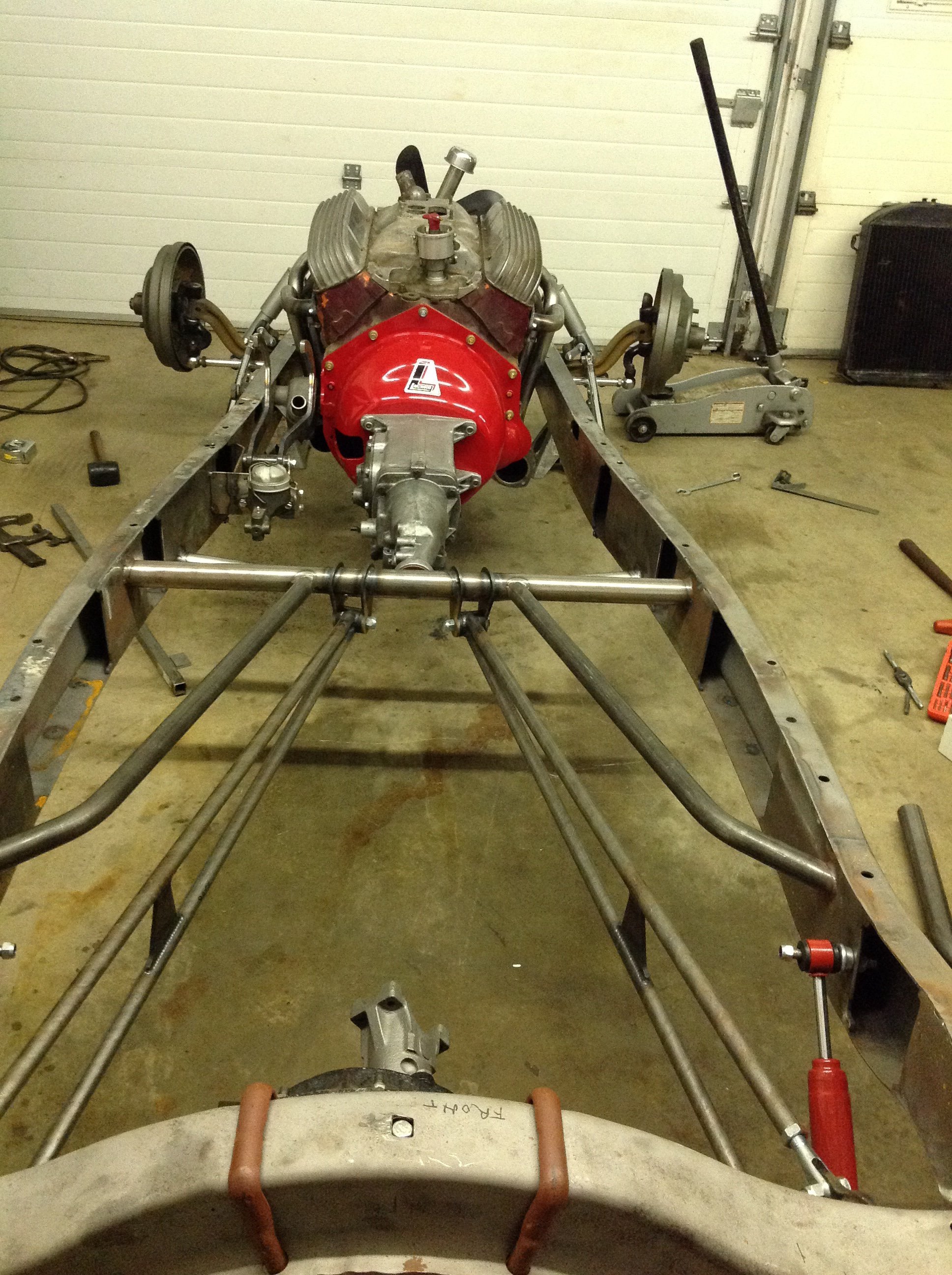

  16. Had to bring the roadster home from the shop Saturday because the shop is full of paying work. Worked Saturday night and all day today and got some work done. Mounted the engine and pulled the body so I could finish the trans crossmember and do some ch***is work. I may do a Pete & Jakes drop down style crossmember for the ladder bars for some extra driveshaft and exhaust room. Need to order some parts and keep the ball rolling.

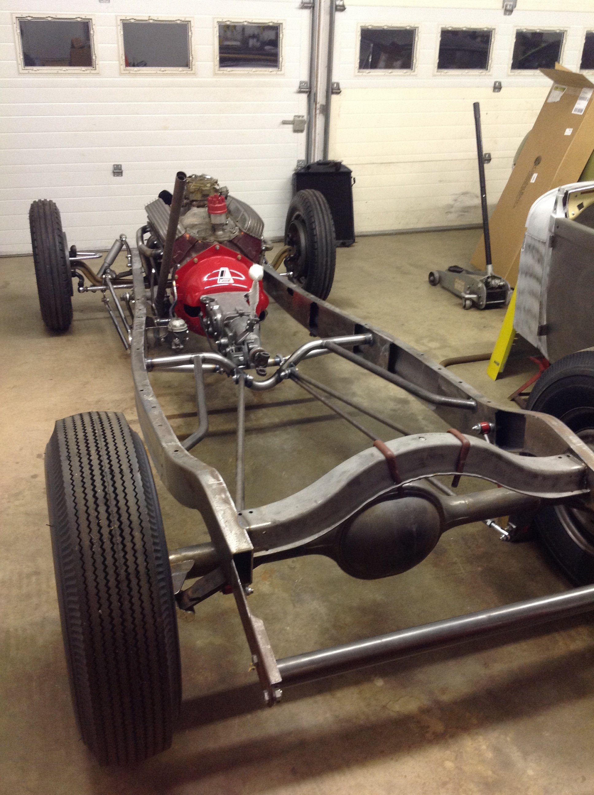

  18. Decided to use a Pete & Jakes drop down center crossmember due get some driveshaft room. Ordered all the material to start the exhaust system so I am trying to get the ch***is finished up. Ran out of argon for the TIG so I'm done for the night.

    It took a while for me to get my oxygen replenished also. Man you are moving right along and I like the dropped down cross member as that is what is on my car and you will have more room for exhaust and etc. After I had my car a year or so I changed the single resivor master cylinder to a dual. If you decide to do that Pete&Jakes has everything you need. Everything looks good......................

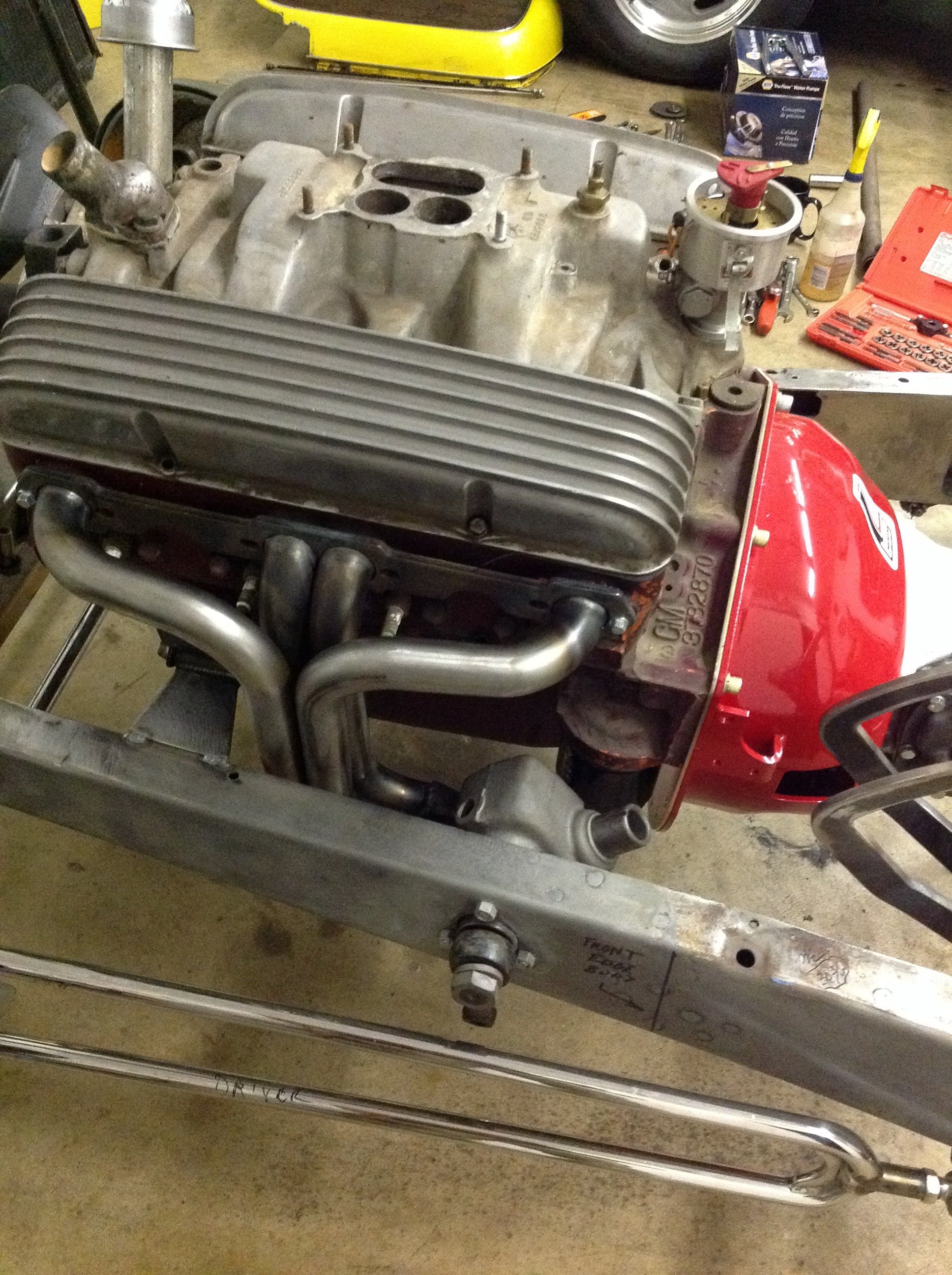

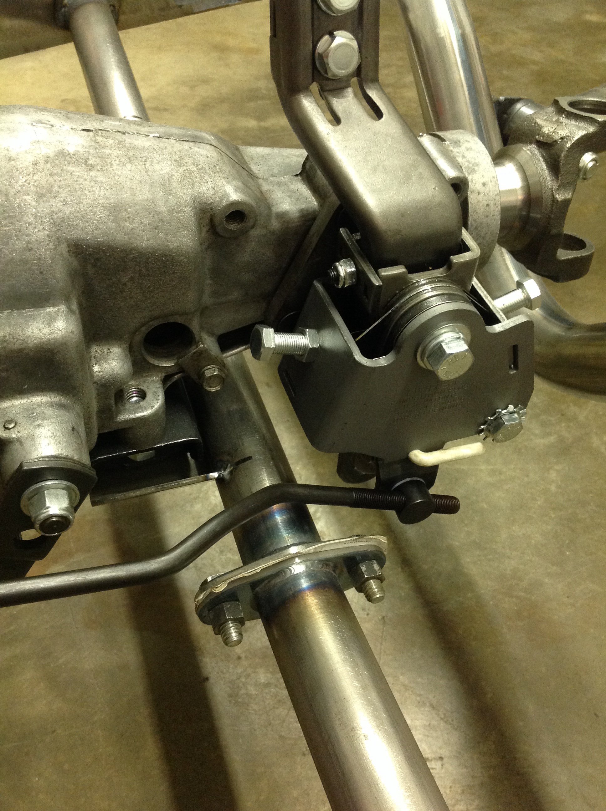

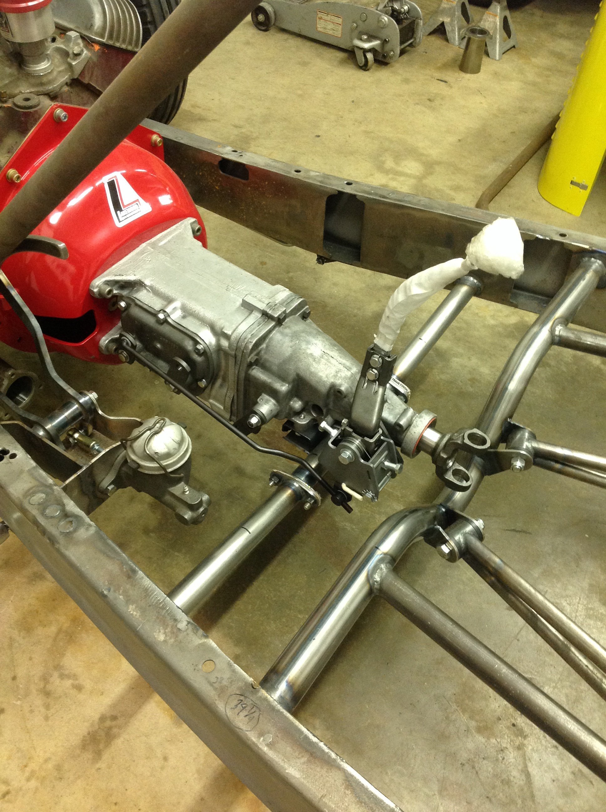

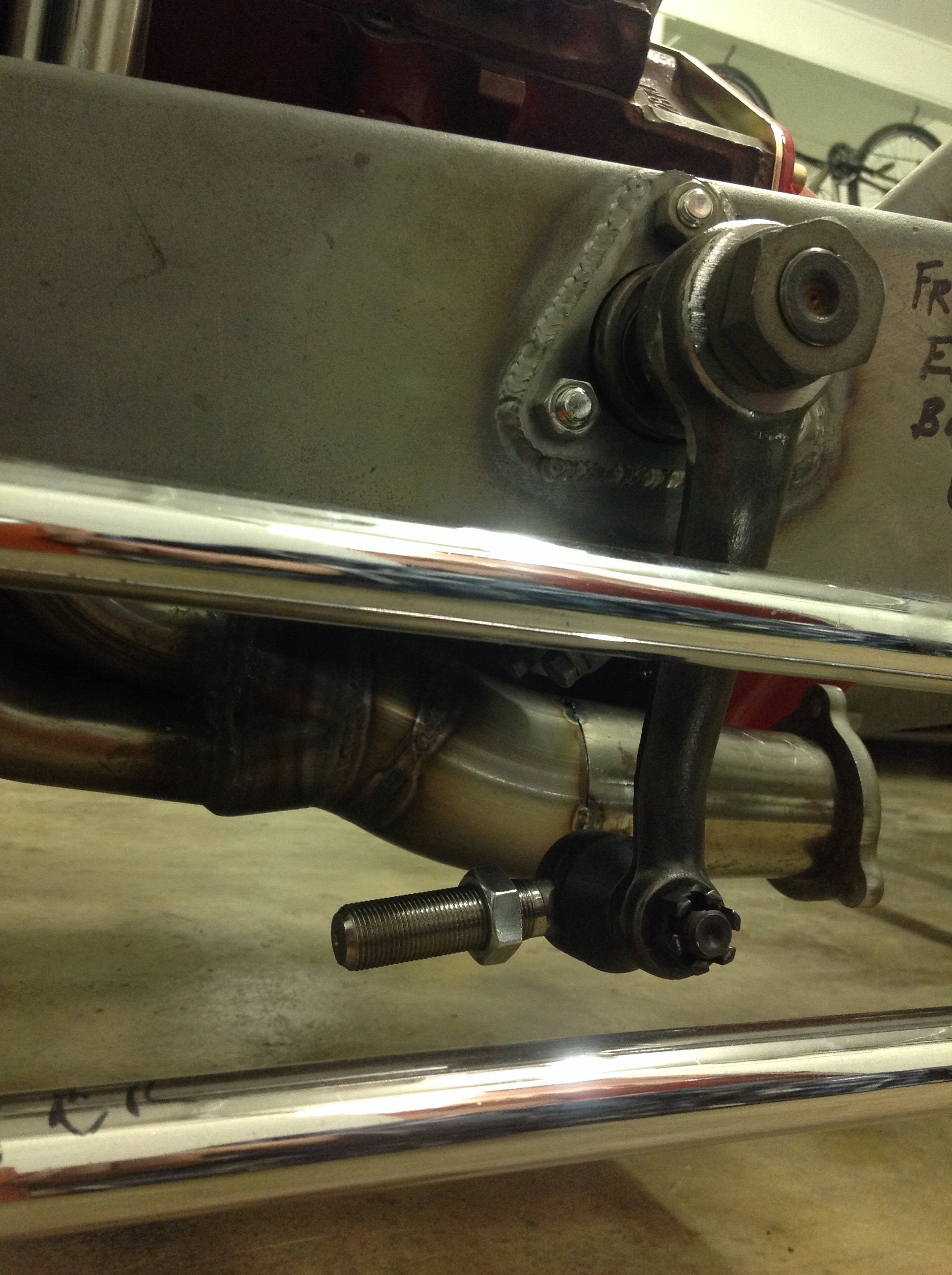

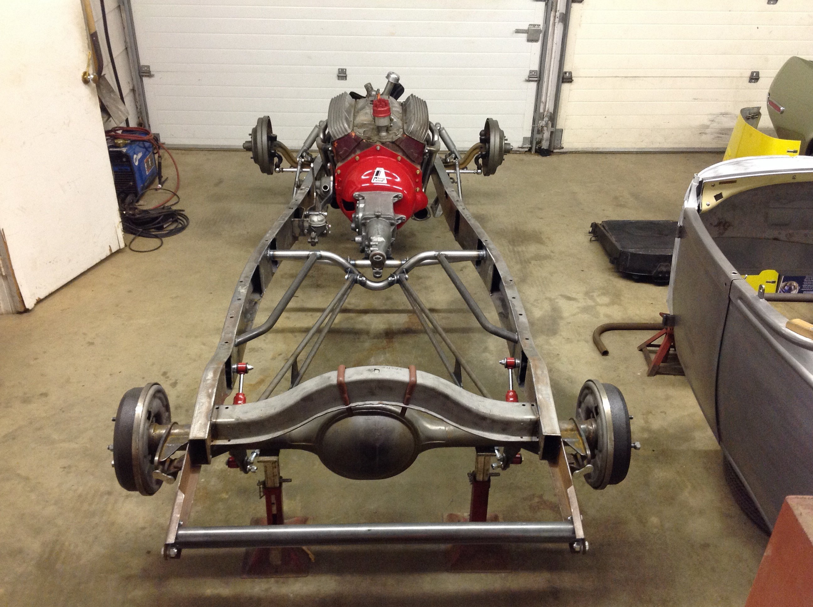

  26. I got most of the crossmember work done on the ch***is and decided I should order the Hurst Shifter and mock up for exhaust before I finish the tubes that go down to grab the transmission crossmember. Shifter came in today so I thought I would take 30 minutes and bolt it on. Had no idea the shifter was mounted so low on the plate and the 1-2 and reverse linkage rods are all over my trans crossmember. So now I have to get that figured out so I can start to mock up exhaust. Also had to modify the header to clear the bottom of the steering box and trying to decide how to lay out the drag link to clear hairpins. Quite a bit of stuff going on in tight quarters but once all these issues are taken care of I should be able to move forward with exhaust. Went ahead and put the wheels back on the ch***is and set it on the ground for some inspiration.

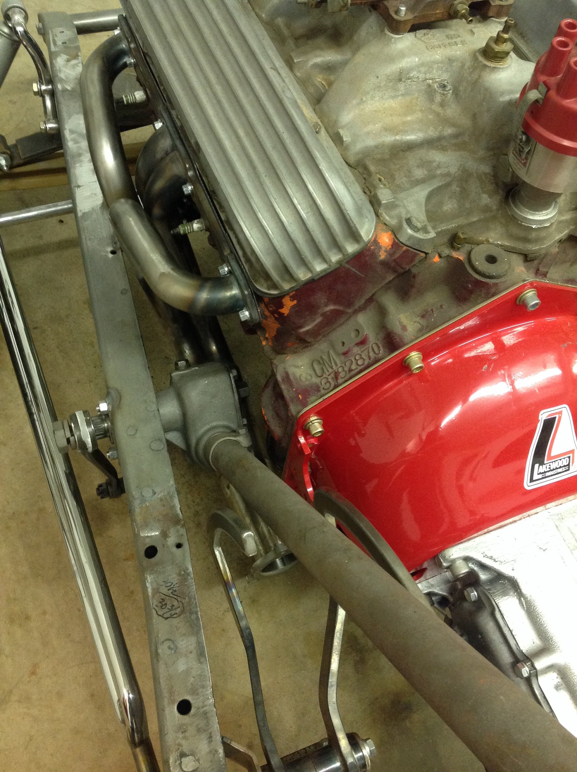

  28. Finished modifying the headers and raised the shifter bracket up. Put body on to see how much it will take to clear the lever.
