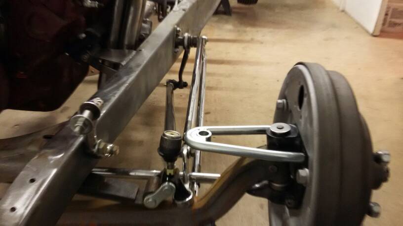

  20. Working on the drag link from an F1 box to round back spindles with the original hairpins. I know why everyone went to Vega cross steer now when running hair pins. Any advice from some guys that ran the F1 and F-100 boxes with hairpins back in the day? I would think this was pretty common in the 60's and 70's Era hot rods. I have yet to find a picture of this car showing the drag link. This car actually had an F100 box but I really don't like the pitman arm with the pinch bolt.
    volvobrynk likes this.

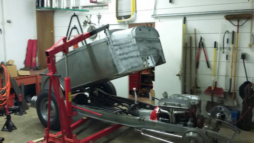

  21. Finally set the body back on so I can figure out the body mounts and get the front sheet metal sorted out. Father's day is coming fast and I need to get busy!
    volvobrynk and sota like this.

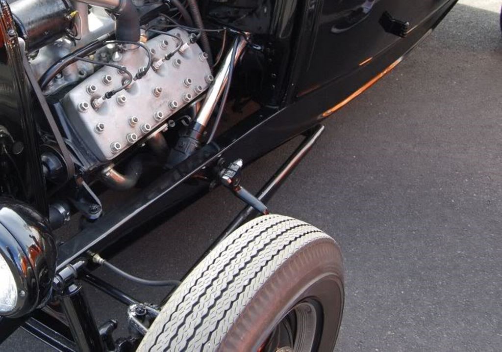

    A couple weeks ago you tossed out a question about pittman arm/drag link clearance. Here's a pic from my old Tardel built car and how he did it with the F100 box. Your top bar on the hairpin might still be too close, but this might help your brain figure something that will work..
  26. Thanks for the photo. I have a pitman arm that I mocked up similar to yours but the Hairpins have less room than a split wishbone. I think I have figured out a good way to get it to work and still make it look decent.
    Nice looking car!

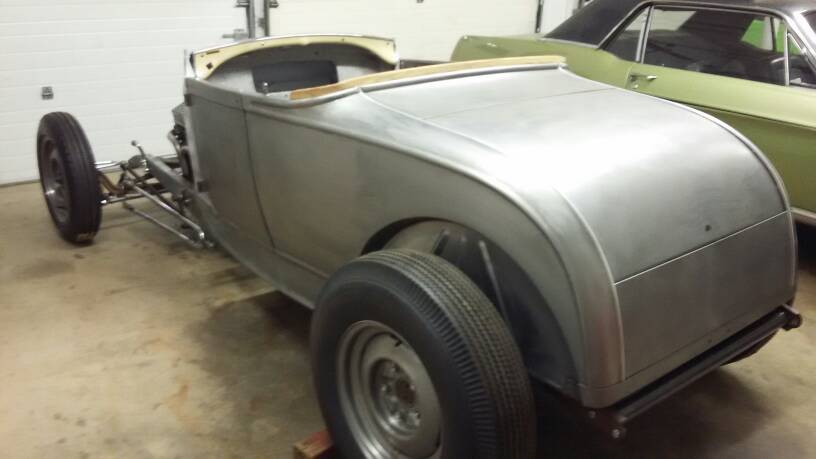

  27. Had to roll the roadster out so I could change the oil in my boring old daily driver pickup. At least I get to stand back and actually see what it looks like in daylight again
