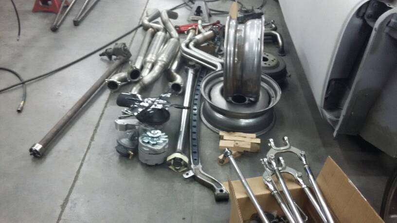

  1. Need to finish hanging the exhaust. Next will be to mount the fuel tank and plumb the Fuel and Brake lines.

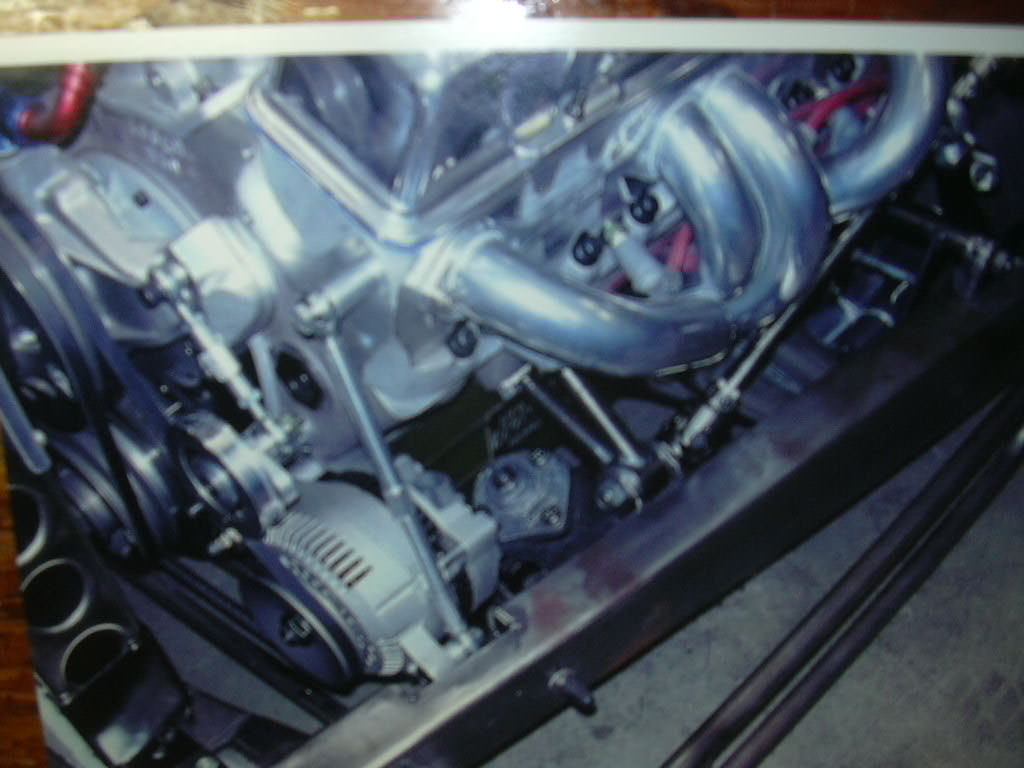

    Did you use the alternator bracket that came with the "Zips" water pump?
    Thanks...
  9. Thank You, yeah I cut the A/C brackets off the Zip's drive and I'm using the cast in one for the alternator. Not sure what I'm gonna do on the adjuster bracket yet.
  10. DDDenny
    Posts: 22,570
    How about a low mount setup like this with a belt tensioning pulley, my frame is pinched so I needed a smaller alternator, also wanted higher output, this is a Ford Racing unit.
    The camel hump heads without acc. holes could be an issue, but I have seen it done.
  11. Nice looking set up. I thought about building a low mount for the Alternator. I do like the easy belt adjustment with the Alternator up high.

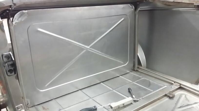

  15. Decided to build a firewall between the trunk and seat back. Definitely helped stiffen up the back of this roadster body. Getting all the parts for the plater ready and drilled the front axle

  19. Thank You. We can't take credit on the floors as they are Brookville but we are trying to keep the theme consistent.
  20. We also added a strip down the B pillar to add strength and give the interior a place to mount. The gas tank is a speedster tank from Snyder's.
