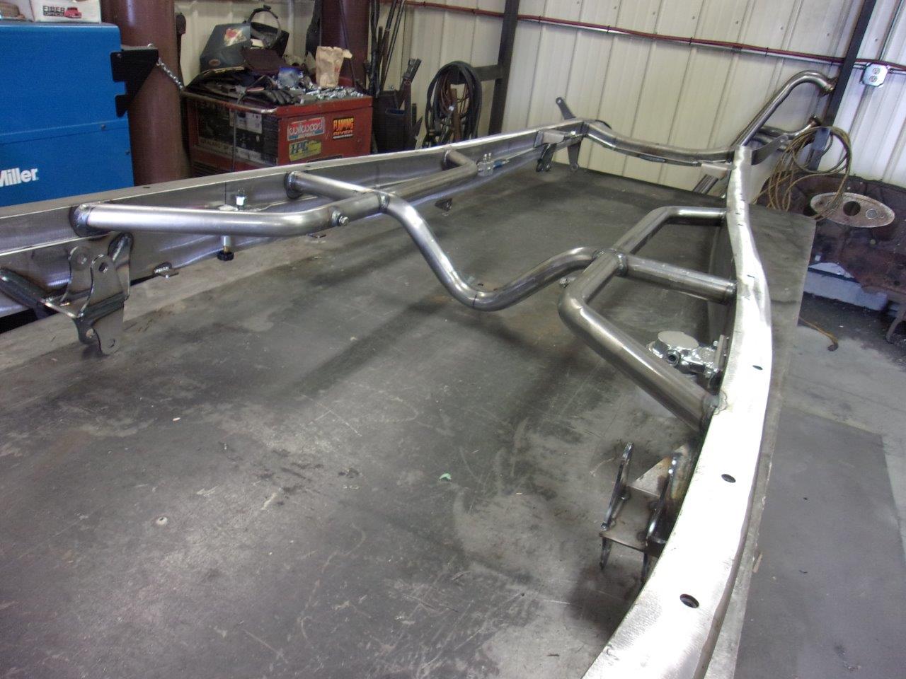

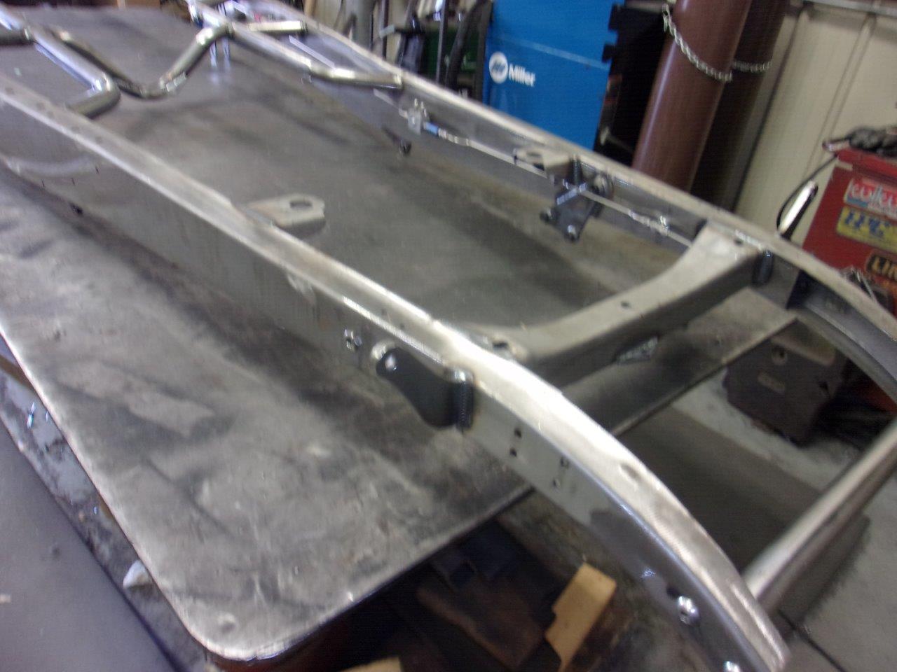

    Parallel leaf rear? What's going on with the spring mounts? Am I seeing upper and lower for height adjustments?
    Sorry. I'm not super familiar with P&J stuff.
  19. krylon32
    Joined: Jan 29, 2006
    Posts: 11,223
    krylon32
    from Nebraska
    Hitch Hiker. The mounts you see are the front end of a parallel 4 bar setup. Their hooked to a buggy spring 9 inch rear. I have the same setup under my deuce 3 window and it works great. This is not P&J's standard deal. The ch***is is going under a Brookville roadster body that has had the p***enger compartment moved back 2.25 inches and the door stretched the same. Will be full fendered. Replicating as much as possible a roadster I built in 1979. Will be Wheatland Yellow with Black Bop Top.

    Same rear suspension I have except I used the long triangular bars attached in the center . Reversed the eye on the buggy spring
