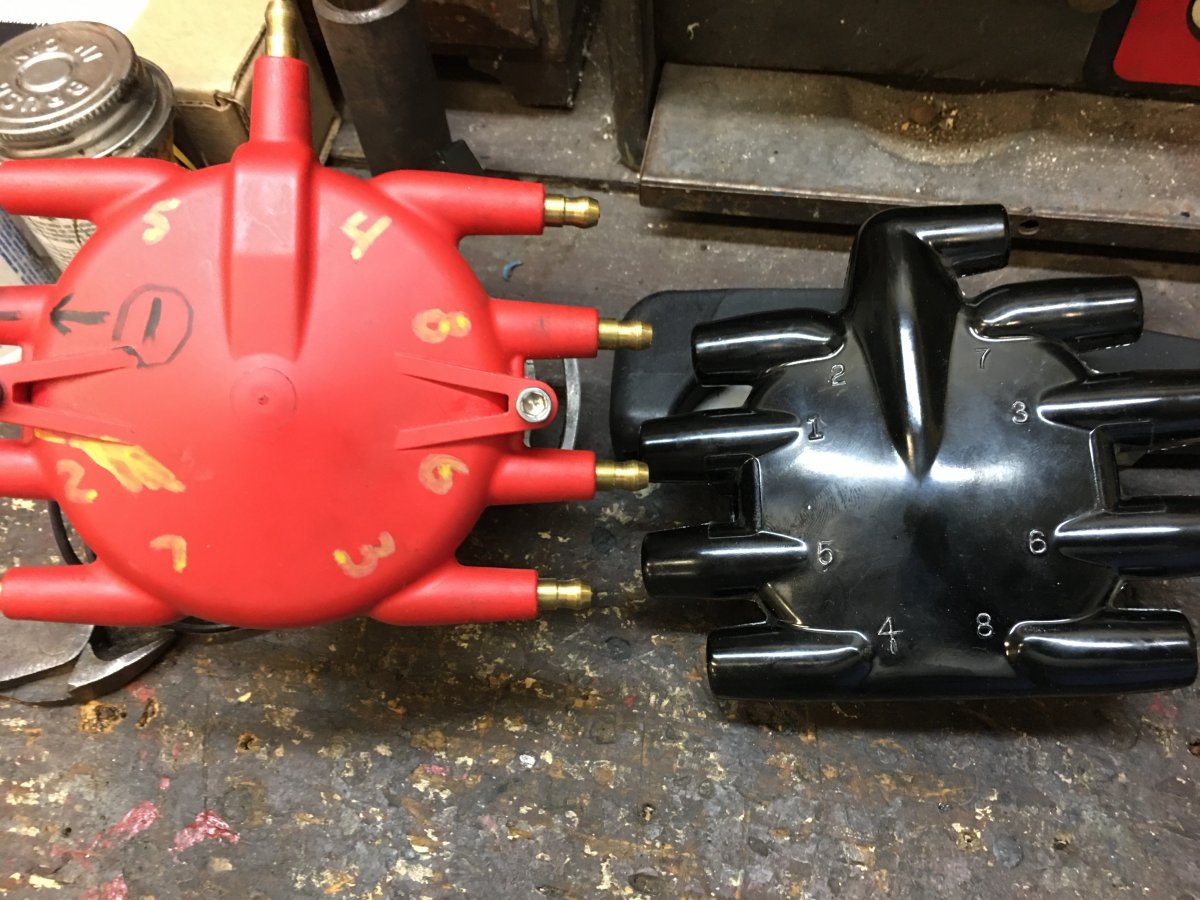

    This engine is a rebuild, never started.
    Checked the distributer timing. All correct.
    Gonna double check the plug location.
    Engine is backfiring out of the front carb.
    Hasn’t idled yet.
    If it was all easy it wouldn’t be fun. Right?

    back to basics - distrib correct with #1 at TDC - plug wires correct - vacuum leak - coil - if you did not rebuild motor pull valve covers & check top end

    Distributor is correct at #1.
    With the front carb backfire, I have at least good spark, so the coil must be ok.
    Going back over the wire placement today.
    Along with checking for proper spark in all the holes.
    The 48 flathead distributor rotation is counter clockwise. I did install a new rotor and cap on a known working MSD distributor.
    Boy I hope I don’t have to remove the heads (not valve covers) on this.
    Here’s the first (no fire video) with a small front carb backfire.

    1941815D-0233-44A9-9760-82601D9E9712.jpeg I’m a dumb ass dyslexic.
    Knowing these distributors run counter clockwise I decided to install my plug wires clockwise.
    I got frustrated with the MSD and was getting ready to install a stock unit.
    Look what I noticed.
    Flat first fire.
    tractorguy, hfh, Fordor Ron and 7 others like this.

    Don't sit in the truck with pliers sticking out of your pocket! :eek:
    Sounds like a flatty! I like it!
    GordonC and Petejoe like this.
