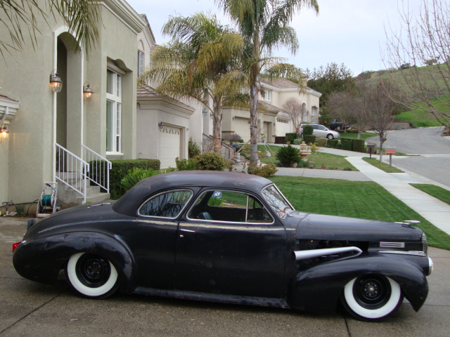

    Here is an update on the '40 LaSalle I got a couple years ago.
    Here is the original thread started when I got the LaSalle:
    http://www.jalopyjournal.com/forum/showthread.php?t=258678&highlight=phat+caddy
    When I first bought it I took everything apart, pulled the motor and trans (sold it to a HAMBer), replaced the gas tank (gave that to a HAMBer) with a 60's Mustang tank and bought a 509 Cadillac BB for the powerplant. It sat for a year and then at Santa Maria last year I met Johnny, owner of Kool Cat Kustoms in San Jose, who had just finished building a beautiful '37 LaSalle. Seeing the work he did on the '37 and knowing the issues I was going to have I knew he was the guy to get the 509 Cadillac motor in and completely re-fab all of the drivetrain.
    With this motor I knew I wanted to have the pipes coming out the side to make this more of a hot rod to complement my '57 Kustom. Also, over the last months I really wanted to do something different with the interior so I found a '49 Merc dash (from a HAMBer) and seats from a '65 T-Bird. I gave the dash to Johnny to swap and customize it. Oh yea, I sold the dash to a HAMBer too.
    I attached a couple pics but I will let Johnny detail with pics of all the great work he did to the drivetrain and dash.
    Next I will finish mocking up the interior, slowly over the summer, get the exterior body work finished so it can go to final upholstery and paint by November. But for now I will be driving the hell out of it.

    Is it a Kustom...or a hot rod...??? The whitewalls say kustom, but the "exhaust pipes," if that's what those are, say hot rod...I think I'll reserve my opinion until I see better photos...

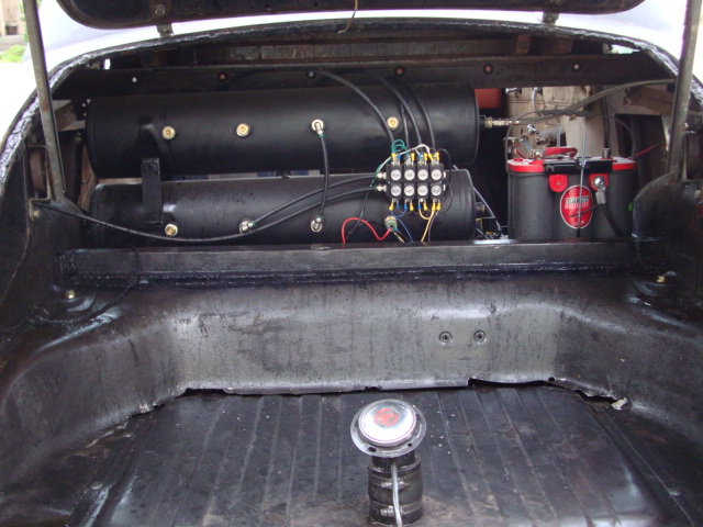

    Here are some pictures of the build. The first on e is a picture of what I stared with, that's how it got delivered to my shop.
    Next two pictures of the rear suspension, fourlink, bags, a.s.o.

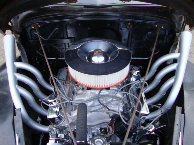

    And some pictures of the Fatman clip that I installed and the Big 509cid caddy engine.

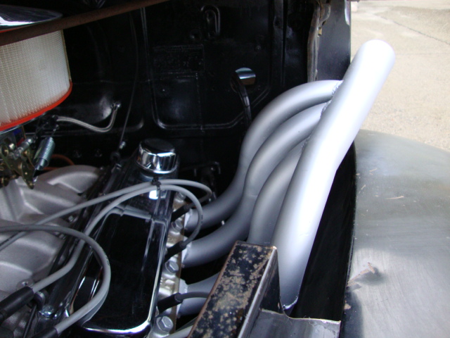

    some pictures of the exhaust

    Hey Jerry, how are you? I'm sure you can imagine how those pipes sound. So good I had to have Johnny put baffles in them Sunday morning to tone it down just a bit. Sounds soooo good though. Music to my ears.

    Car looks good. I'm not sure on the exhaust. Maybe a side shot?

    A few more shots......

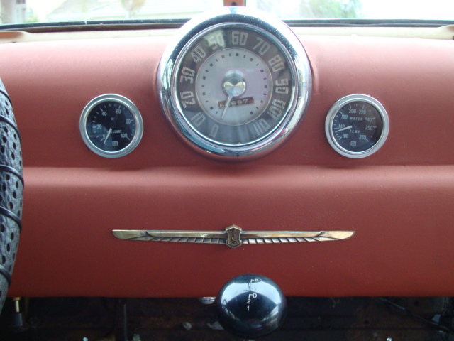

    here's a pic of the stock dash and the dash I made out of a '49 merc dash

    some pictures of some rust repair on the trunk, the trunk wouldn't close because the latch was gone from so much rust.
    Brian had installed the gas tank himself before it got to my shop.
