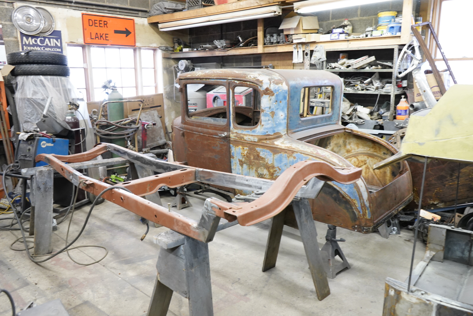

    RustEE
    Tremendous fab work by The Maestro of Metal @Koz Fabrication!

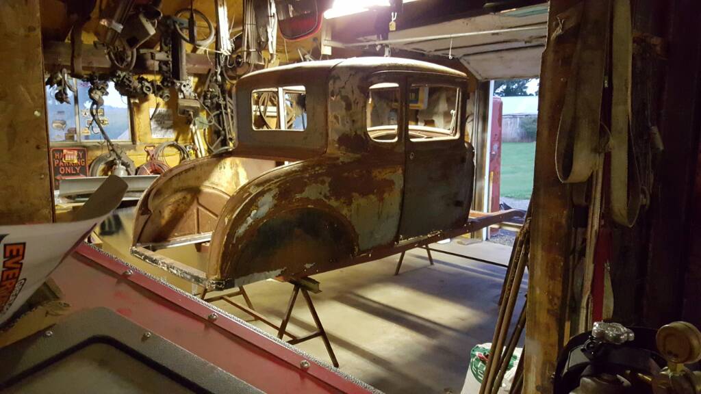

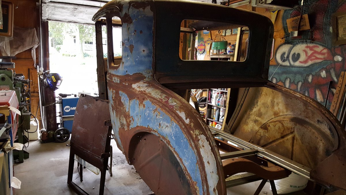

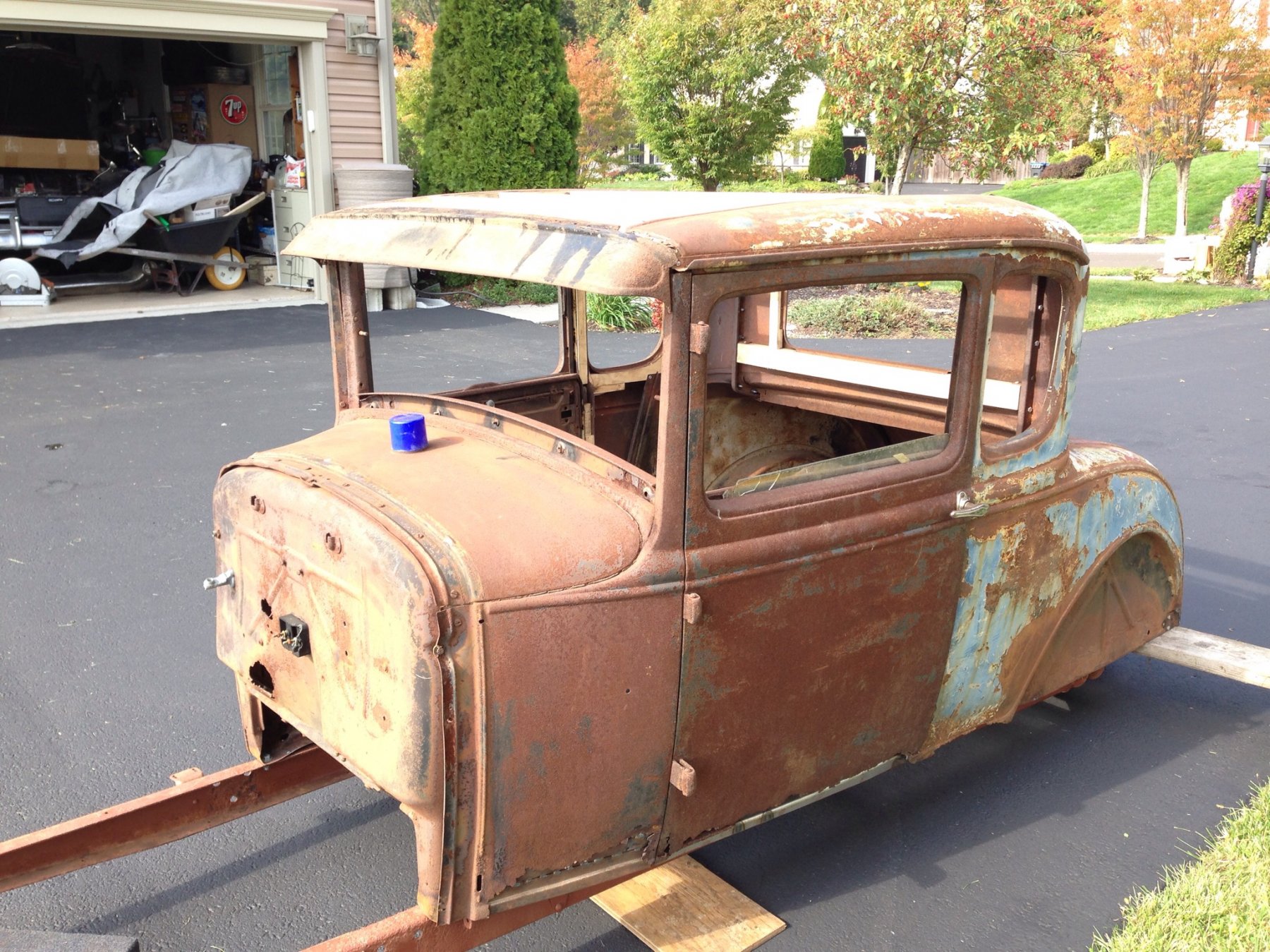

  8. RustEE
    Joined: Feb 9, 2013
    Posts: 38
    RustEE

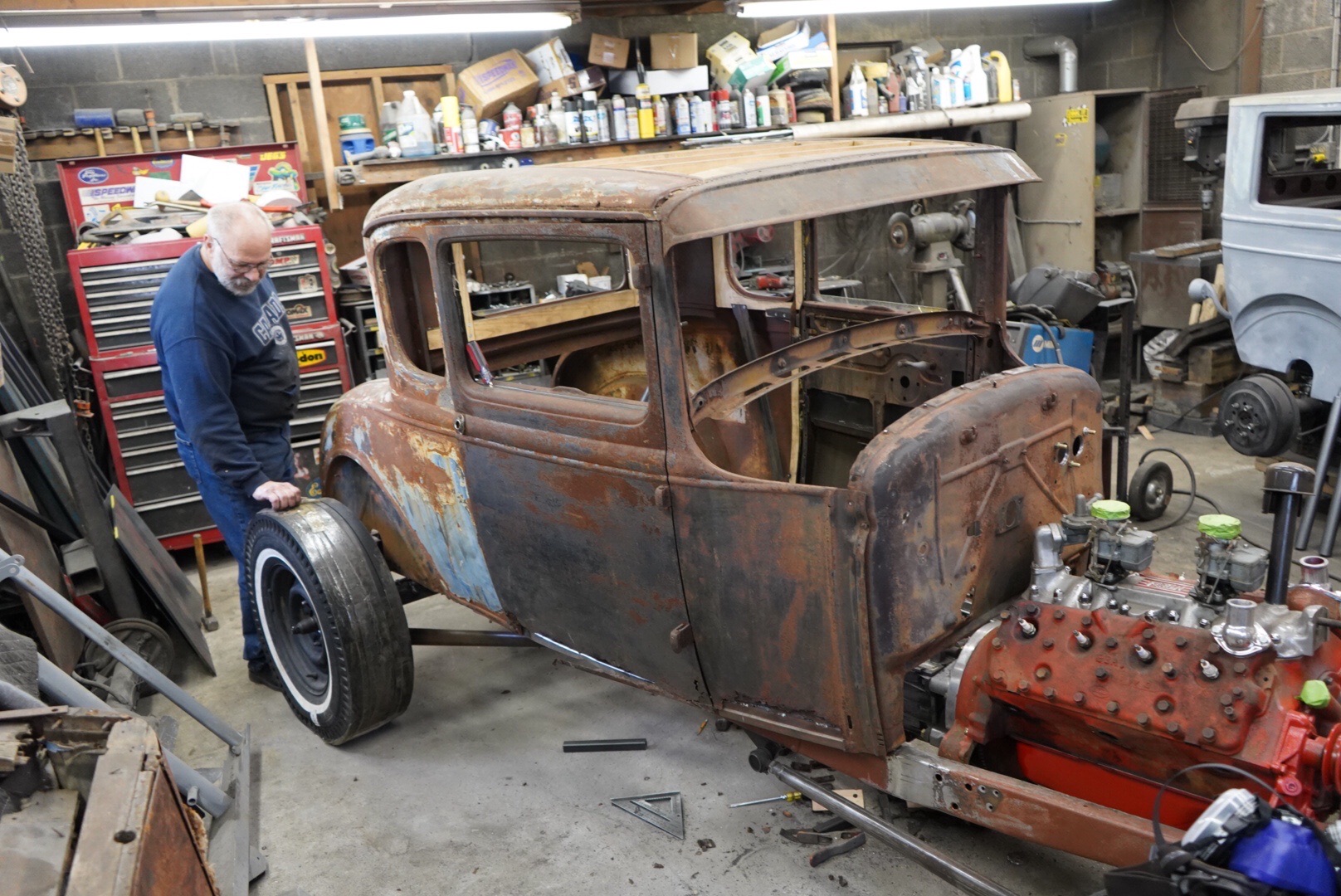

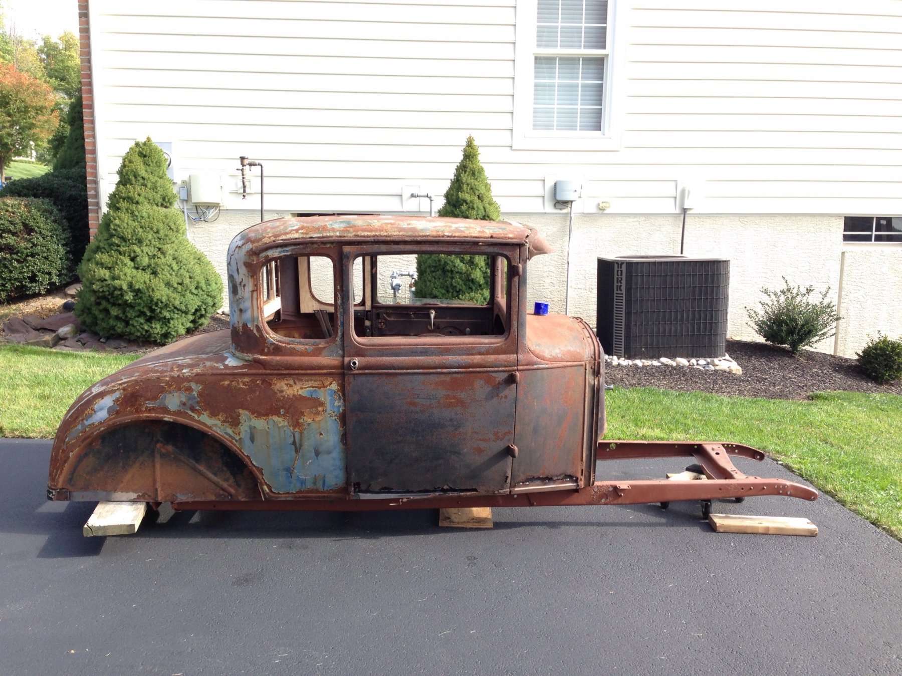

    Love at first sight!
    30-31 body/frame

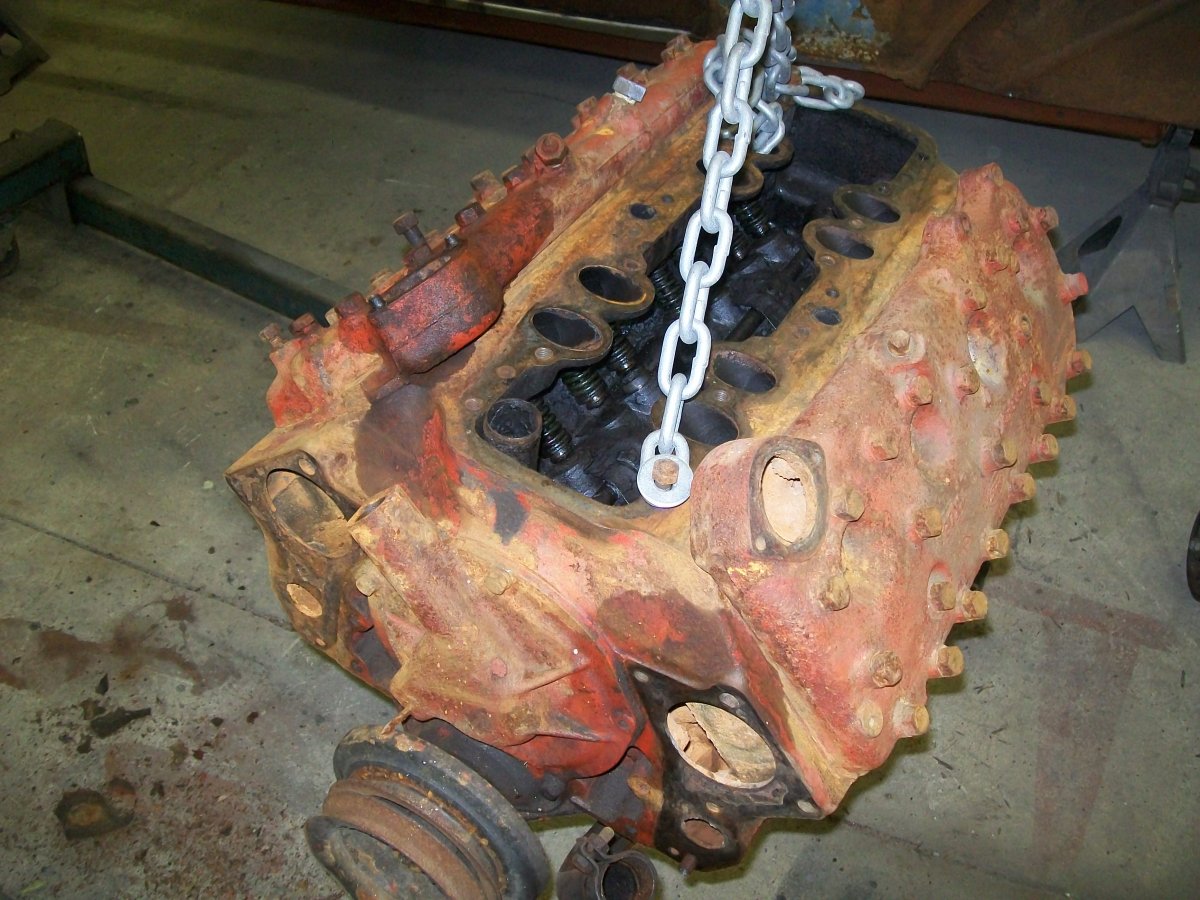

    RustEE

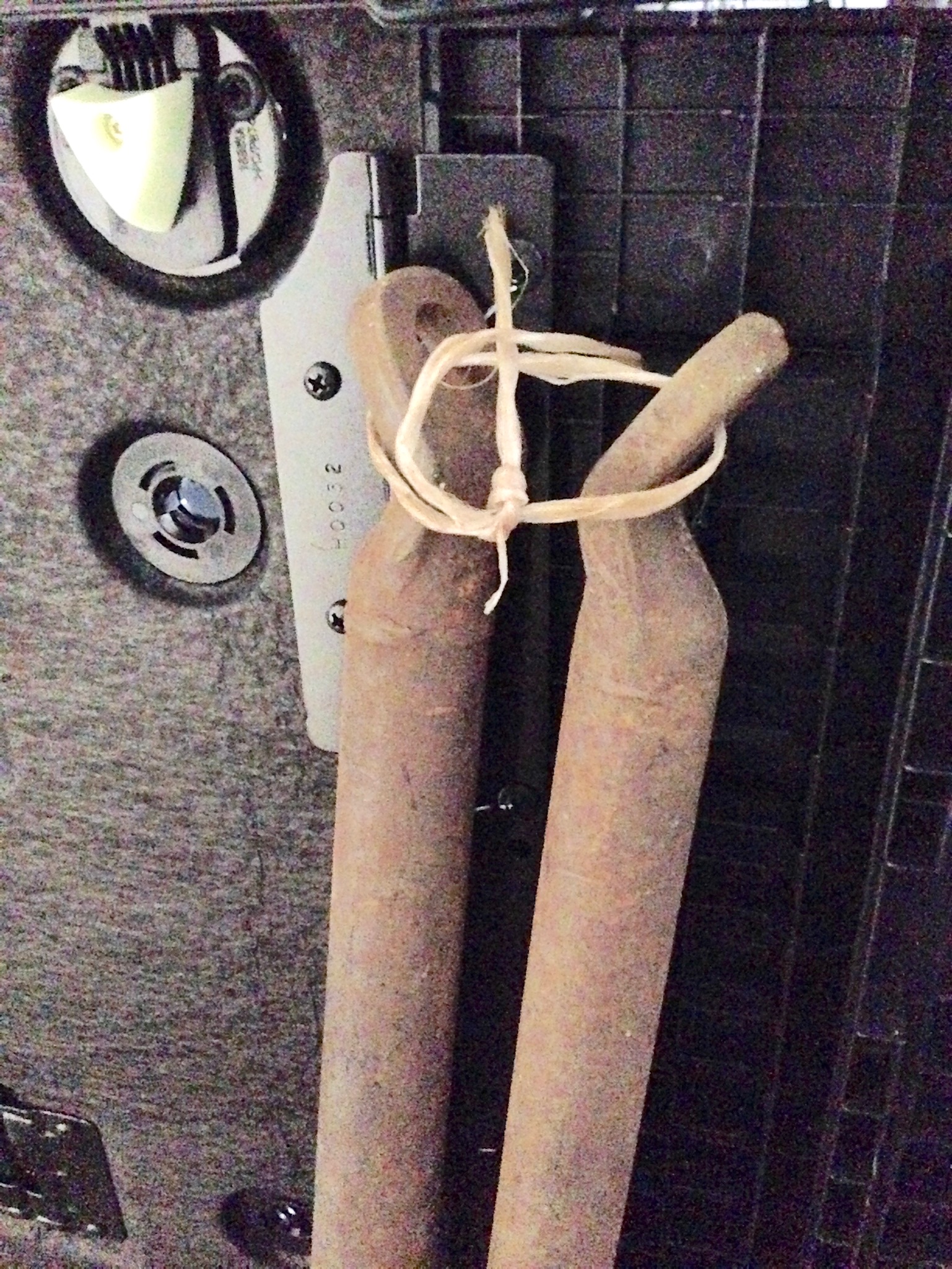

    Sourced an eBay 8ba Flatty out near Pittsburgh…so many people have helped me locate vintage parts for this build it is humbling.

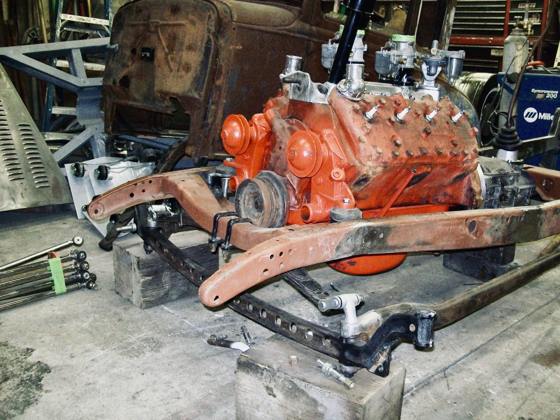

    One piece at a time

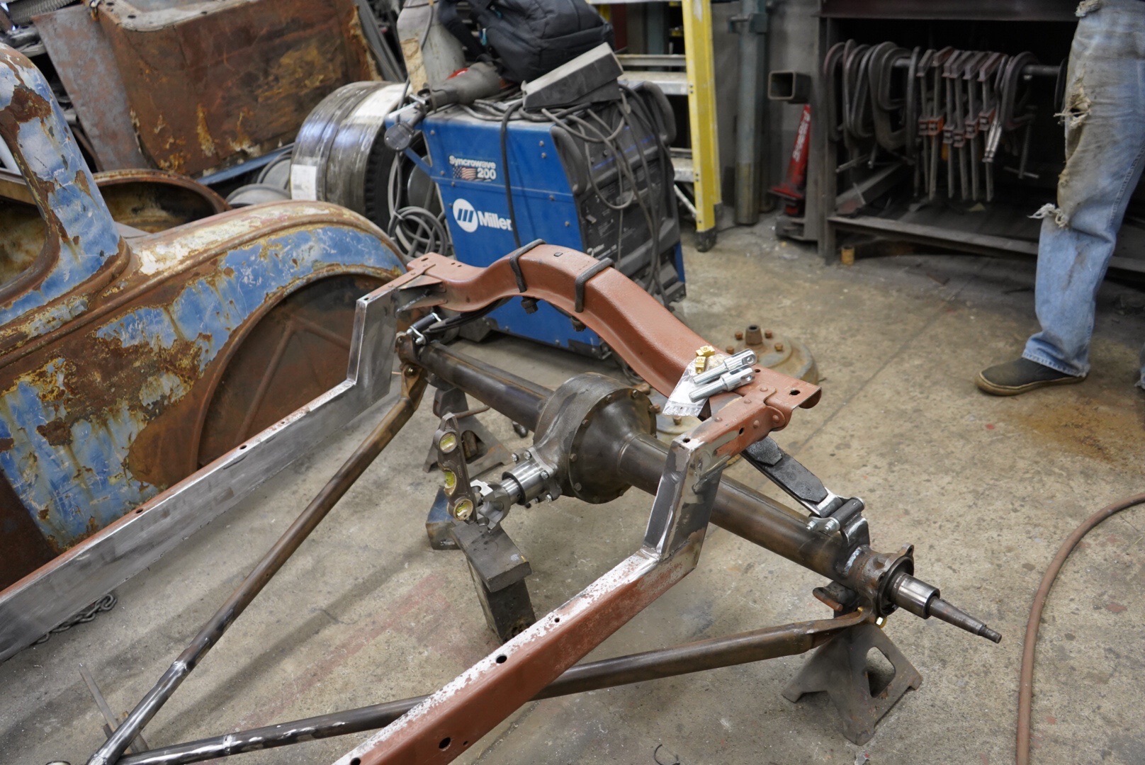

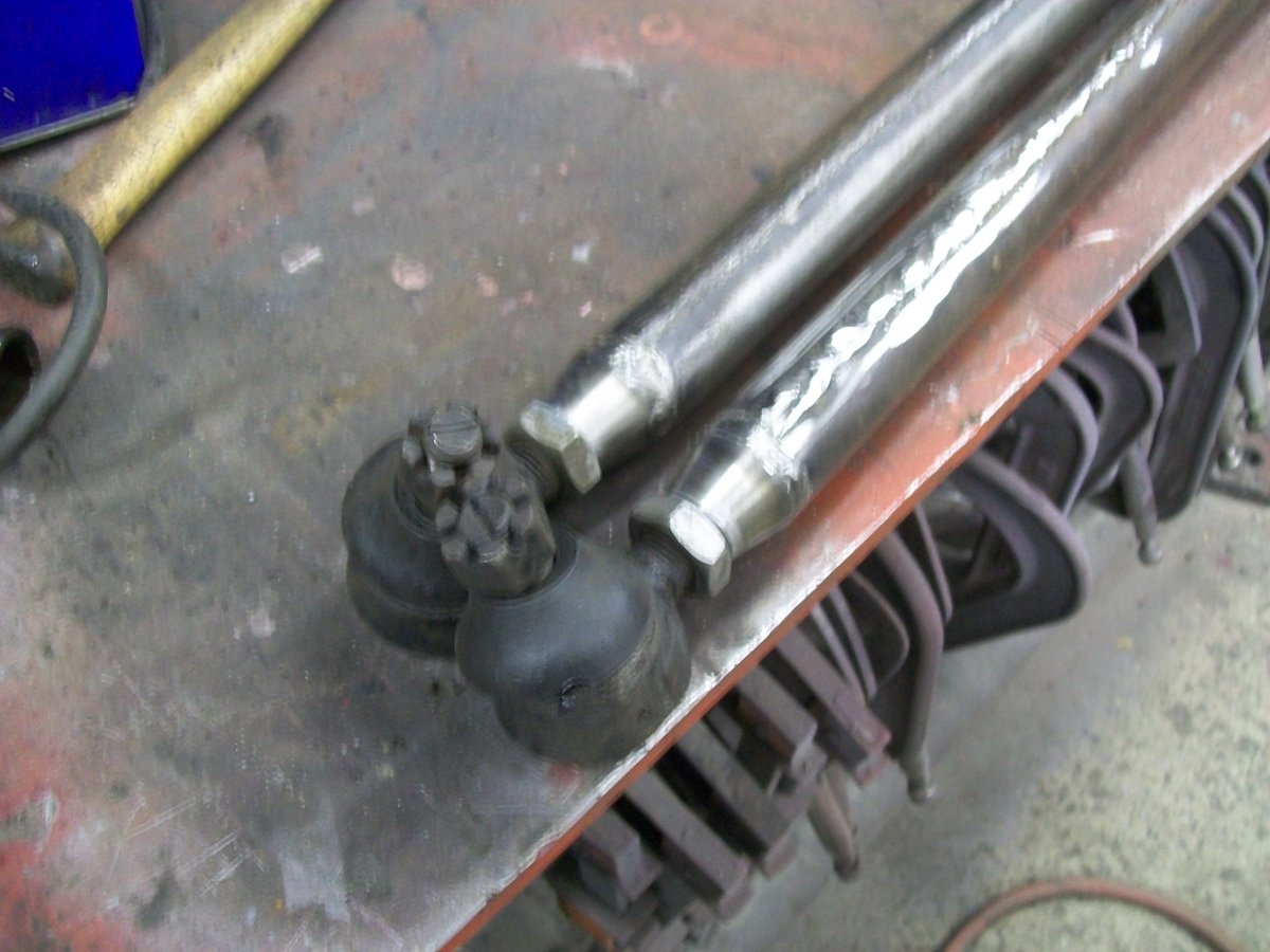

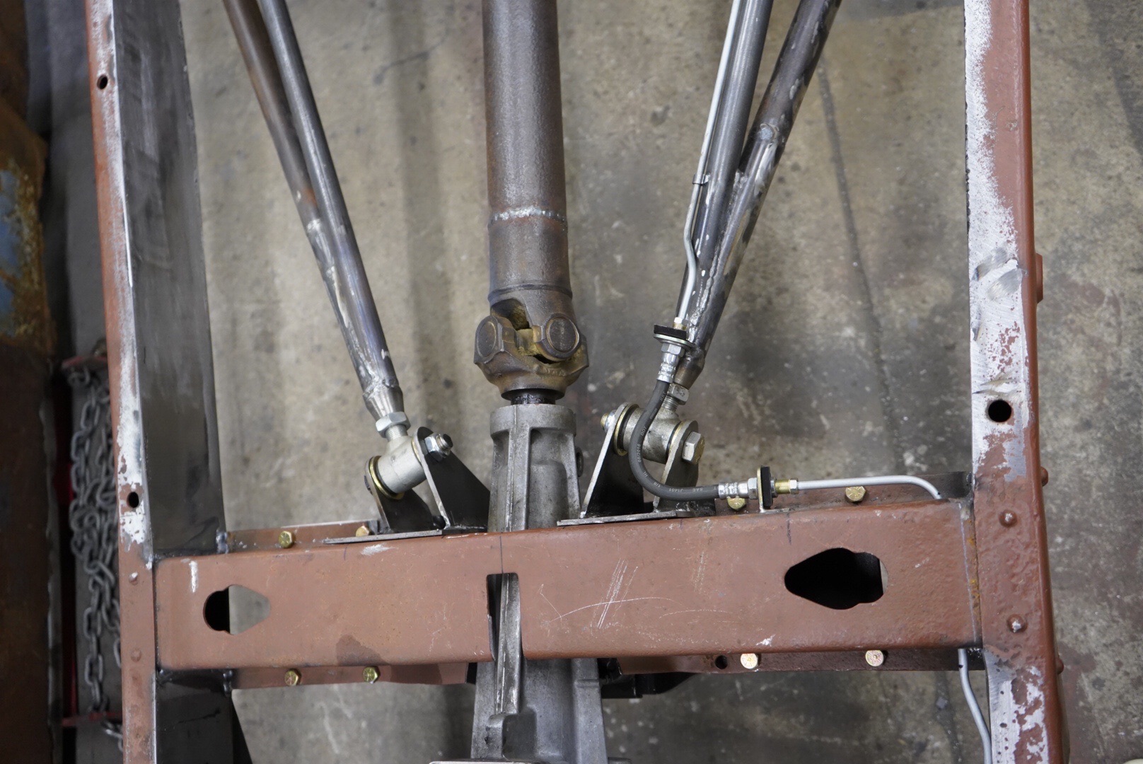

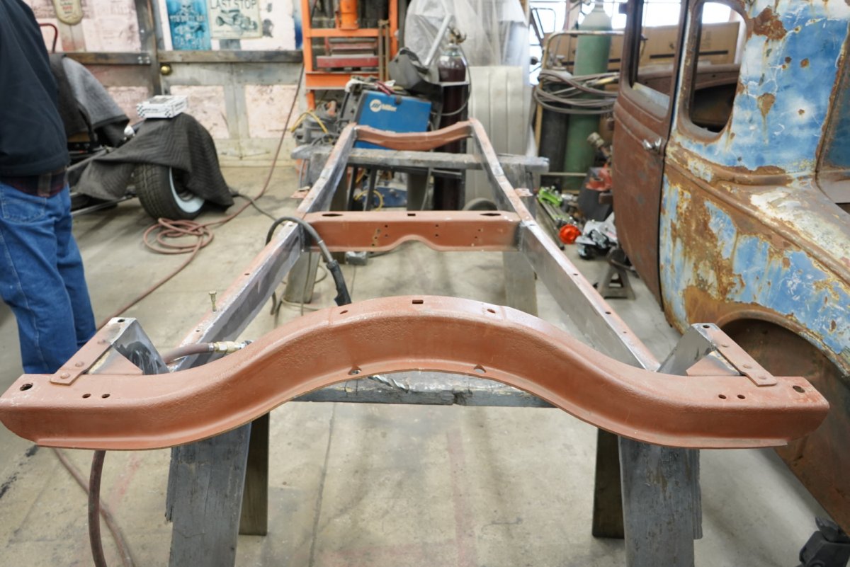

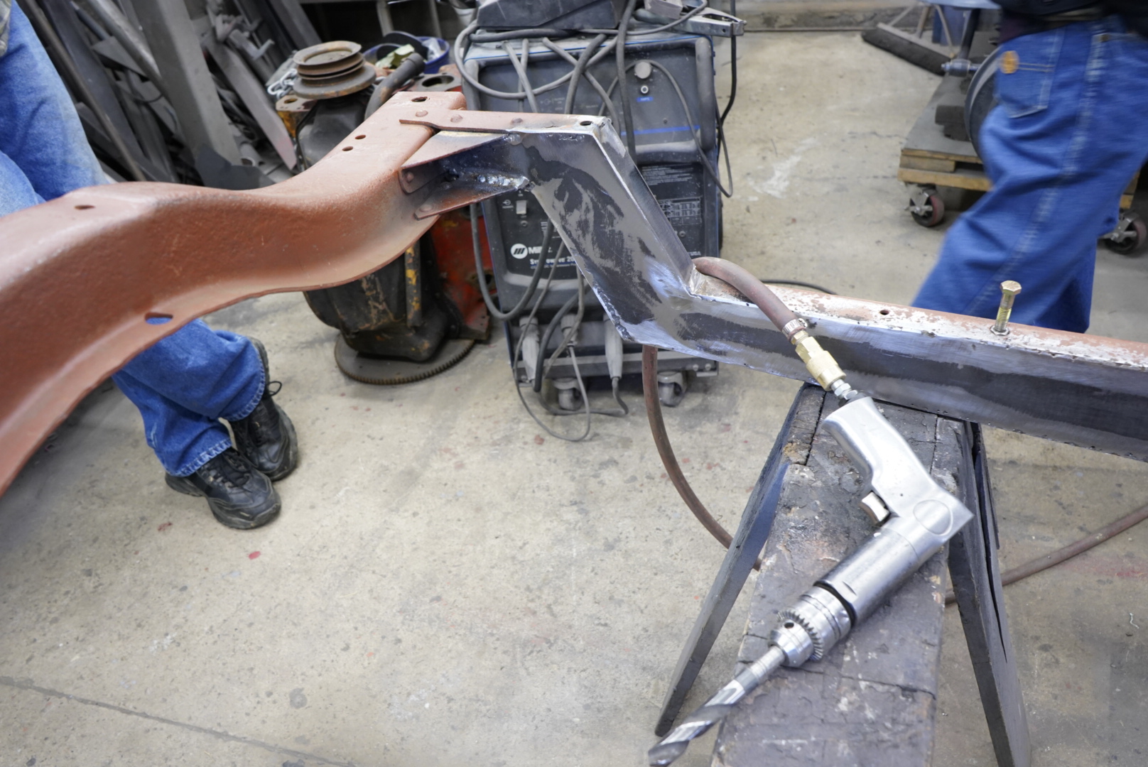

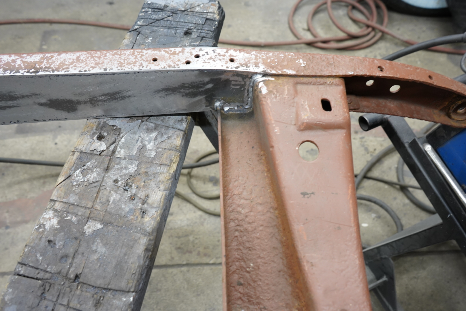

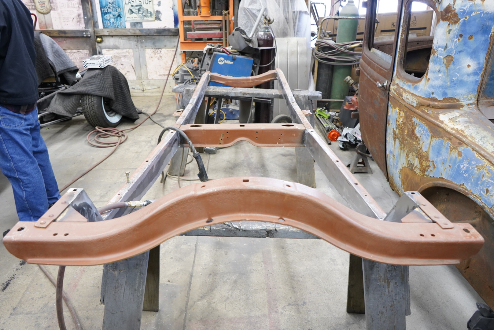

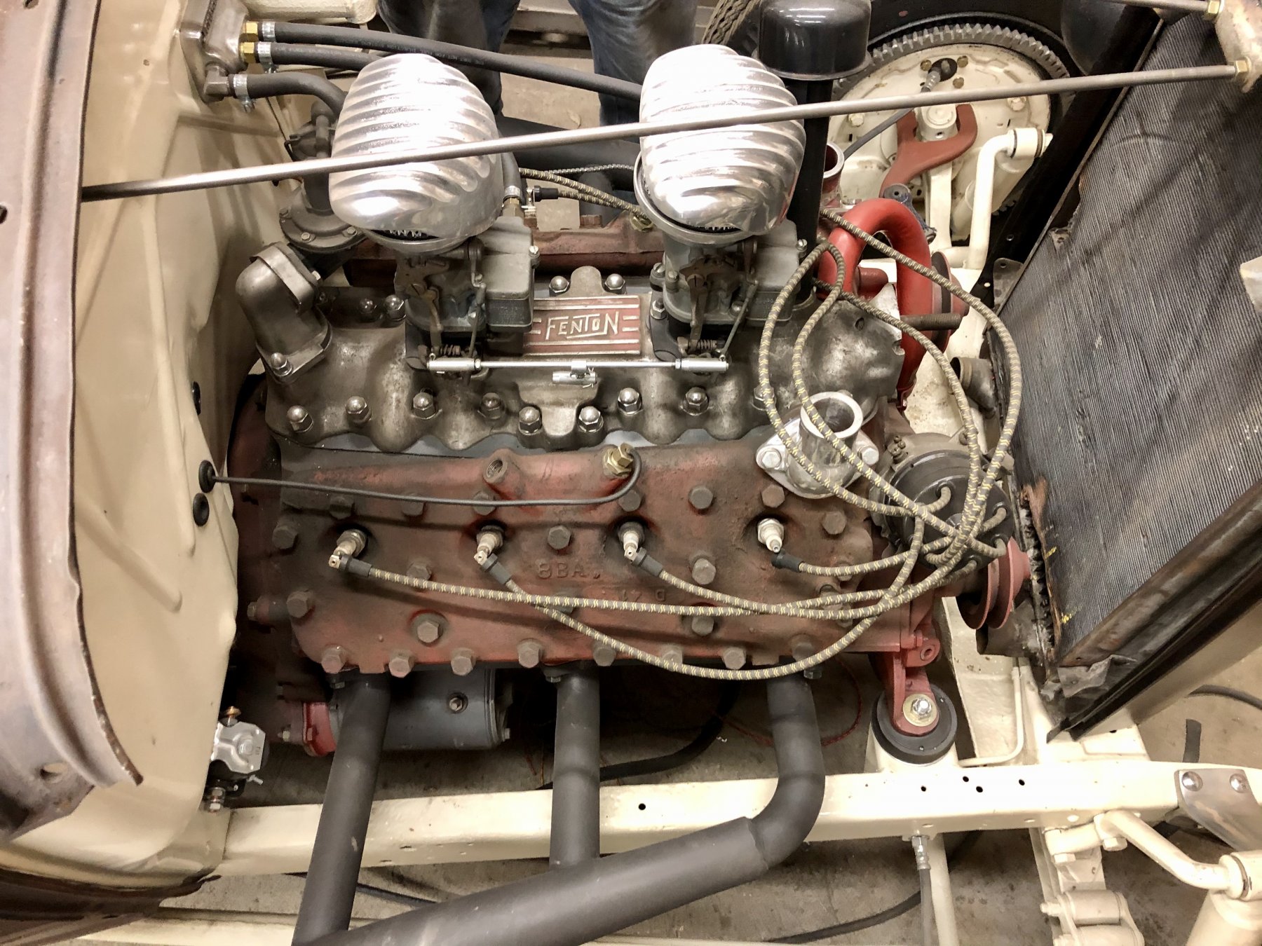

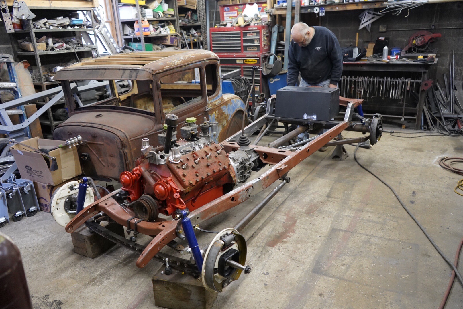

    I am humbled Rustee! You're the best kind of client in that you really knew what you wanted up front. You made the build easy and it is totally in HAMB character to boot. I know you've been holding back on the shots of the car so far but it is really a real hot rod. Done with a load of vintage parts and a couple of upgrades for everyday use. I'd have no problem jumping in this one for an across country run.

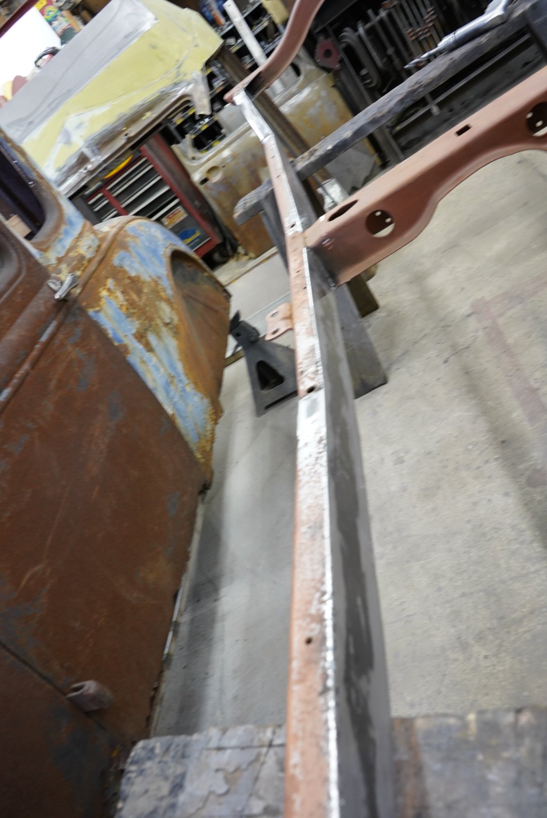

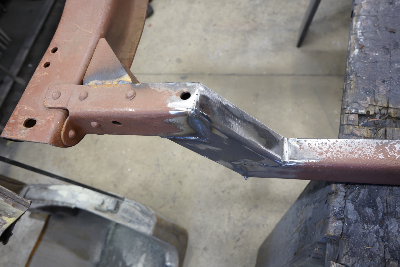

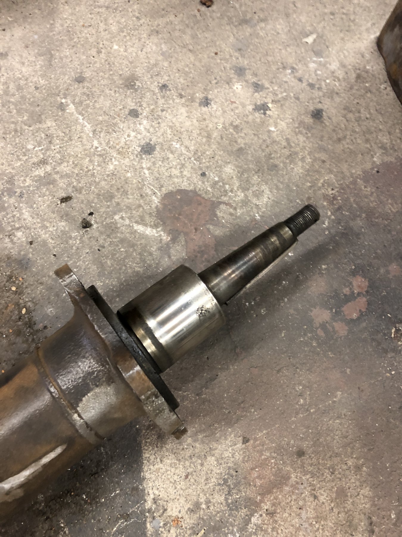

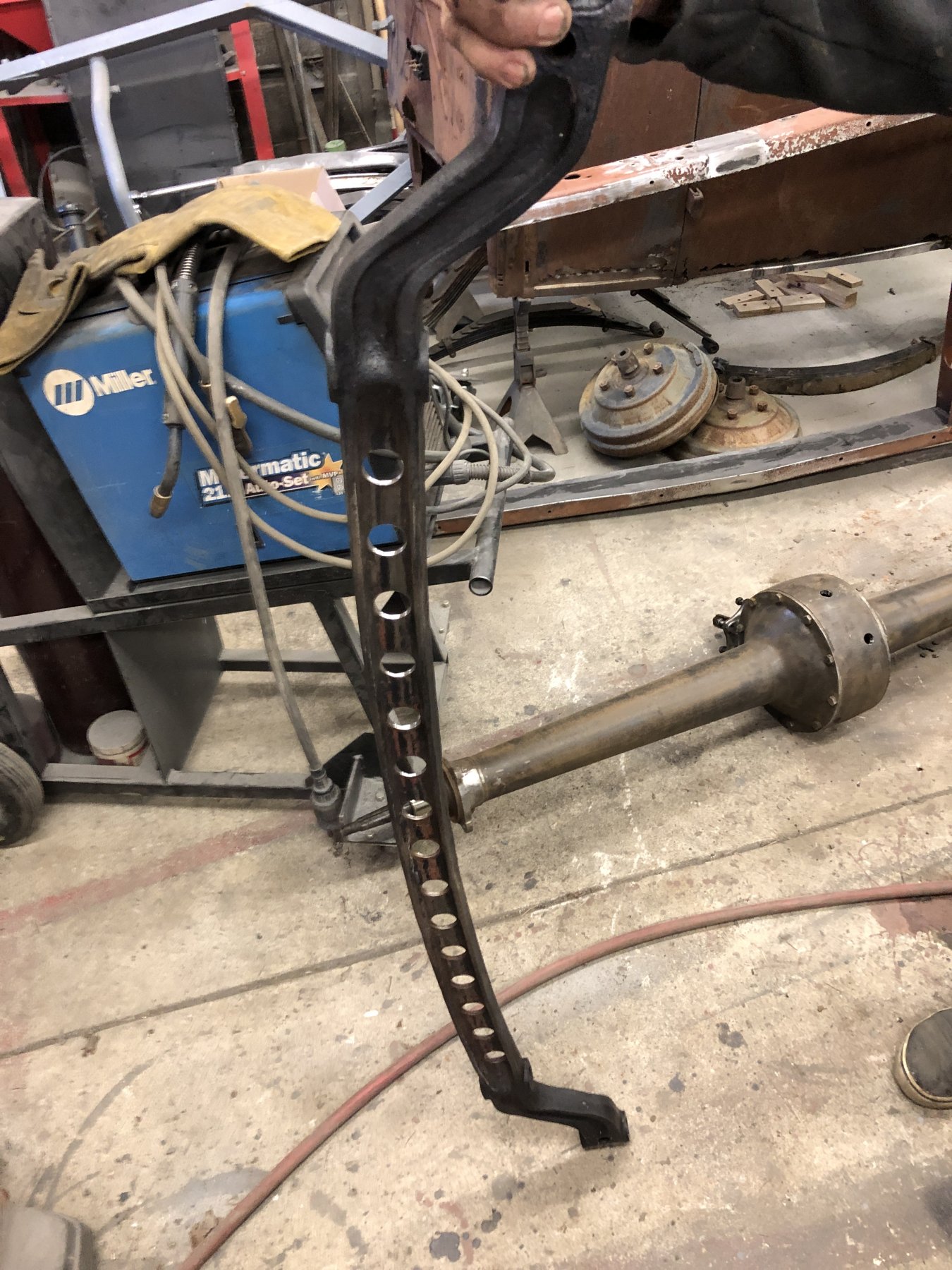

    I'll let you post the pics but I feel the ch***is is perfect, (vintage model "A" frame stretched 3" to deuce dimensions), boxed and sweep Z following Doane Spencers iconic lead, with a 6" rear Z to put the 1960's era cheater slicks, (for street use), right in the arc of the wheelwells.

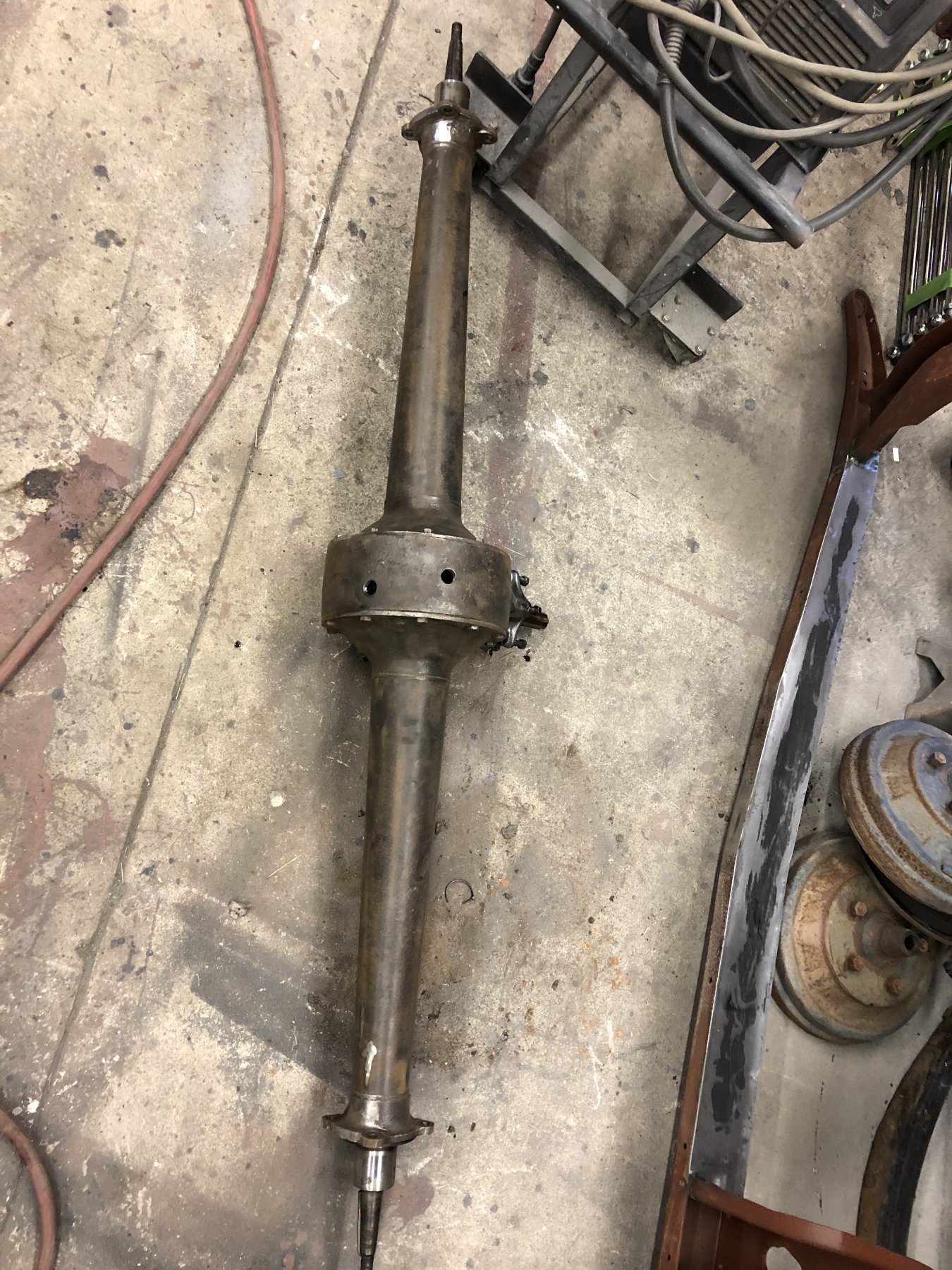

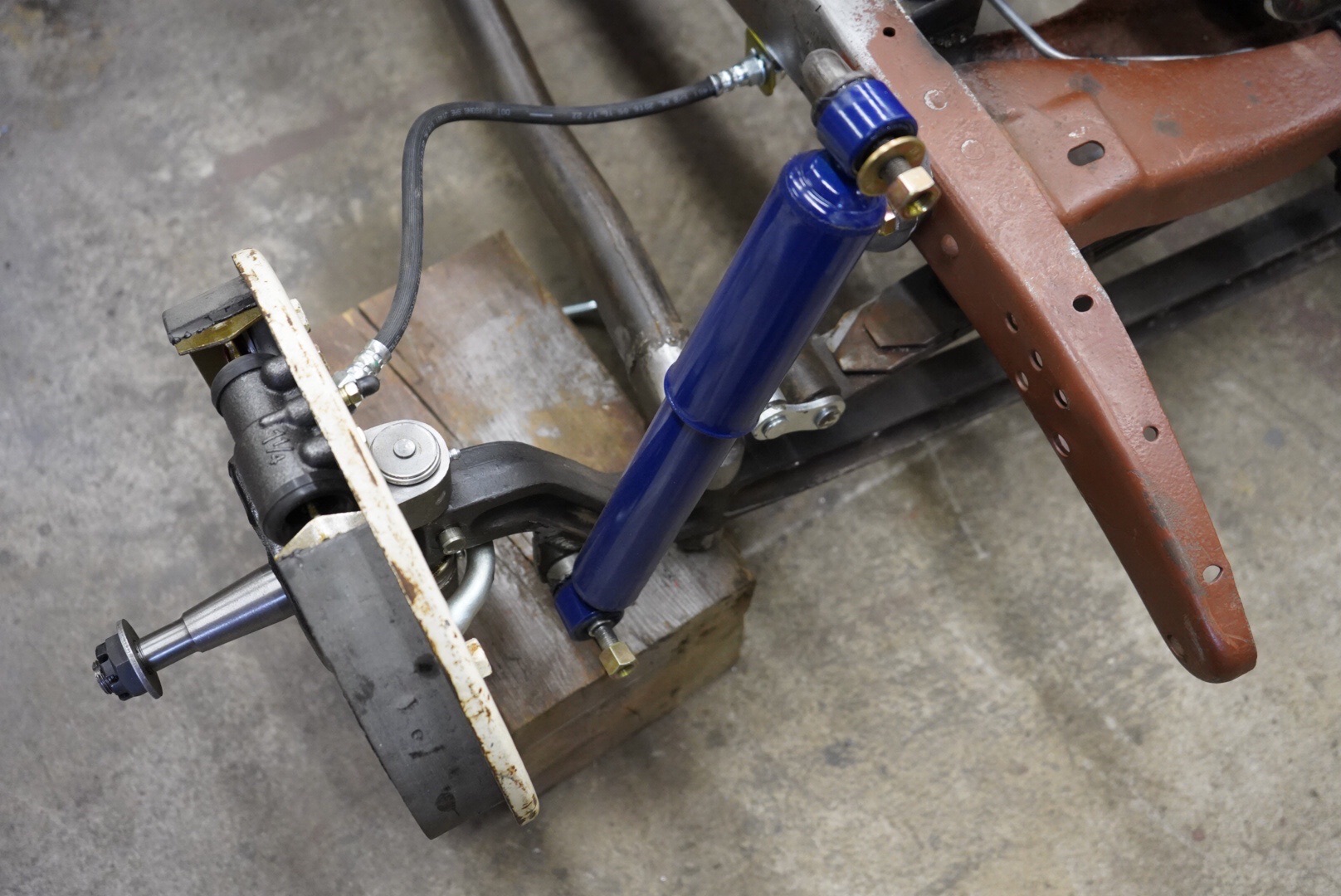

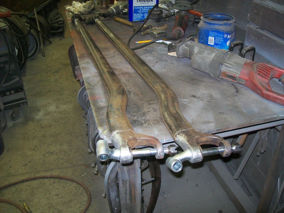

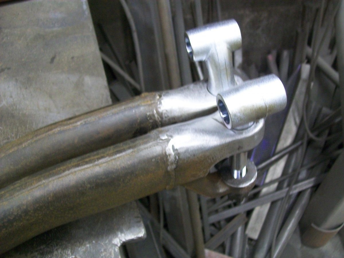

    The Henry issued Model "A" axle was dropped old style by Andy Kohler and holes milled in a pattern my Dad used in the fifties. A pair of '48 Merc 'bones located everything up front and a sweet '40 banjo brings up the rear. Stopping gets taken care of by '48 Ford p***enger brakes and a 1960's Chevy truck master and clutch cylinder combo. Been done a million times but oh so traditional. Everything just goes together so well it is hard to tell when it was built. All this is coated in a vintage cream that perfectly matches a set of front backing plates Rustee provided that were painted who knows when. Painted covered shocks and '48 pickup shock mounts. Lots of hunted down parts here.

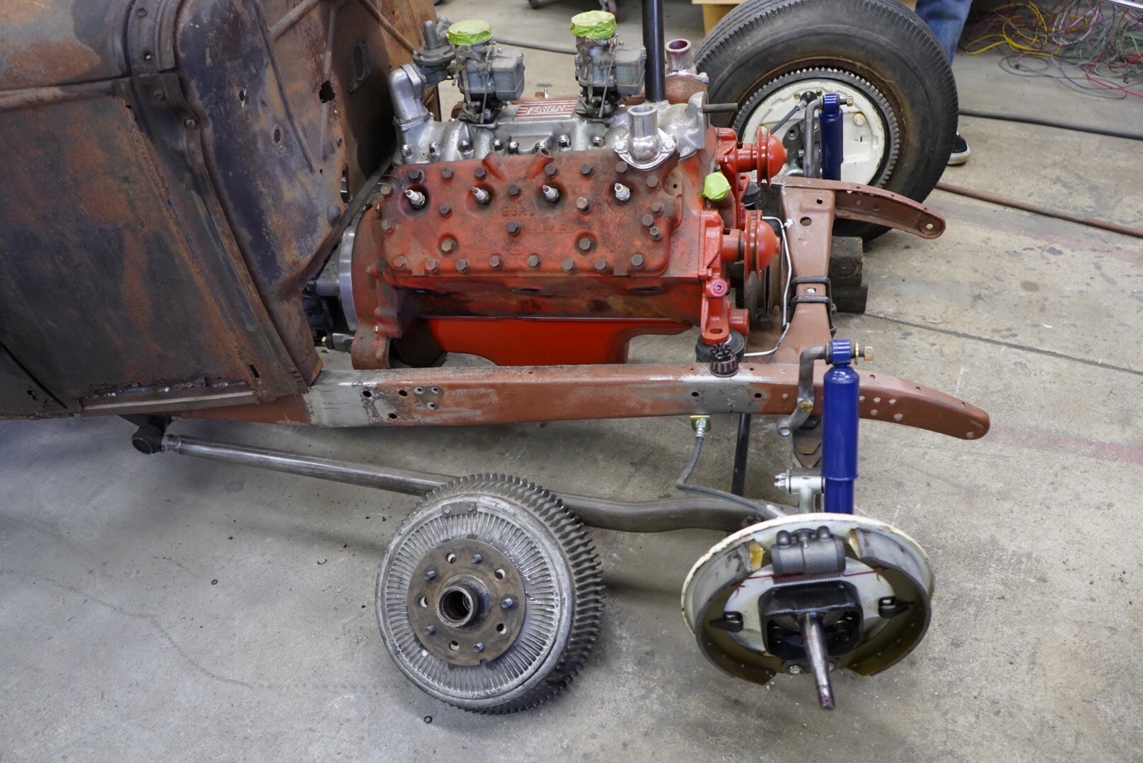

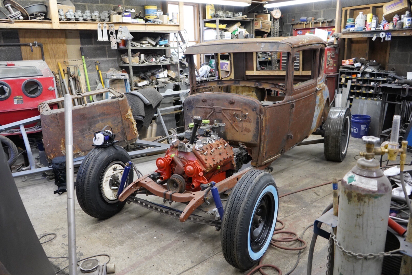

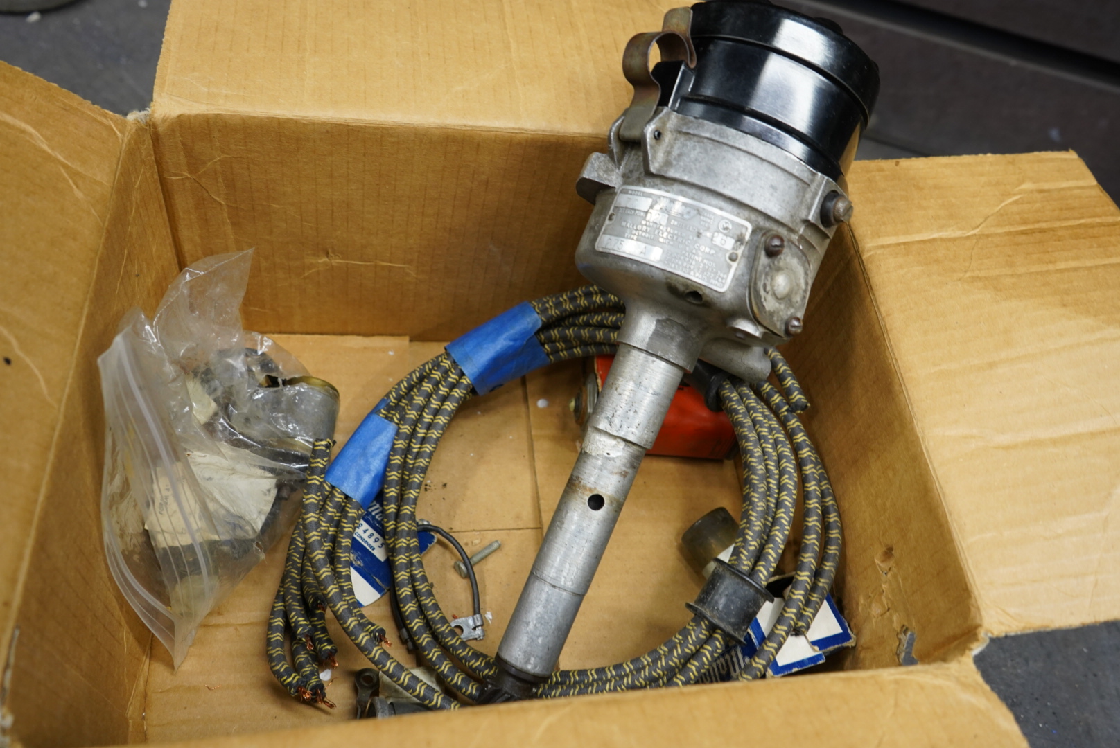

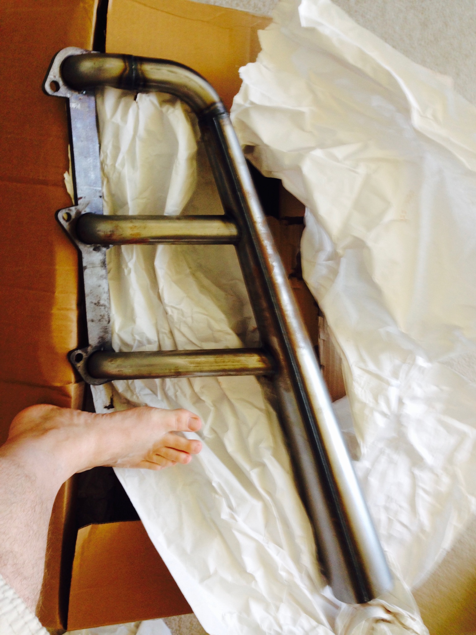

    The 8ba is basically stock intrnally with a 2x2 Fenton and some Holley 94's. A very vintage but mint Mallory dual point makes the sparks and a pair of Speedway headers with the tapered tube replaced with a '36 driveshaft and a pair of reworked Cherry Bomb cores to keep the racket under control. T-5 and the stick from a '36 makes it work.

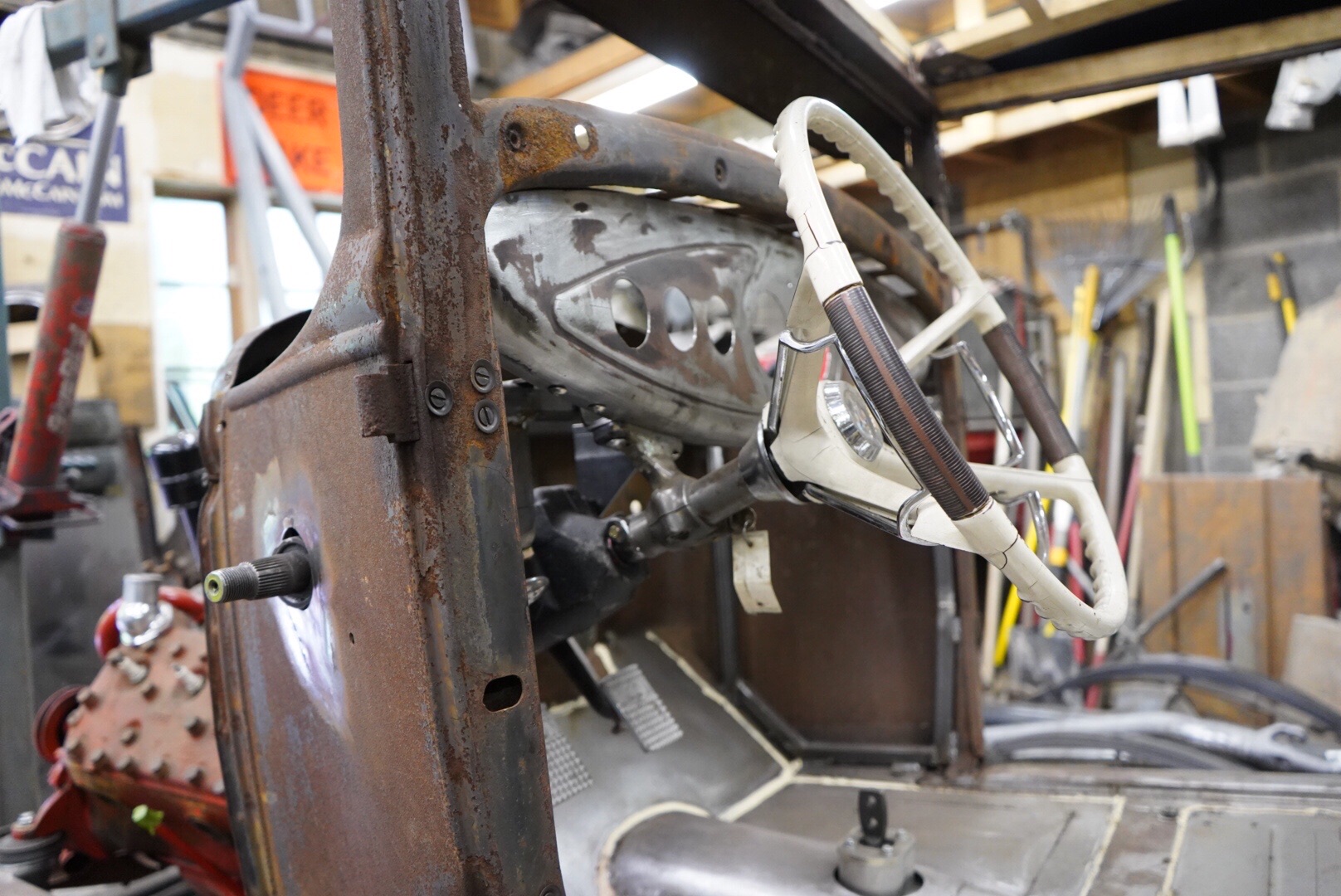

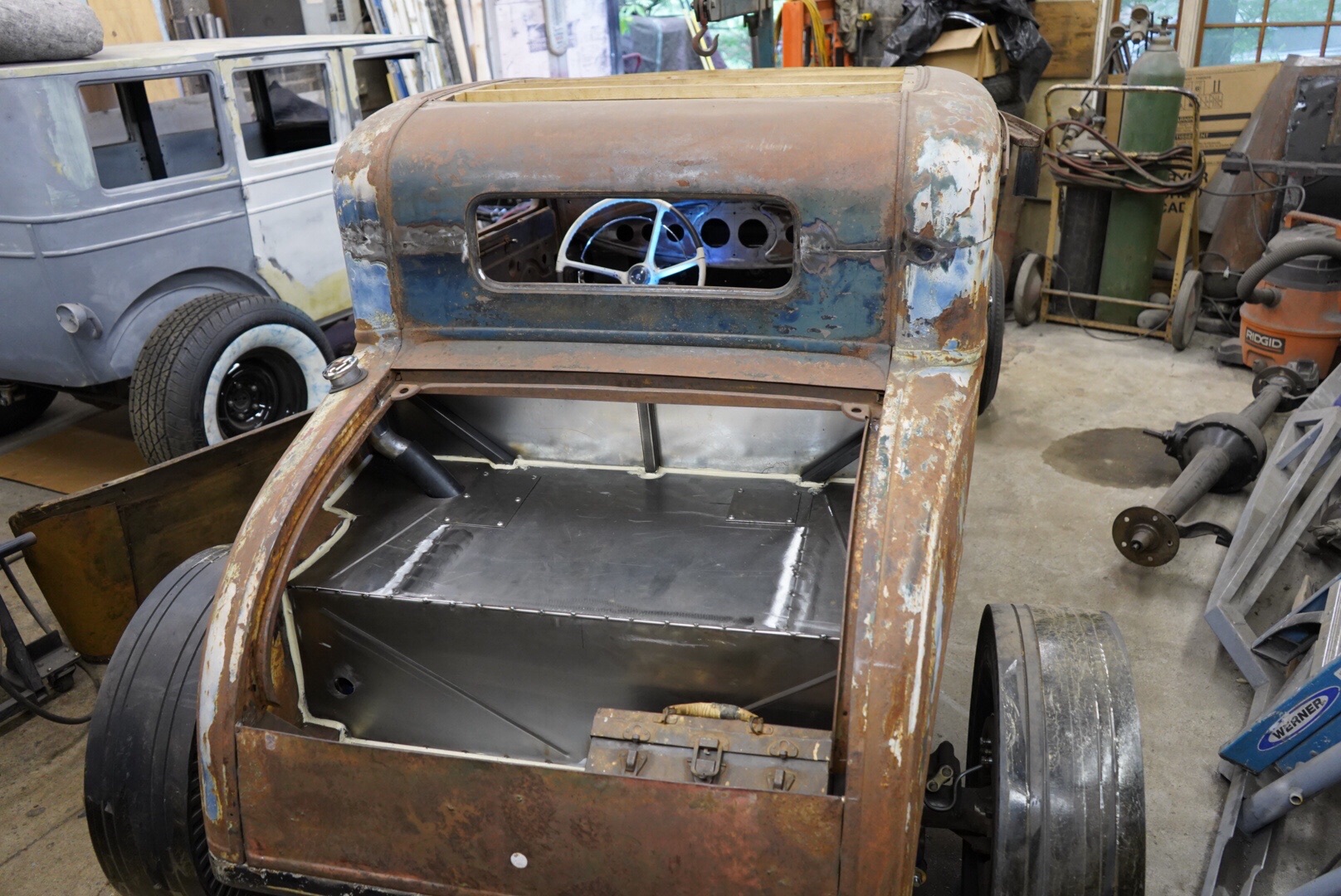

    In addition to the beautiful frame work, the split wishbones, the chop! The gorgeous custom dash, fabbed from the original gas tank, the replacement tank, and plenty more!

    RustEE
    That 3” frame stretch made a big difference in the stance and the 8ba fit pretty nicely.

    RustEE
    Here’s a good shot of the master cylinder @Koz mentioned. And another couple showing the Mallory dual point.

    RustEE
    Earlier in the build…you can see Andy Kohler’s sweet drop axle, drilled w/the @Koz pattern. And the banjo rear located via Koznet.

    That 3" stretch is also kicked up too, right?!
    Does that move the body back 3" or give more room inside the body?
    Will the kick UP give a little rake to the body also?!

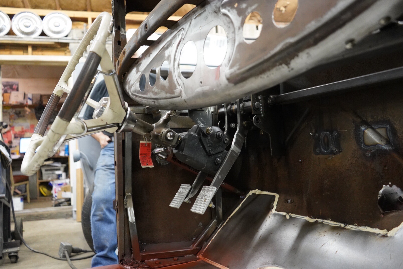

    RustEE
    D16AEABC-9761-4A68-AD0A-8A220B92EC65.jpeg 61B0293E-90D0-41C8-8AE0-C8D16ED56072.jpeg A view of the dash in process and the custom built pedal ***embly

    RustEE

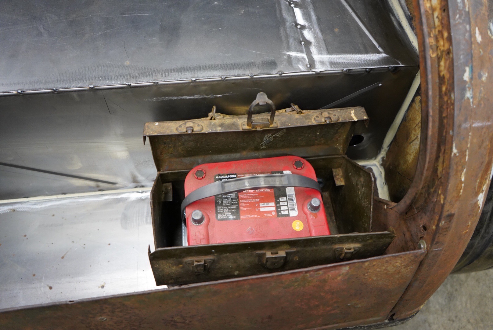

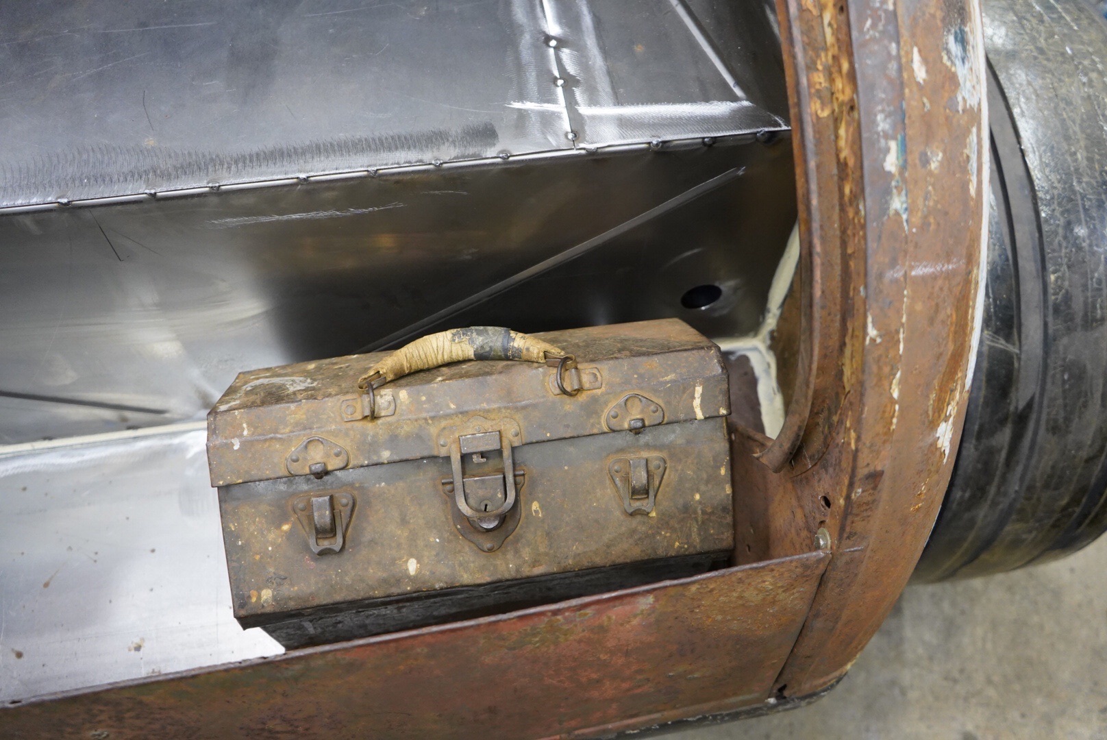

    Some of the trunk work, tank and filler neck and an old Kennedy clamshell toolbox/battery compartment

    RustEE
    Pushed the body back 3” It does kick up slightly and with the Z rear gives a perfect stance. IMHO.

    You can see the subtle rake in some of these shots
