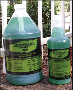

    Depends on which brand and where you buy it but here are the 2 major ones:
    PH-OSPHO-RIC PLUS+ (85% concentration) MSDS
    is sold at home depot
    Ospho (75% concentration) MSDS
    is sold at Ace Harware, Tru Value
    DATA SHEET for Ospho (pretty much the same for PH-OSPHO-RIC PLUS+):

    At Home Depot the product is named:
    Klean-Strip Phosphoric Prep & Etch
