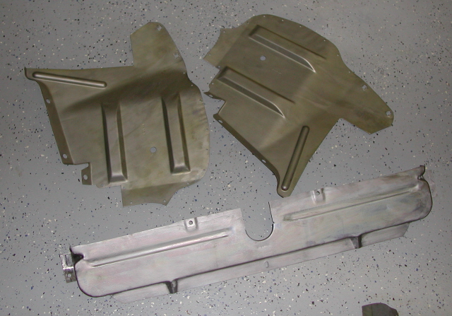

    A few decades ago a painter taught me about using Rustmort as a pre paint rust preventative/treatment. When I learned it was essentially phophoric acid, diluted, with a dye, I just went to using straight (various concentrations, 80-90%) and doing my own dilution based on perceived need. Many folks are using phosphoric acid without knowing it due to their preference for a trade name such as Naval Jelly.
    Over years of use I've made some mistakes and seen some different outcomes, pictures to follow. Yes, use eye protection, well ventilated area, gloves. Water is good to have around for quick dilution if spilled, whether on you or other surfaces. Drops on concrete will end up etching the surface and leaving a white powdery spot if not neutralized.
    I don't find it as good on existing rust that's more than the flash variety without some form of removing the ac***ulated rust; brush, blast, DA, whatever. The sticky, somewhat lumpy residue some have mentioned is a result of not washing off the reactive material soon enough before it dries. Depending on ambient conditions and the amount of rust working on, I'll wash off the working acid coating anywhere from 1-4 hrs, but definately before it dries. If it dries, you'll need to sand off the residue (yes, use some form of repirator, no sense attacking your lungs.....you'll probably live longer than you think and will some day say, "I shoulda........")
    Here are a couple pics of some different outcomes. The model a coupe body I stripped the paint with stripping discs, and applied the acid with a brush within the first couple hours after stripping a side. A few hours later washed with straight, hot water, then dried. The blackish/grayish color is the norm. The deuce ch***is the body is sitting on was treated about 3 years ago. When I got it it was covered with a moderate layer of flash rust so I applied the acid with a red scotchbrite pad. Yep, work fast, the acid eats the pad eventually (may have to switch to that stainless pad mentioned above for longer service). In our somewhat humid climate here in western Wa. St. it's remained rust free for the whole time.
    The splash panels were interesting to me. They are all from a '65 Dodge but are apparently of a differing alloy from one another. All three peices were run through the gl*** bead cabinet to depaint/derust, then coated with the acid, washed/neutralized after about an hour. As you can see, the fender panels got a goldish tone, the under rad panel more of a rainbow gray/red/blue. Similar looking to some plating processes that also use acid.
