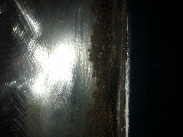

    thank you all for the info and sharing of experiences. I am starting to tackle this and its my first attempt at paint and rust nuetralization and this will be very useful

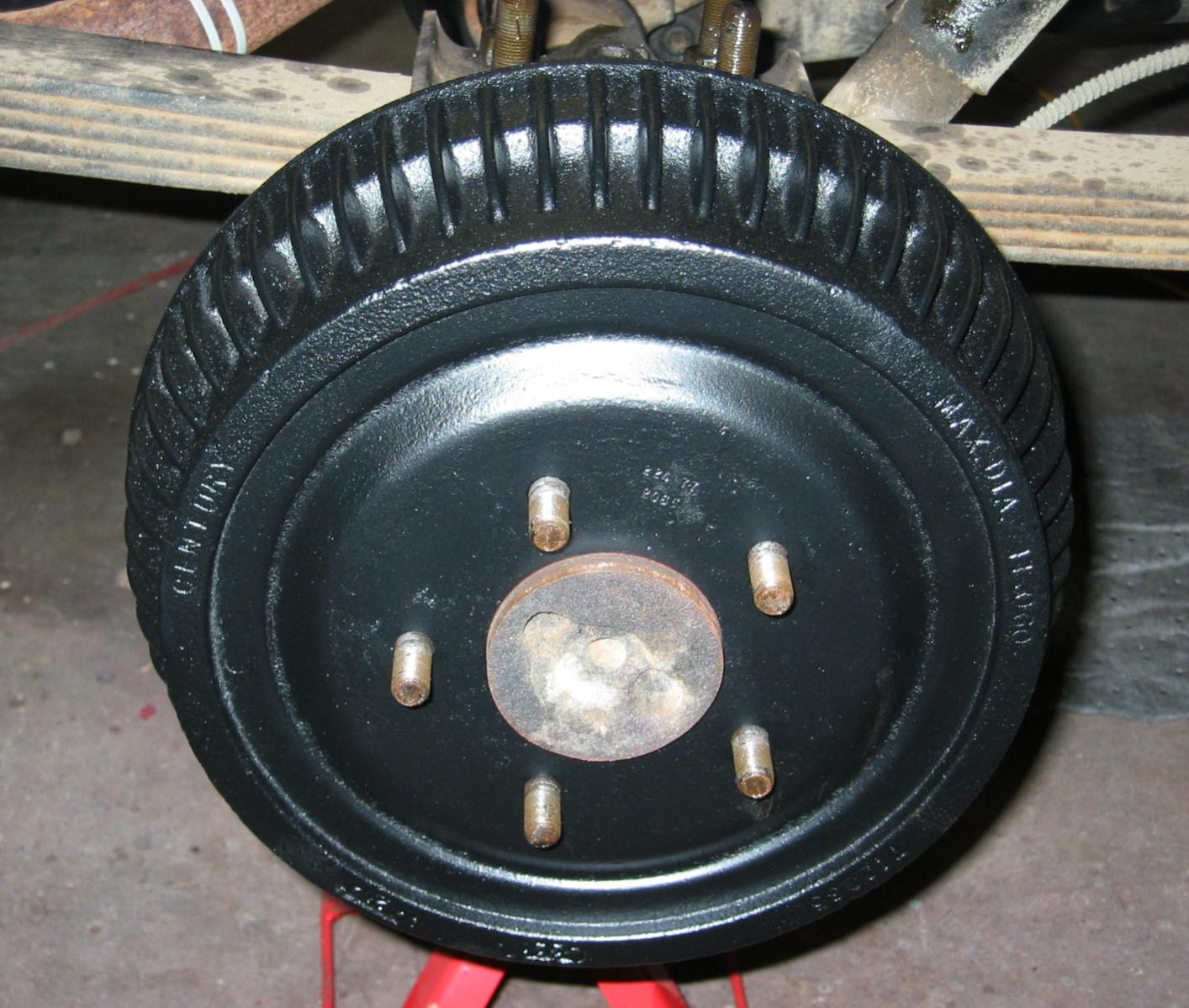

    Bought a gallon of Ospho for about 25 clams at the local Ace hardware. Going to use it to treat the sheet metal on the COE after I remove as much rust as possible first (wire wheel, strip disc etc).
    I did just use it on the rusty rear brake drums just for a test on the COE. Getting 5 spoke wheels so the drums will show. Just used a wire wheel on a fast air-drill-motor quick to get in between the cooling fins.
    Ospho treated it overnight - a little goes a long way, then sprayed 4 or 5 coats of mat black 500 degree engine paint spray bomb. For something I didn't care that much about, really looks good. We will see how it holds up on brake drums. I used the Dupli-kote brand I had on hand, but there are others that might be a better choice like Rust-Oleum.

    Did you soak the drums, and if so did it do anything harmful to the inside wear surface?
  14. 53 COE
    Joined: Oct 8, 2011
    Posts: 688
    53 COE
    from PNW
    No I brushed it on and let it do it's thing and dry overnight.

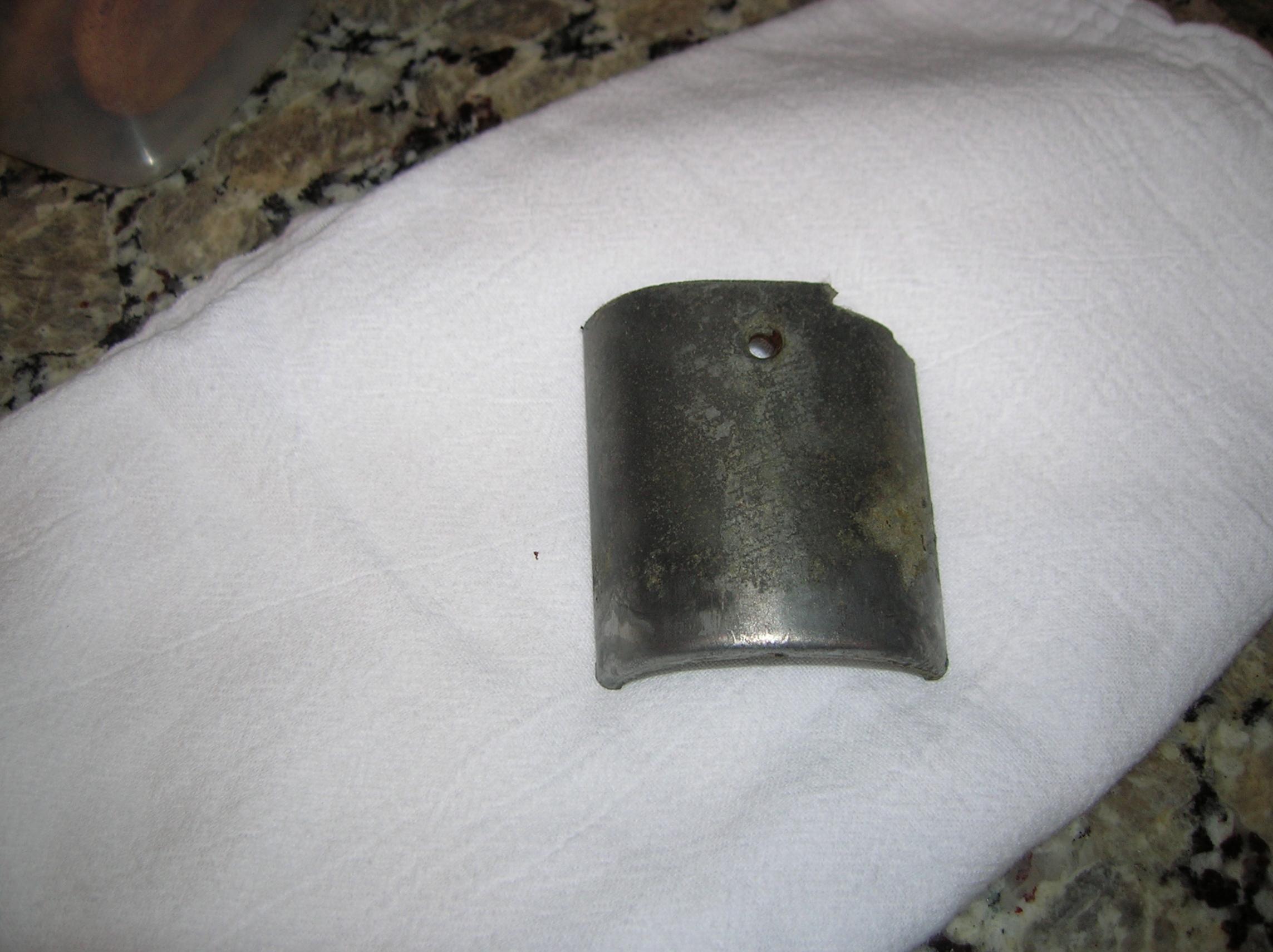

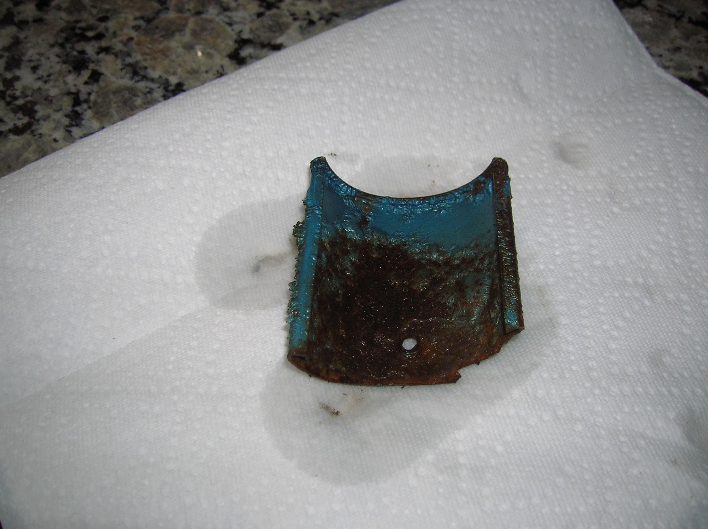

  26. Bruce A Lyke
    Joined: Jun 21, 2009
    Posts: 2,557
    Bruce A Lyke

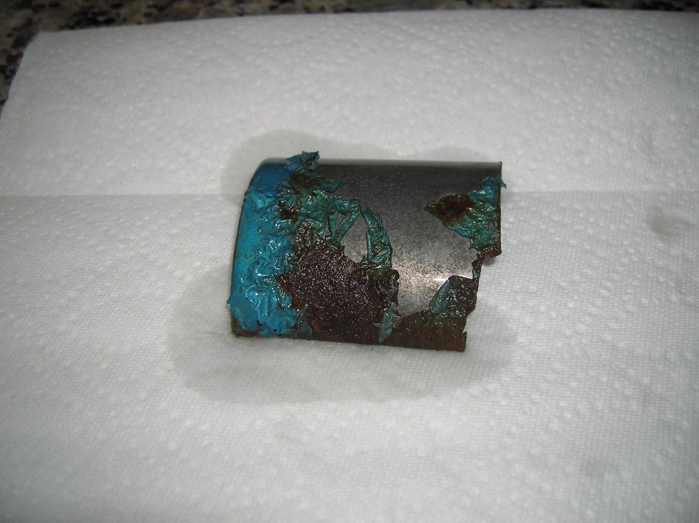

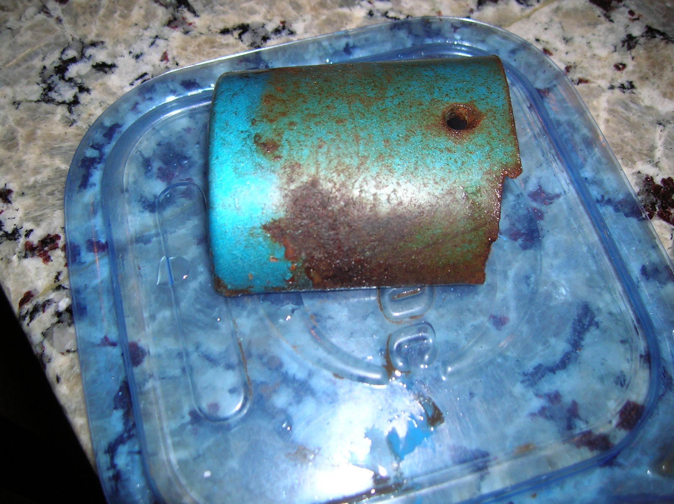

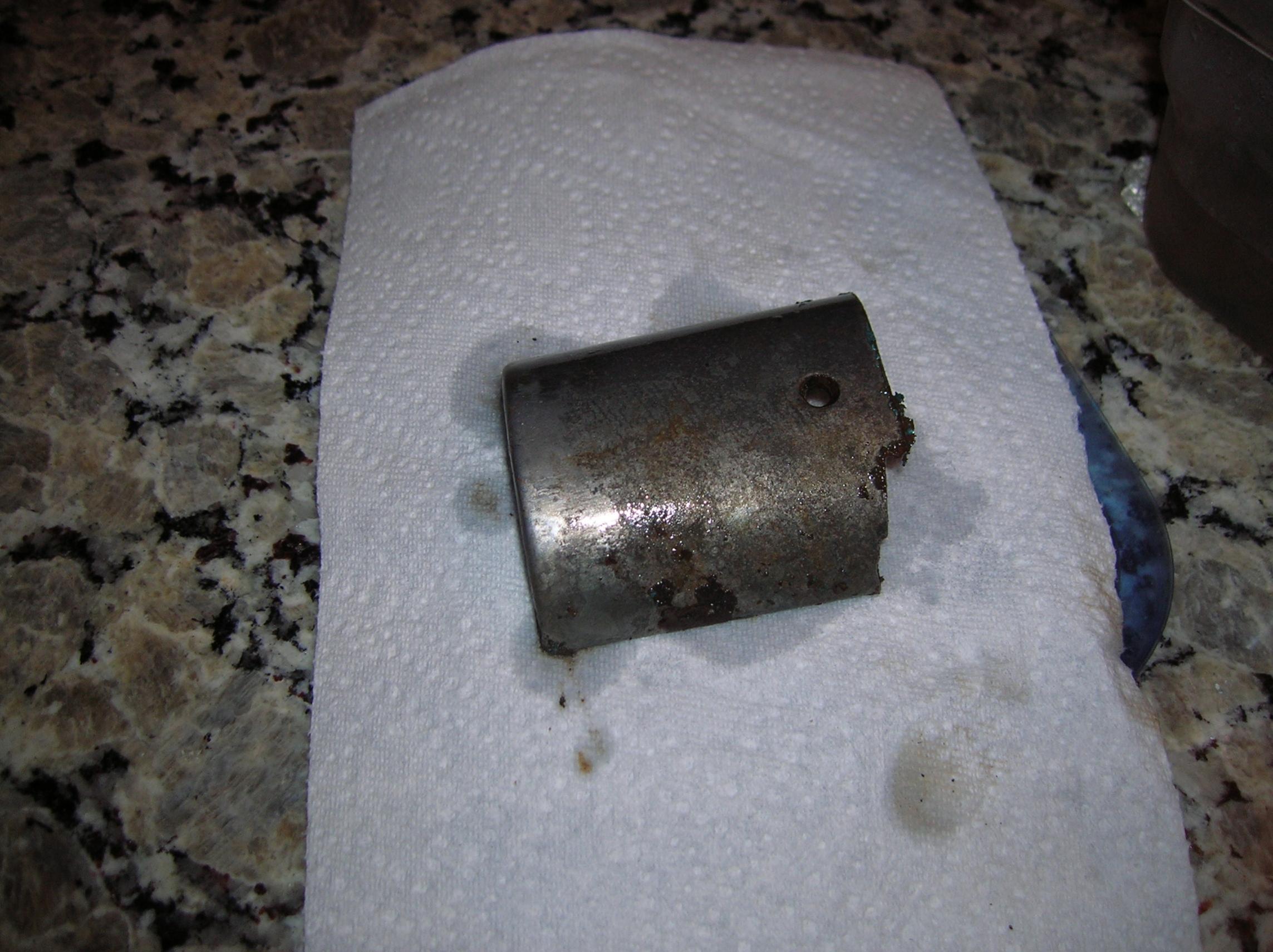

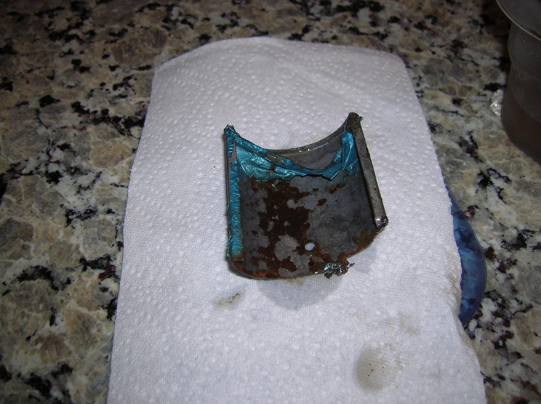

    okay, after following all of this for sometime, i decided to do my own test.
    i was wondering if i could remove the rust and not the paint on some trim.
    here are the pictures of a ~48 hour soak in straight white vinegar.
    i still may use it sometime but only to strip to bare metal.
    i was impressed at eventually even the really hard rust came off.
    i washed it off in warm soapy water and rinsed it in hot then dried it off
    My next step is to keep it sealed up in a zip-lock baggie to see if the rust all comes back.

  28. Bruce A Lyke
    Posts: 2,557
    Bruce A Lyke
    "If it gets painted, don't let the acid dry on the part without you doing something to prepare it for paint. But DO NOT wash it with water and sit it aside."
    Thanks Pete, like i said, mine was just an experiment. Part of it will be to see what happens, as you can see i used a s**** piece, so nothing lost. i was planning on the Mol***es next on a similar s**** item.
