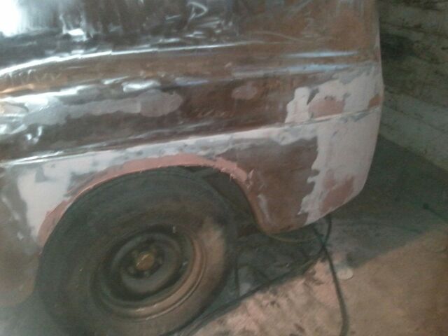

    I am trying to get my panel ready to paint and am going to be using Phosphoric acid to kill the rust that's left after stripping and wire brushing. I have done some fairly extensive repair on the left rear quarter and tailpan and was wondering if the phosphoric acid will have any negative effects on the body putty. And if so can I shoot it with epoxy primer in those areas to protect it and then go with the acid on the rest?

    Bringing this back to the top. My question really is: If I shoot the filler areas with epoxy primer will it protect it from the acid?
