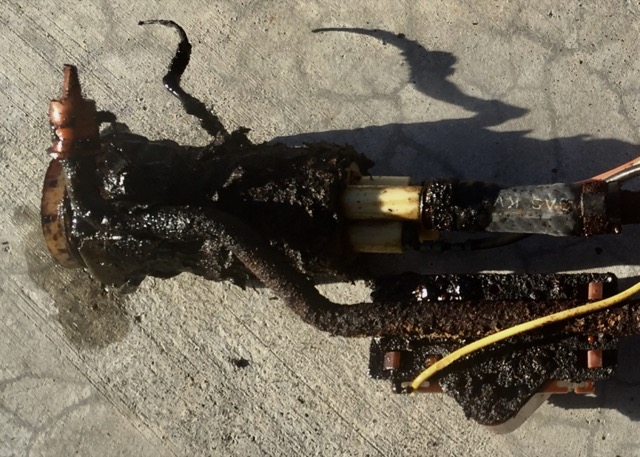

    I had a late model gas tank from a vehicle that had an accumulation of black goo from ethanol fuel residue. I tried different chemicals with no luck. A friend stopped by and told me to use cheap lacquer thinner to dissolve the mess. I did not believe him, although he said he had fixed similar problems with motorcycle tanks. Two days later he came back by the shop and told me again. By that time I was so frustrated I would try anything. In just a few minuets of soaking in the thinner the deposits dissolved and rinsed away. Here is an example of how bad it was. This is the fuel pump and gauge sender from that tank. The tank was just as bad, and it was clean after the soak. It worked for me. 82F6ED1C-2D46-495D-B3AB-A780F5700C89_1_105_c.jpeg

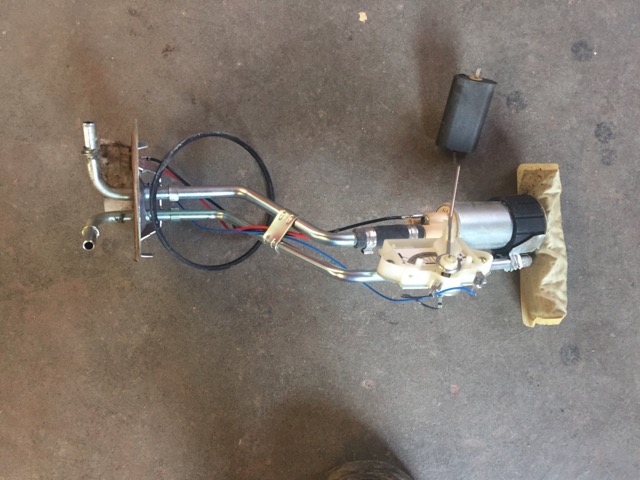

    A could have been after photo. Not really an after picture. I did not clean the pump and sender because I modified this assembly to use an engine that is carbureted and not fuel injected. The tank had large globs of black looking tar like substance that nothing would cut or break up. The lacquer thinner dissolved the black goo. It was same stuff that is shown on the pump and sender in the first photo. 1A80EC31-E3FD-497B-BC38-E53783947C80_1_105_c copy.jpeg
