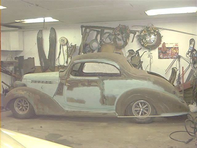

    My buddy has this 36 Terraplane coupe that he is starting on. He is considering turning it into a 3 window much like the style of Cole's 36 Ford, with skirts and the whole 9 yards.
    It has factory suicide doors at the moment and a nifty dash. His dad was a big Hudson/Studebaker collector and would tell you how every thing else of the same era was junk! After seeing the thickness of the metal and the design of the car, I believe it!
    Any help would be greatly appreciated! [​IMG]

    I'd leave it just the way it is but open up those Hudson rear wheel wells a little.

    Seriously, it looks fantastic as is. I wouldn't change it! I would add skirts though... and keep the wheels.

    IMHO, the top's too long to convert it to a 3-window...it'll look like someone tried and fucked it up. Not good.
    Here's what I'd do: Remove the chrome trim on the hood, fill it in solid, build the fender skirts for a flush fit. Lower the headlights down onto the fenders, roll the rear pan under and remove the bumper (s) and fill the holes (if any), wide whites, hubcaps and slam it on the ground...just my nickle's worth.

    I've got a 48 ford three window. I think the most important part was not splitting the roof. what I mean is cut the whole roof loose and move it as a unit when you line up the A-Pillars. Mine moved forward 4 1/2 inches with a 6 inch A-piller cut. keeps the look of the original. I also widened my doors 8 inches and I only had to fill a 4 inch quarter glass. I also had door that are round on the front and square on the back. I took the front of the right window opening and put it on the back of the left door to get the three window look over the filled quarter glass look.

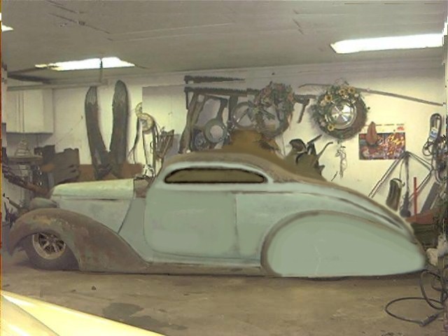

  8. Not familiar with the '36.
    Did you mean hardtop 3 window?
    Please excuse the rough job. Haven't found my photoshop software yet.

    If it was converted to a 3 window, he would move the roof up and maybe lay the rear window down some. Not looking for a hardtop, he would refab the doors to have the window in them like a 36 Ford. I told him to leave it the way it is so as not to screw up the cool suicide doors, but he is just playing at the moment. He works fast though, I wouldn't be suprised if he has it done in time to take it to Goodguys in Indy in June. He is no stranger to metal work. He built this Lincoln out of a 4 door a couple years ago and sold it as soon as he got it done. It is kind of the look he is going for here as well.

    But I don't think it will work too well as a 3 window unless you lengthen the doors (like SoWhat's Photochop) because the turret would have to come way forward, or you'd have to have a too much bulk in the old 1/4 window area.
    I think a mild chop 5 window taildragger works best for it.

    SoWhat, that is pretty much what I was looking for, Thanks!

  20. straykatkustoms
    Joined: Oct 30, 2001
    Posts: 27,183
    straykatkustoms
    This is my quick attempt.
    Happy Trails,
    Mick

  28. Just lowered....Chopped top....(5-6 inches with rear windows filled..opera coupe style)...and some smoothing werk in the rear window to trunk transition....The door lines on this thing are awesome...suicide already...damn!
    Cheers
    MAIKI [​IMG]

    Well, I showed him the pics over the weekend. Straykat's was his favorite along with SoWhat and 60's Style. We'll just have to wait and see what he decides to do. Thanks Guys!

    Mine was very quick and crude but,
    I took the front of the door window opening and flipped it around to use at the back,
    moved the rear of the top forward to give it a little less bulk,
    chopped the top, with the front chopped more than the rear,
    and took some of the crown out of the top to reduce some of the bulk there too.
    it might look good without the skirts, and radius the rear wheel opening to lose some "fat" there too.
