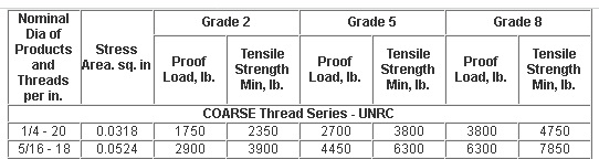

  5. I wouldn't worry about the grade of the bolts. Even using 1/4" bolts, the shear strength of EACH bolt is 4468# grade 8 and 3683# grade 5. As far as threads, I think the aluminum threads would fail before the steel.

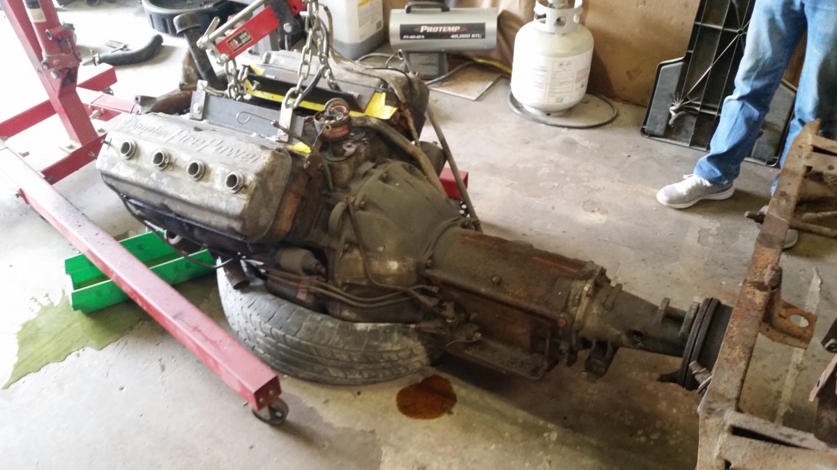

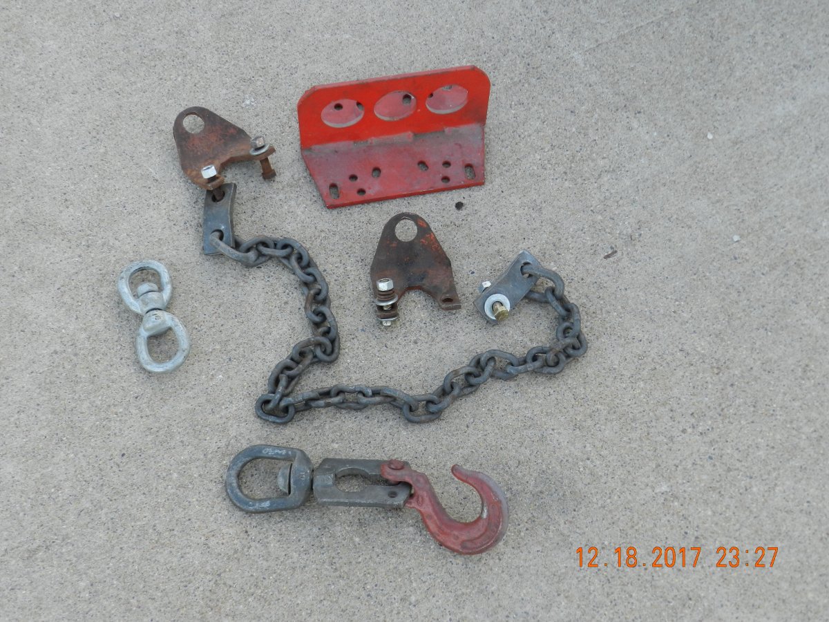

    If ya do this on a regular basis you'll need ---> an we have an electric hoist too.

    Add 4x momentary stress load to your numbers when you get that jounce from the engine breaking free from the motor mounts and/or trans. Also, sand cast aluminum does not equal A356-T6 (which you seem to be making some kind of reference to in your second chart, though I don't quite understand its relevance).
    The failure mode is pretty aggressive. One aluminum thread collapses, causing a small jounce on the other threads in the same hole. They collapse and fail, throwing the full load on the remailing 3 holes, with unequal distribution on the 2 holes to either corner of the failed hole. Because of the small rotation that occurs, the new load on the remailing holes is only partly in tension, with the rest in bending. The bending load tears out threads in these 2 holes, causing failure. Finally, all load goes to the last remaining hole, which is instantly hit with stoll more tention and bend loads. Then the last hole fails and you lose a foot, or maybe just an oil pan and pickup.
    Having said that, I wouldn't be too worried about lifting an engine only so long as (as several have said) threads are good and bolts are snug. Watch your toes and set it down quickly.
