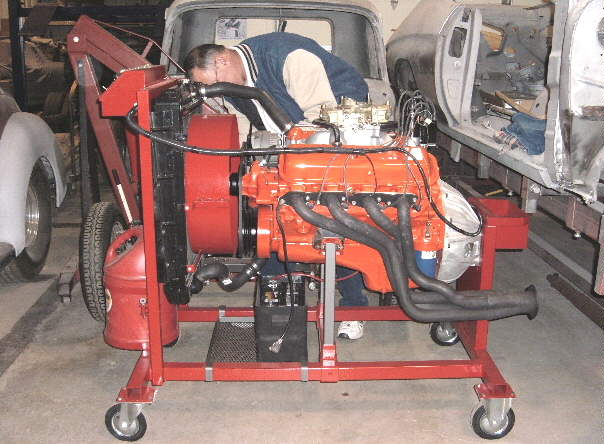

    I built mine with what I had for what I had,
    I wanted it to have a radiator with electric fan,
    electric fuel pump, oil pressure and water temp gauges,
    a battery and ignition switch, and have it on wheels so I could move it around easily.
    if it needs to be altered for another motor it would be easy enough
    just cut grind weld..
