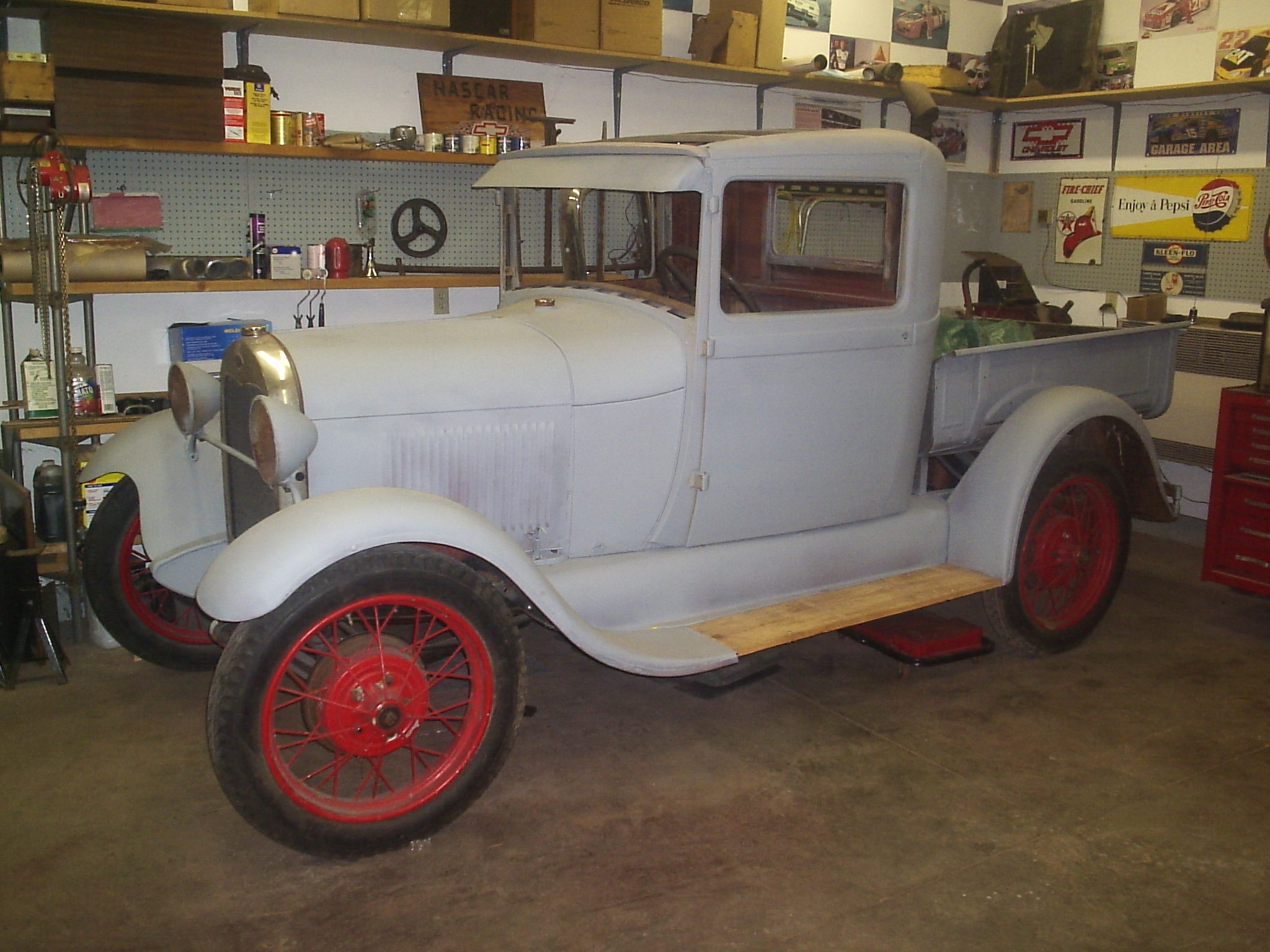

  5. I built my roadster pickup from a 2 door sedan, using the sedan doors with the top cut off,moved the rear up to just behind the doors, and built my own box. The doors in their stock form as I used them are 29" long. Henrys stock roadster pickups and pickup trucks are a very short cab section, too short for anyone over 5"-8" or about 130 pounds. I built my cab section to be 6" longer than stock, and it is quite comfortable. My roadster pickup measures 39" from the upper dash-rail to the rear of the ****pit at the center of the body, and 54" at its widest point on the body, just behind the doors. If you want to see more pictures, I currently have a post running on this forum "how I make a carson style roadster top", and it has a picture of me setting in the car.
    brianrupnow has attached this image:
    http://www.clubhotrod.com/forums/attachment.php?s=&postid=169430

    Wasn't expecting to see this post active again... COOL! That friggin RPU is awesome! NICE JOB!!
    Funny this thread is coming back now. I've got another thread going on the Sedan I'm thinking of buying and chopping up...
  7. Hey Scootermcrad---thanks a heap. ----Brian
