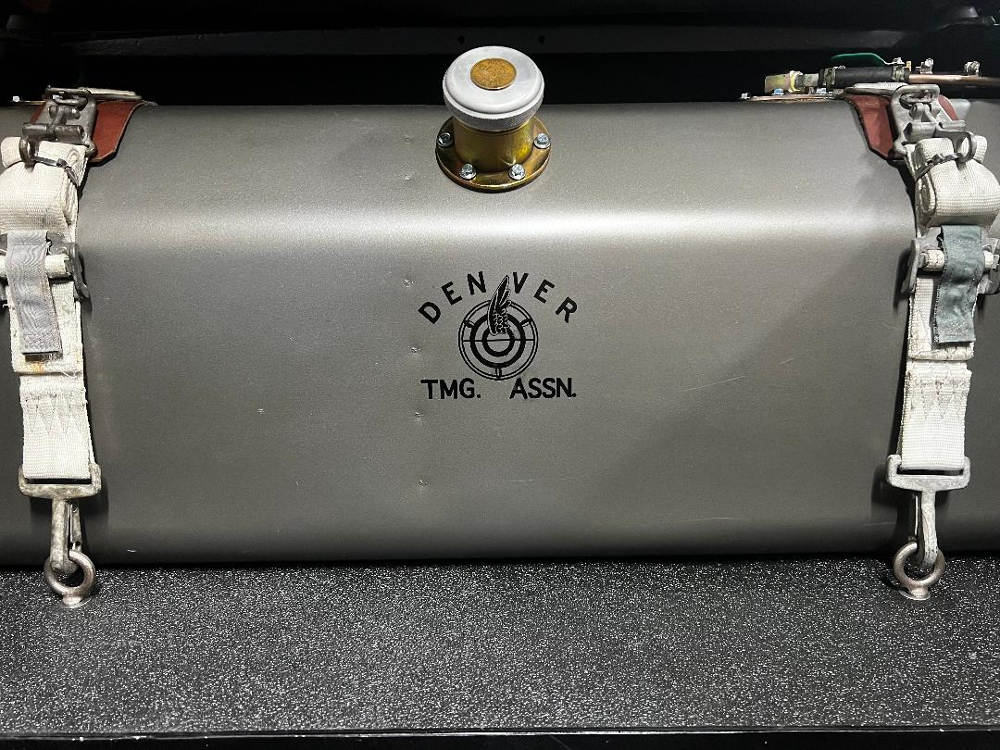

    When we moved on from our drag racing adventures, we started surfing, but still delved into desert motorcycle racing. My brother and his friend started in the 250cc Novice cl*** and they had a trailer to take the bikes out to the desert. At one time, we used the trailer behind the 58 Impala. That was enough, as it no longer looked black when the weekend event was finished.

    But, by the time I sold my Flathead Sedan Delivery and went away to college, I had a new 327 powered red El Camino for transportation. We installed 4 small u-bolts in each corner as low as possible. We had to check out the insertion point to make sure we could use a wrench and not hinder anything underneath the inner body panels. These were available at our local neighborhood hardware store and no other ones were available anywhere.
    The u-bolts had to be high enough to use a rubber coated “S” clip end to hook on the bike and to the bed.
    The one thing we wanted was to have them low enough so we could use any length rope or nylon straps.

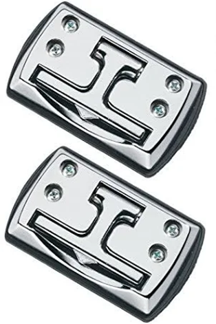

    Right after we sold the bikes and the El Camino, we found this surface attachment that would have solved every bump an bruise on our ankles or legs.
    It was a one of a kind flat attachment to the side of the inner wall of the El Camino bed.
    Each “T” hook came out to do its job, then when finished and the bed was empty, neatly flipped back into its plate. It was fairly flat so no bumps or bruises would occur. My friend, who bought a newer El Camino the following year installed these in his empty bed. They were chromed and looked like a factory option. After we used the flip out hooks, they neatly went back into the flat mode.

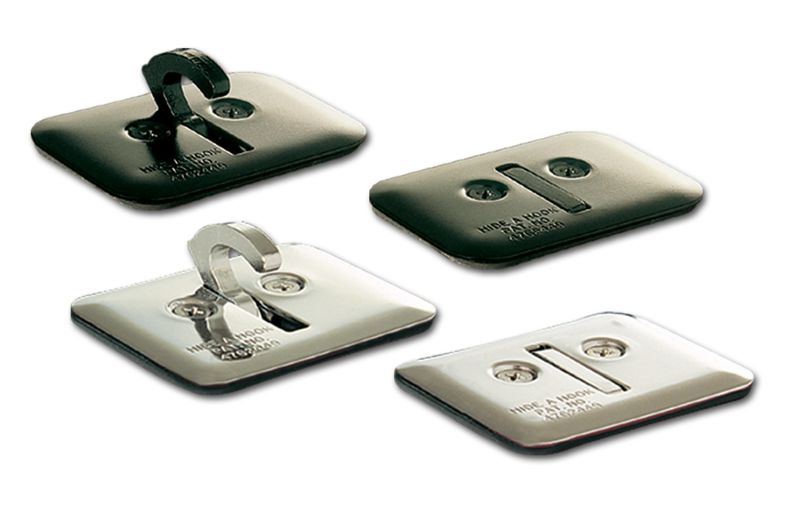

    I am installing an oak bed in my 41 right now and I wanted tie downs as well. I found these stainless steel hinged tie downs on line, they have a spring to keep them from rattling when not in use. I sunk 4 of them into the outer boards with a router so they would be flush.
    I do plan to give them a trip across the buffer prior to install.

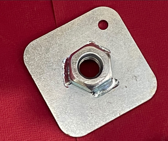

    I use eye-bolts for the 6 point harness in my race cars [they must be 7/16 UNF for our regulations]
    This is up to FIA homologation specs
    On the underside I glued a plate with a captive nut [these are available over the counter in NZ for seatbelt compliance]
    Our seatbelt regulations require 30 square cm , so you can get them rectangle or square shaped to fit the contour of the floor.
    The Glue I used is "Bostik ISR 70-03" that is crazy strong [so you don't need to do any welding]
    If not being used, simply remove the eye-bolts and install a ****on head cap screw in the hole

    Sorry I wrote 30 cm sq it should have meant 30 sq cm
    Our regulations were 30 sq cm [area]
    That is 5.5cm x 5.5 cm [55mm x 55mm] or approx 2-1/8" x 2-1/8"
    In the pillars of my 57 Chevy the anchors are 35mm x 90mm [3.5 x 9cm] so it still has a slightly larger area.
    These are our Transport rules [you can go larger if you want]
    They stipulate a 10mm [1cm] radius on the corners to prevent tearing the parent material.
    these are the upper pillar plates for my 57 Chevy [the riveted screws are sacrificial, and are to screw curtain wire to it to drag them up inside the pillar
    They were plug welded on the pillars
    On a pickup bed [or trailer] I would use glue, it is much stronger
