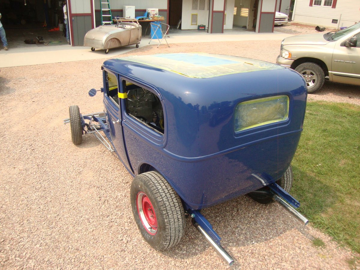

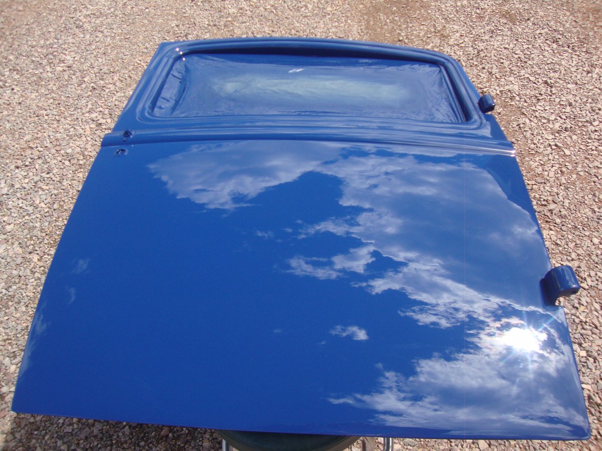

    Hung the doors today and rolled her out in the sunlight. All I can is shhhhwinggggg!!!!!!!!! DSC03088.JPG DSC03093.JPG DSC03095.JPG DSC03098.JPG DSC03086.JPG

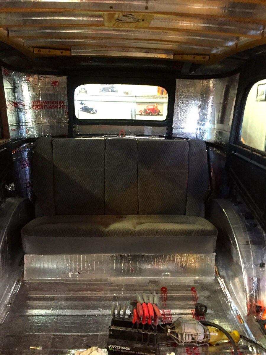

    Just a bit of progress on the sedan. Ive started pulling wires, got my caravan rear seat bolted down and the majority of the gl*** installed. IMG_0087.jpg IMG_0091.jpg IMG_0093.jpg

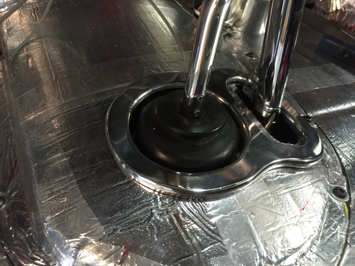

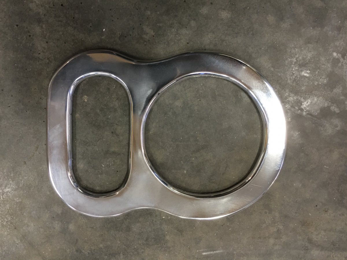

    This was yesterdays project on the sedan. I cut this bezel out of a piece of 1/4" alum. I used my router with a carbide round over bit on the edges and then sanded and sanded and sanded. I milled the back side around the holes so the trim guy can glue a boot to it. I bent it to form around the trans tunnel and drilled the mounting holes and now all thats left is to give it a final polish. IMG_0096.jpg IMG_0100.JPG IMG_0102.jpg

    Beautiful work,well worth the time spent. HRP
