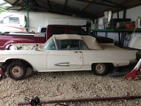

    Bought this from the Original owner today over in East Texas. 59 Bird. Power Windows, AC 90-thousand miles, automatic. Surface rust only. All there. Now the bad news, he started to rebuild the 352 engine himself with son and quit. Said he lost patience with the kid and the kid lost interest. (This guys knows his stuff as his Dad owned a shop and he worked for him as a kid.)
    Engine out of car, small parts are labeled in baggies. Everything is there. He has several NOS parts he purchased for his home rebuild. Engine did turn over (with the help of a crowbar lol)
    You guys got a DFW Engine guy/shop you recommend to put it back together?
    Someone suggested City Motor Supply?
    Thanks.

    Unless you are determined to keep the original engine, probably cheapest and easiest to find a good running 390 and drop that in. 352 is an FE engine, so any FE can swap. 390 are popular and a good engine.

    A lot of my T-Bird friends say buy a good running 390 to drop in there. I talked to City Motors in Dallas, 14-hundred for a reubuild. I figure I can buy a 390 for that..

    You should be able to get a good 390 for less than $1,400. But if you can rebuild the 352 for $1,400 (frankly, that sounds too cheap to me) I'd much rather have a freshly rebuilt engine.

    $1400 is cheap, if you can really get it done for that, it'd be worth hanging onto the original motor. But me personally, I'd go looking for a good running 352 to swap in. 352's are somewhat unloved by Ford performance guys and I'm sure it's different in Texas but you could find a good useable one around here for $200-$400 if you looked around.
    If you do a swap, keep the original stuff around in case you sell the car to someone who wants it.

    try Charles at Tinkers here in Dallas....he did the Scorpian I clone's last 392 Hemi engine for Don Ross
    look out on those 390 engines - they changed the motor mount at some point from 2 to 3 bolts I think....

    get the 352 rebuilt, that way you can keep it stock for a restoration if you want.

    For $1400 I would rebuild. You have a fresh motor rather than saveing money by useing a used motor. Plus it is a Low mile convert. If you are going to resale bird people would want the stock motor. If you are going to keep for a long time then do what you want. Either way you go have fun with it. I'm doing some restoratiuon work on my neighbors 59 Bird for him. It is a cool car.

  24. The 58 thru 64 FEs had 2 motor mount bolt holes per side, starting in 65, the blocks came with 4 bolt holes, but the older pattern is still there, so you can bolt the early mounts to a later block, The problem is trying to install the later 5 bolt mounts to an early block. No issue in this case. To retain the generator, when using a later FE engine,you will need to re use the early style water pump, or modify the later pump to accept the generator bracket.
