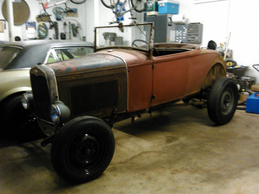

Projects Picked up a 31 A roadster project
Discussion in 'Traditional Hot Rods' started by Barillaro Speed Emporium, Oct 26, 2013.

  2. From what I read a stock T spring may do the trick. I was going to pull a few leafs out of the pack and get the main reversed. Still trying to decide the best route to go. Thanks!

    I reversed the A spring in my 29 roadster it dropped it one inch, but
    it made it ride really hard. Put a T spring in it, ride is nice and it came
    down about two inches.
  5. Thanks for the info, my next step is to get the rear suspension apart.

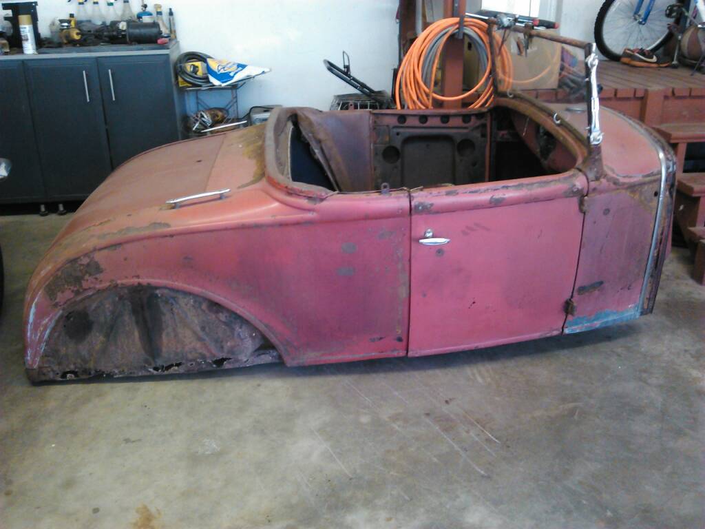

  12. Raised the body up this past weekend and took the splash aprons off. Torn on running with or without them. Also picked up a nice complete 32' ch***is. Now I'm really torn.

  16. Yeah, I think it looks pretty cool on the A frame. I tried buying the 32' frame a year ago and it never worked out until now. I'm gonna save the 32' frame for another project and continue on the direction I was going. Thanks for the input guys.

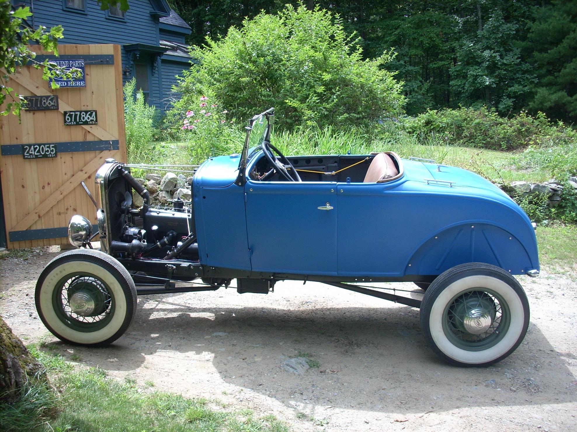

    Simple- keep this one on the stock frame with the banger motor and get ANOTHER one for a flattie.I got a stock project car a couple of years ago and rebuilt it that way. I am having another motor done for it (4 cyl.) but it's "souped" a bit; some upgrades on the valves, pressurized oiling system, split "Red's" header, and a dual Zephyr intake with 2 97's. Car is fun to drive around the back roads now, but motor needs "freshening so I bought a second banger to "hot rod" THEN I bought a pair of 30-31 roadster rear quarters at a flea market, and started collecting parts for a second car (the rule of two)I've got a re-built 327 with a Powerglide and a 10 bolt posi rear for car #2. Just finishing up a coupe with a flat motor now, so into another project next fall(???) Good luck with yer new rig, it looks like a sweetheart. Mike from M***.
  18. Thanks Mike, love your blue roadster!
  19. Decided to take the body off and clean up the frame and suspension parts while I had the engine and trans out. I am going to go through everything and make the underside of the car sanitary but leave the body as is for now.
    Really need a bigger garage at home, things are getting snug but I couldn't have all this fun if I spend the money on the garage!

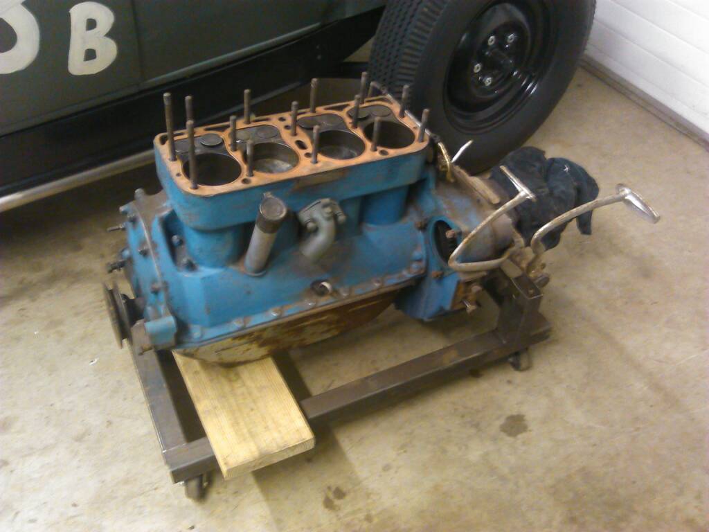

  27. Got a good snow storm coming in right now. Hopefully a good reason to get my *** in gear and work on the engine for the 31'.

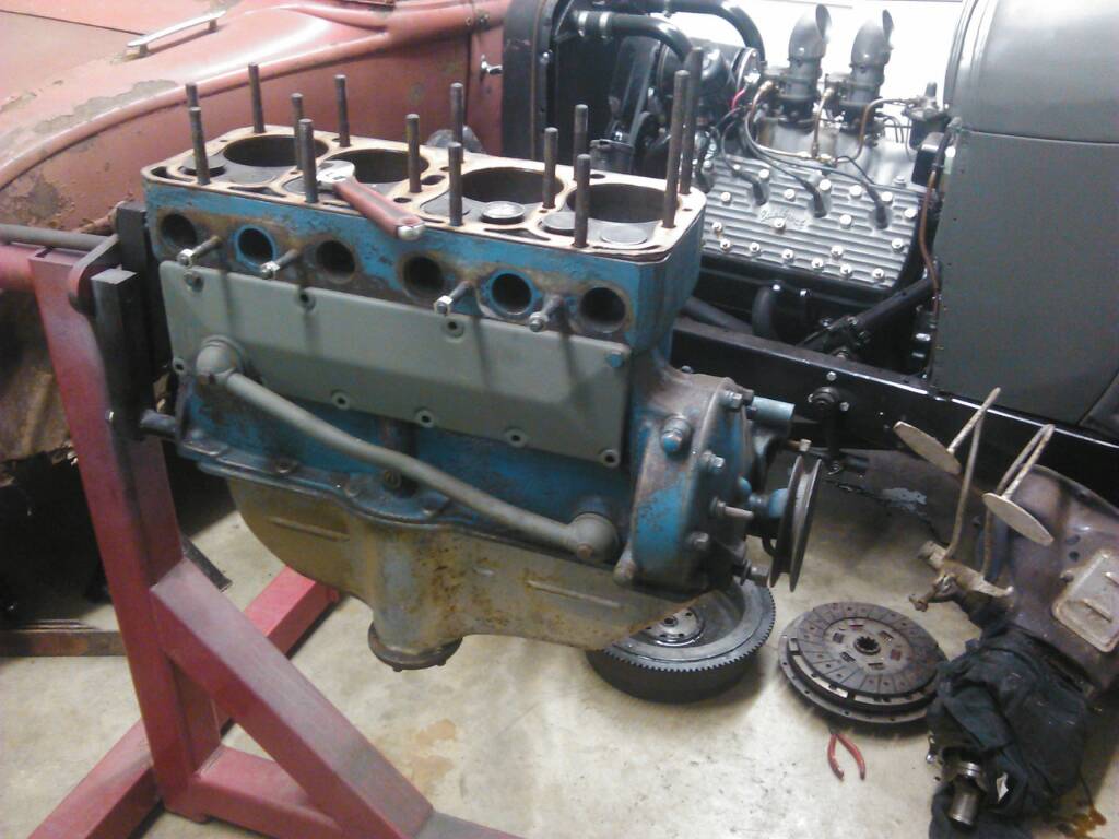

  28. Engine is in the stand, time to blow it apart.

    Man how do you work in such cramped quarters with all that junk in the way, you really should get rid of all those old cars you have sitting around in there! Looks great! Any big plans for the 4 holer
