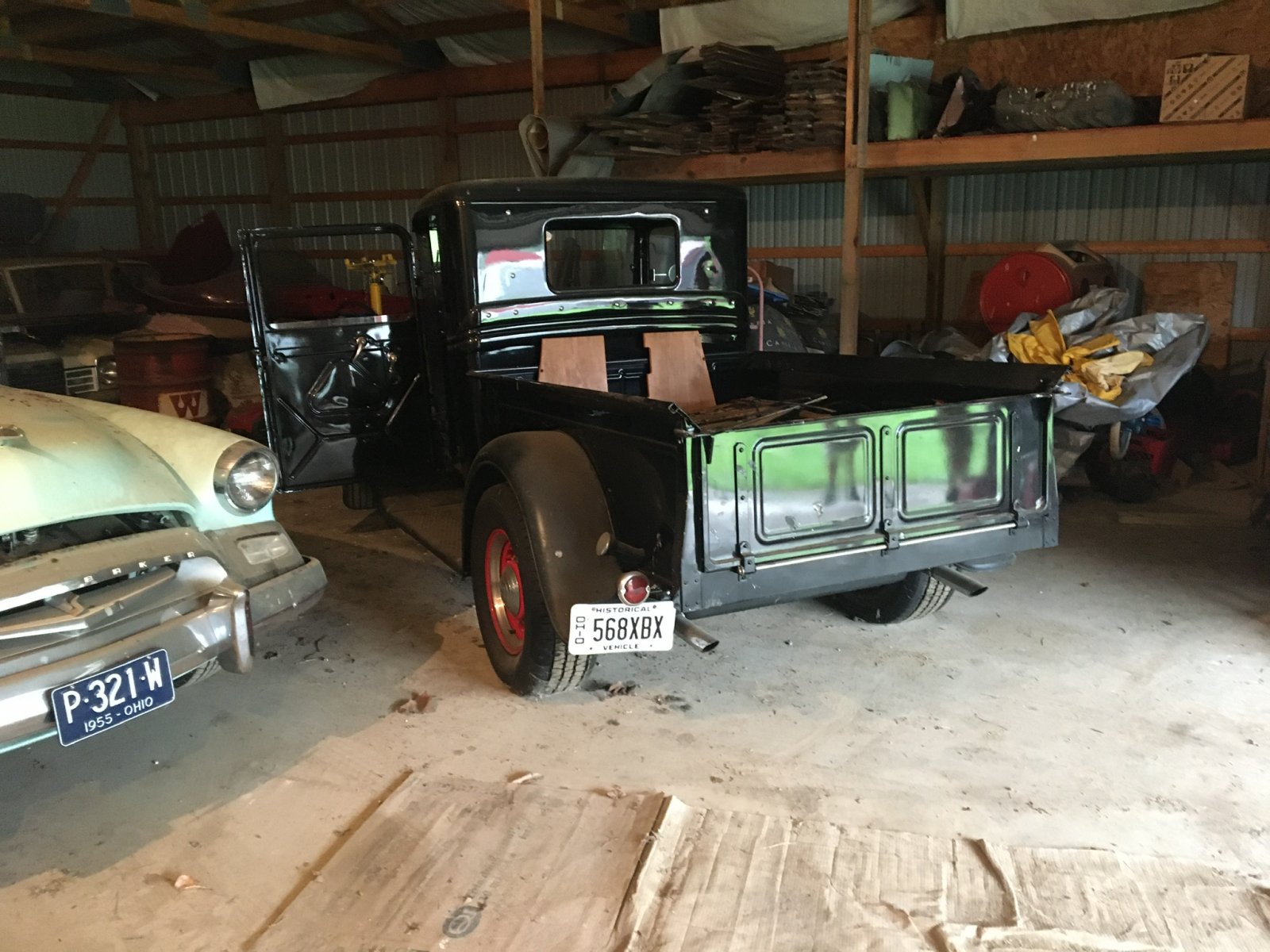

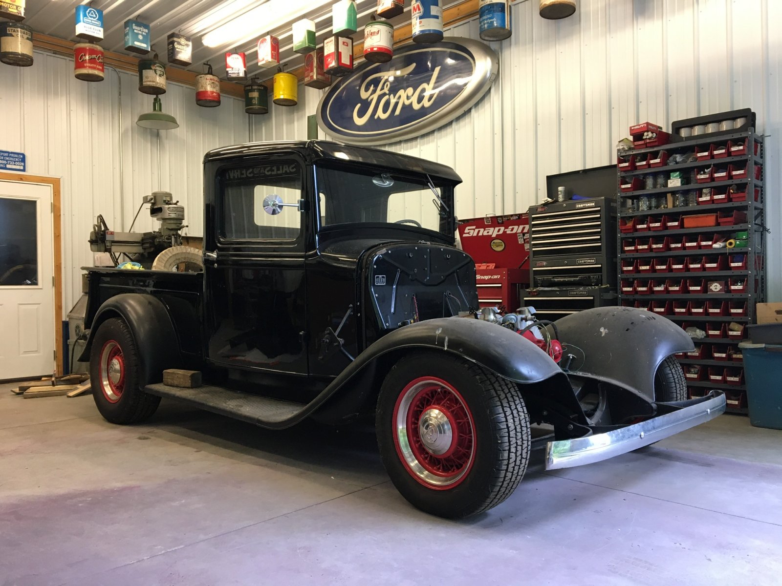

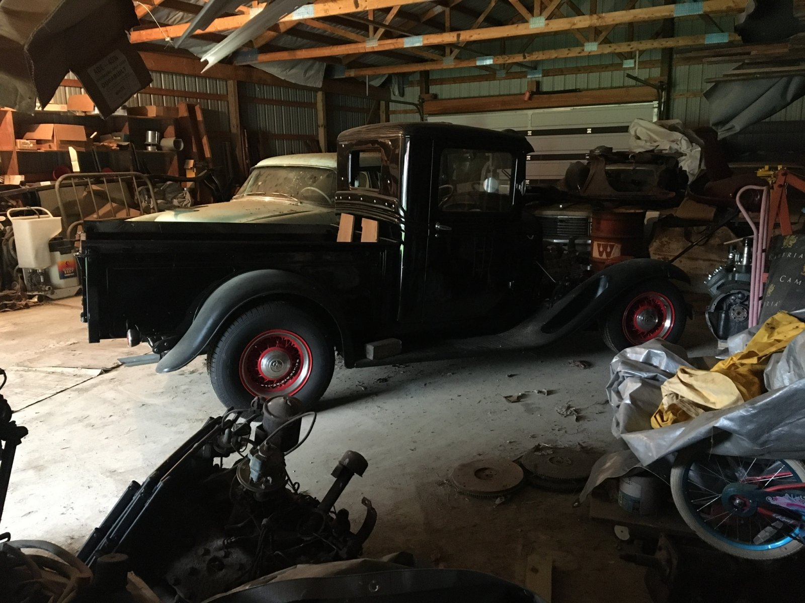

    Didn’t need it at all but the old buddy I bought the roadster pickup off of has been having some health issues.. with that he came to the conclusion that he is not going to get to some things.
    i stopped by their afternoon coffee Spot a few weeks ago while test driving the 32 I had just got done rebuilding the motor for..
    during that time a guy asked him “so your going to sell your 34” he quickly replied yes..
    he had priced it to him before but way high and he told me it was cause he didn’t want to sell it..
    we walked out side to look at the motor before he left I asked are you seriously selling your 34.. he said “yep I’ll never get it done, why you interested?” When I said I was he just said well we’ll talk and I won’t tell anyone else about it..
    went to look at it since I forgot what it really looked like.. after a short conversation we agreed on a price.. Had to sell some things to come up with the rest of the money so the quickest thing I knew that would sell would be the signs I had collected over the last 10 years or so..
    So called a few guys I’ve dealt signs with over the years and raised the money plus a little..
    couple days after that we got together and I brought it home

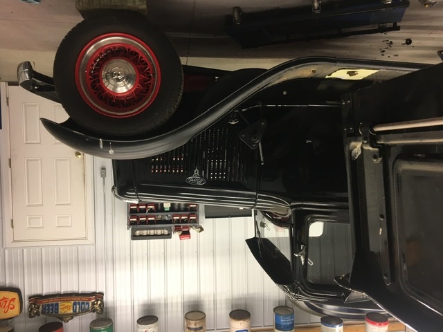

    EB33F6B2-3115-4F46-AE91-070BB0E6938E.jpeg 209EEE08-A1F3-4A4E-AD0B-8870DC4290FB.jpeg 92D44EBD-C760-4B78-A7B8-B541077CFDF1.jpeg 02A9D4F6-606E-409C-9BAD-E3F5AD4D9621.jpeg 4A241F66-F026-48B0-AEE5-53DFE6100CF7.jpeg C42910A5-72B3-44E0-8C98-00A747C0664A.jpeg A4E104E1-06CC-4799-973B-7A38E3C22A8A.jpeg FB15886F-17C5-47D4-9C62-0A66CEB432C6.jpeg
    Story with it is the old buddy that got me into old cars and built the 32 I have now had painted it for him and ***embled it. Turned out the motor that he had for it was bad and he took it home and parked it for probably 15-20 years.
    year or so ago he had another buddy out a rebuilt motor in it.. took it home and parked it again..
    going to get the motor running first and start in the brake system and probably make a few changes.. I have no idea what the master cylinder is or what the shoes look like.
    pulled the intake and heads to check the valves and clean the heads up.. he was honest in saying it never had ran.. the motor was stuck very lightly so I mixed up some ATF and acetone.. after a little bit it came loose..
    Will wipe the cylinders with oil and get the valves done..
    then I’ll figure out a carb and new ignition system for it..
    Wanted a closed cab pickup for awhile and I couldn’t think of a better one to have then one my friends had and put together

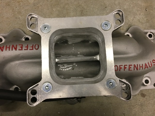

    Thanks! Yes it is a 4 barrel intake. I believe it’s one I actually traded him for the 3x2 intake I used on my roadster pickup.. which has found to be a little difficult finding a square pattern carb

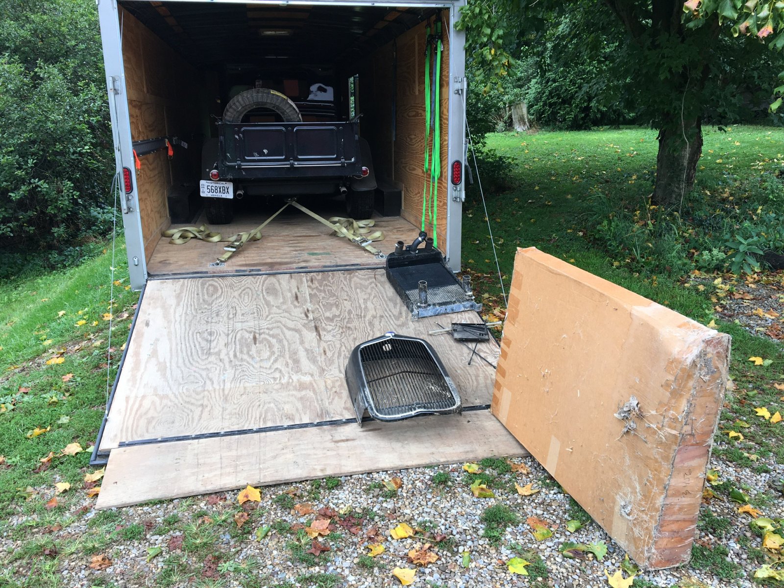

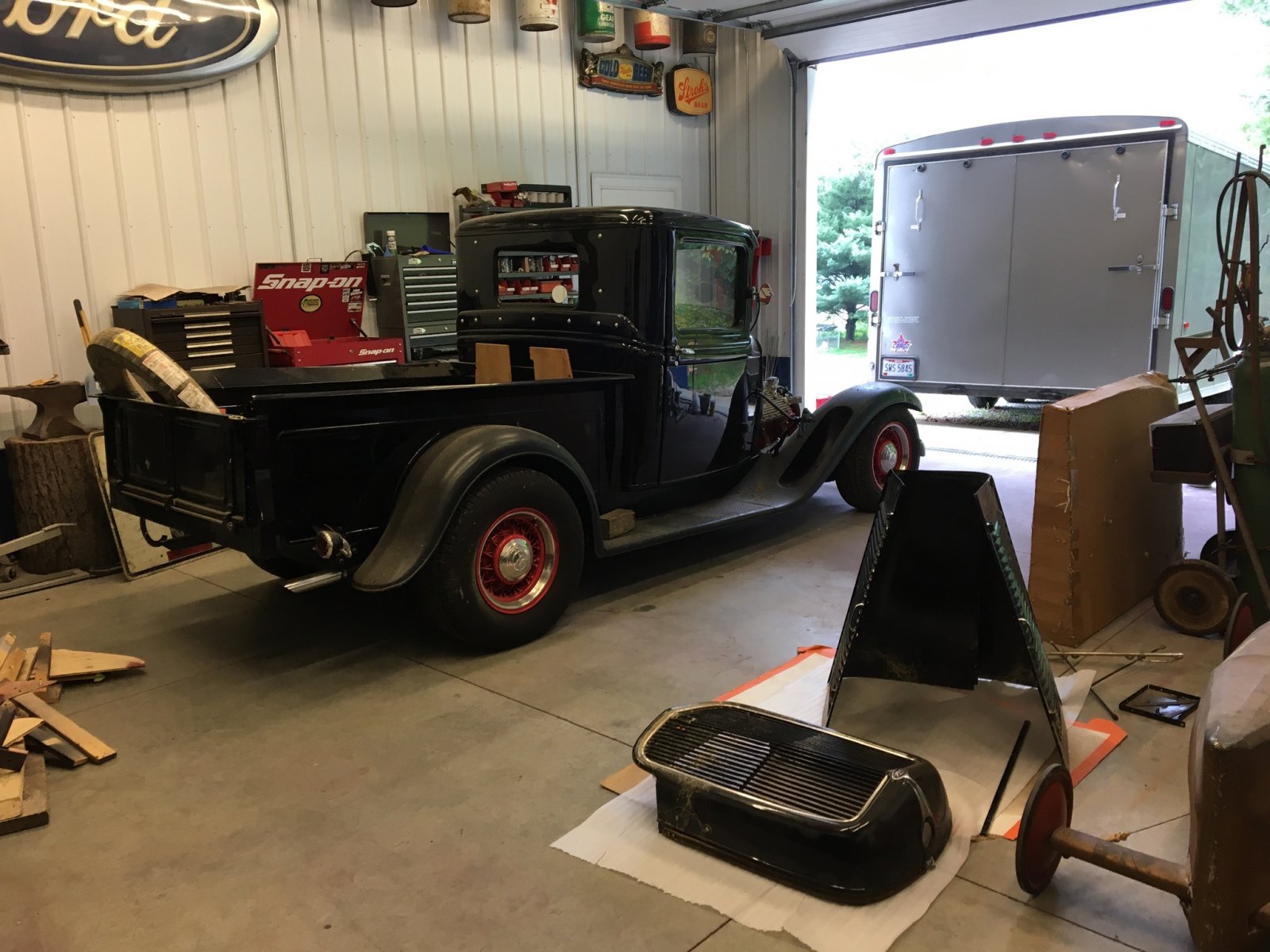

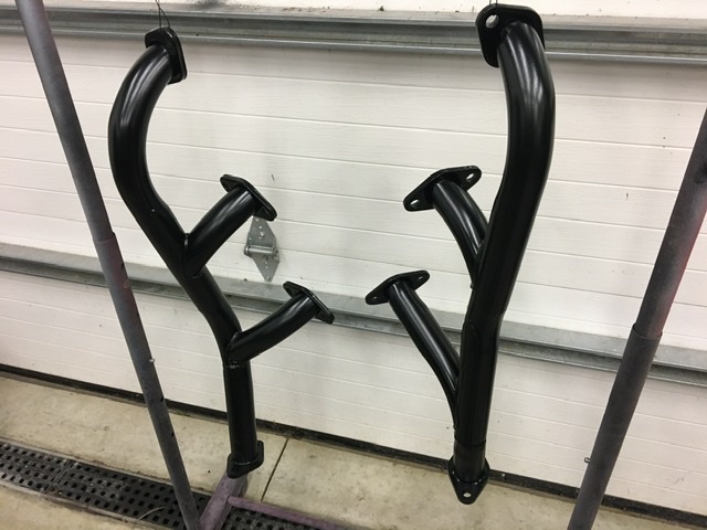

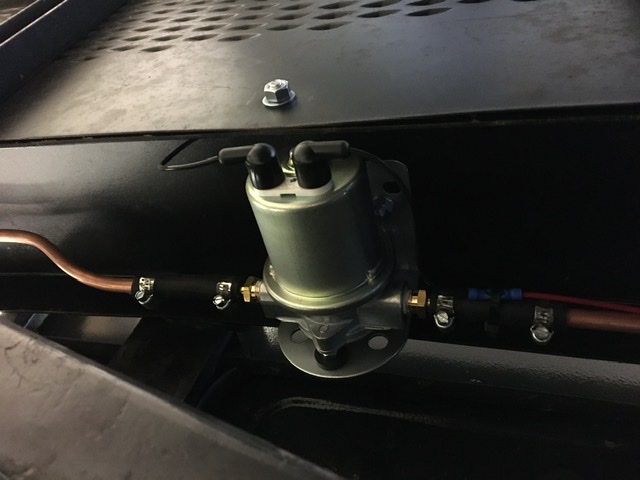

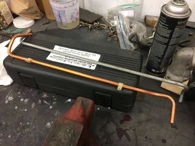

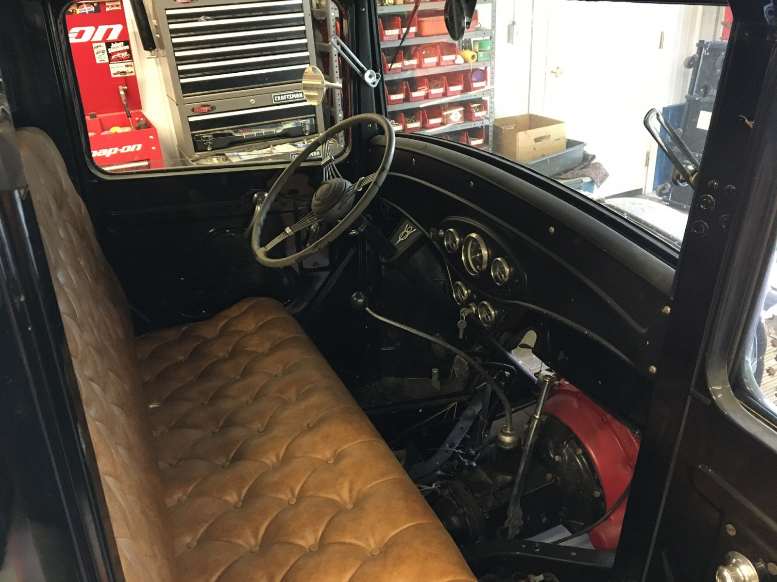

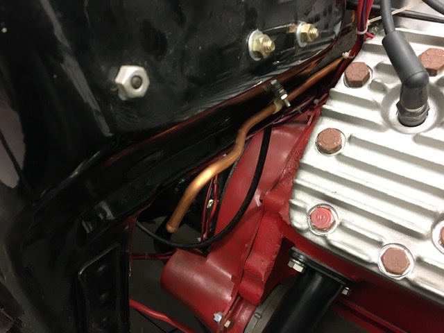

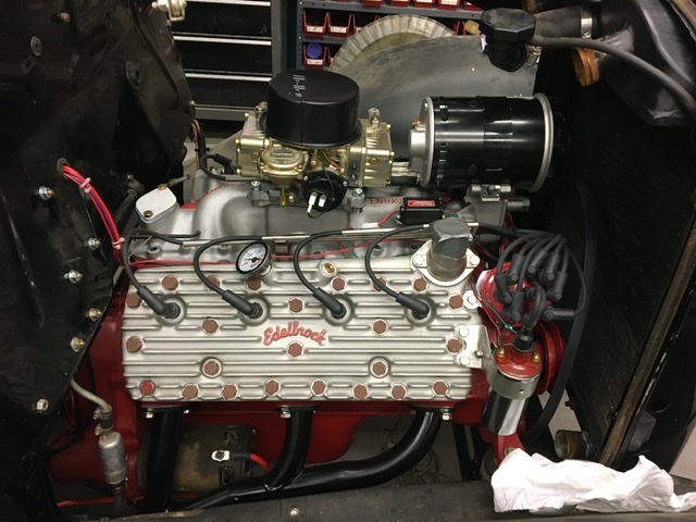

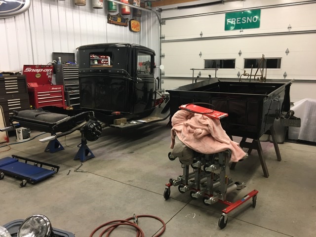

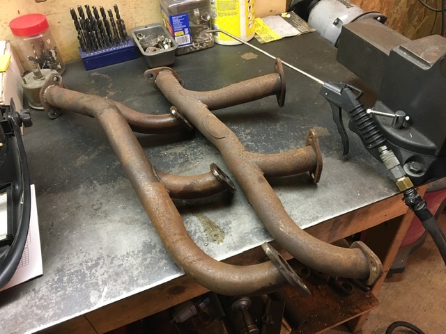

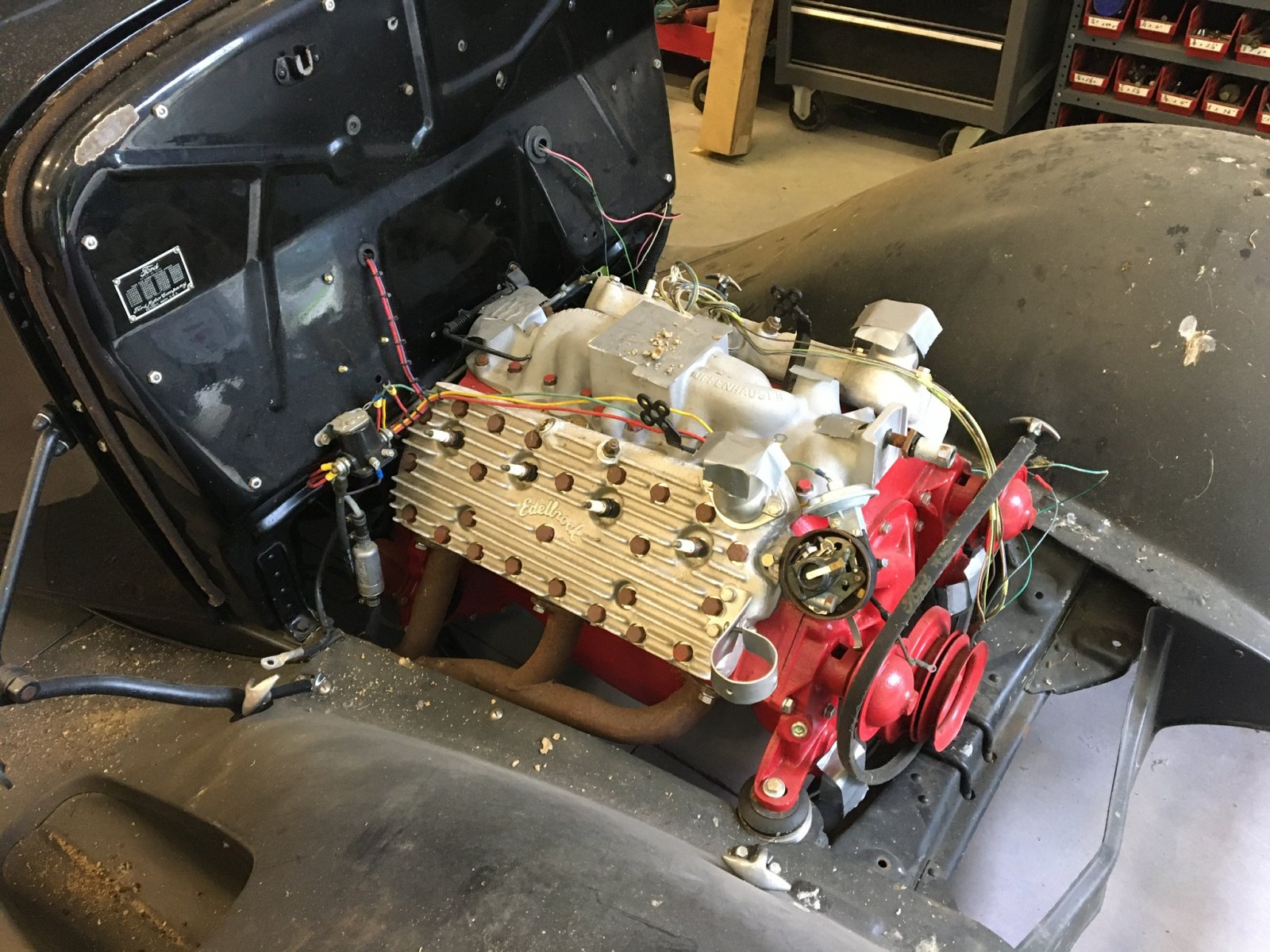

    I figure I’ll use this thread to update the progress of getting the truck back going again..

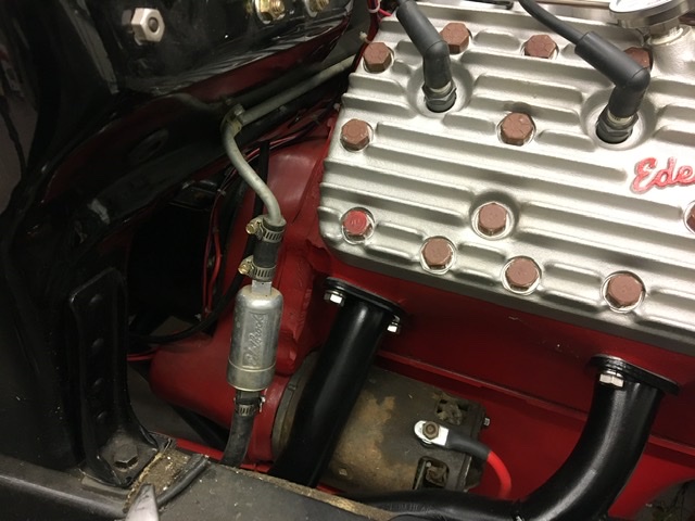

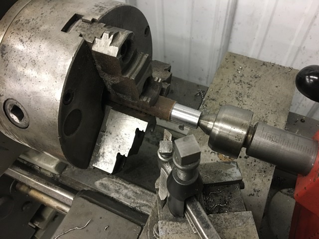

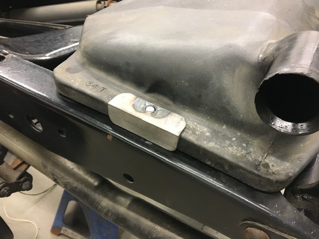

    Been chipping away at it since I picked it up.. so far I’ve be able to
    remove gas tank, clean it out, install new sender, make new hold downs for it(couldn’t remove bolts with the bed on), run new wires for sender
    run new fuel line, install electric fuel pump, run power wire for new pump
    blast and paint the headers, heads, and I take
    repair, replace, and rewire some of the wiring
    Install new distributor, coil, plug wires, wire holders, new wiring for ignition system

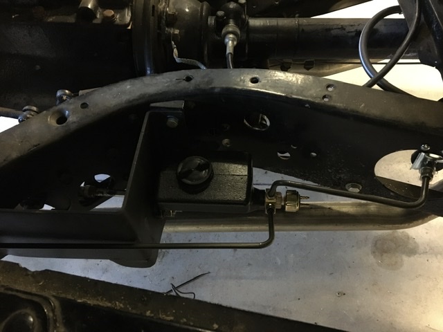

    Change our old unknown brake master for early ford, rework mount for that to locate it in correct place(old one the rod from pedal was at way to much of a side angle, new hose and bracket to feed the rear lines, new line to feed from brakes..

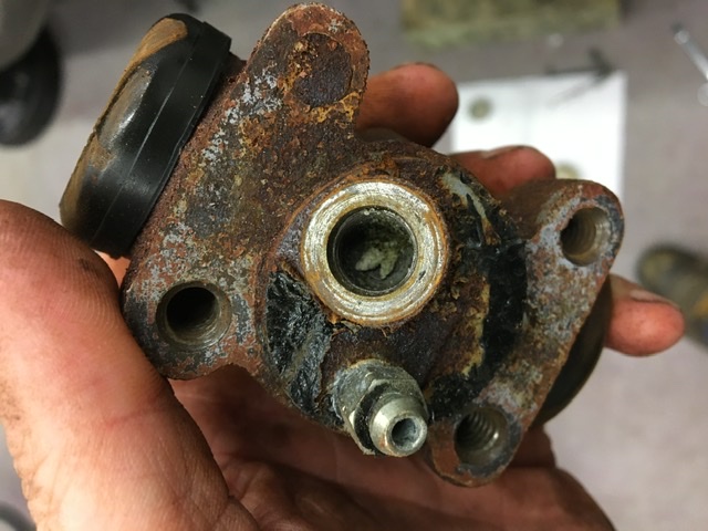

    Pulled the from hubs to inspect brakes and replace leaking drivers side wheel cylinder.. going to replace all wheel cylinders and hoses..
    tracked down two square bore wcfb carbs which the kit should be here tomorrow..
    still a lot of little things left.. need to figure out a fan since the 8ba fan sticks out just a bit far and hits the radiator..
    here are some pics of what’s been going on.. I have no idea why this site likes to flip pictures around when they show up just fine on my phone and when they are uploaded.. then post all different directions..
    FB908D19-7B55-4045-ADDF-5A92CA8CFB81.jpeg 76C36E41-39B8-4C0E-B2C5-6B5AAFDDDC1A.jpeg 0E942E76-6C2A-4916-9B4E-6022DDA073BD.jpeg 52E17239-1585-4CB8-B559-60F2AE43AFE9.jpeg 203D4760-640E-43E0-B0DC-672C26C67FA7.jpeg C15A510C-8759-4311-9BB7-E789EE15B162.jpeg BBF44DCD-E1F9-43DF-BCF1-594C5ED5F4EB.jpeg 97777196-575B-4F0A-AAD6-4BF2D49D556A.jpeg EE4BE713-B032-41E8-94CD-7F80E5F44647.jpeg 9653107E-2A9F-4A87-BACC-65B3DD7E9469.jpeg 3CFC5588-DD30-4CF0-9596-4A756BE942C4.jpeg 50543693-B9C1-449F-8F8B-C3FD5078927C.jpeg 4CA62F8D-DAF5-438E-8ACD-39A64553E211.jpeg 26B35816-774B-45CC-A401-002AADFE7D45.jpeg 10B1D01F-B4DC-47D1-AEC4-07A0ABD11D3D.jpeg 6837AE4C-0C3E-4A9E-A1B0-7A7543E55082.jpeg 28787EC2-E9FE-432A-A633-67F4081AA066.jpeg 2B7E97A5-A123-48B9-9048-864DD2183C20.jpeg 0B7D71AB-E850-4550-930B-29B085C0B786.jpeg F2BC624E-8570-40D8-AB9B-27C1DCC35FD5.jpeg ABA42B17-4B76-4CA1-A3A0-C4E8DDE5D994.jpeg F19A95BF-952C-4F1E-966A-4A62E8204A3C.jpeg 332F35EB-B5EF-4AD0-B71A-349C4EE94702.jpeg 76F0DEF7-5F5C-4842-B215-563C04C5350E.jpeg

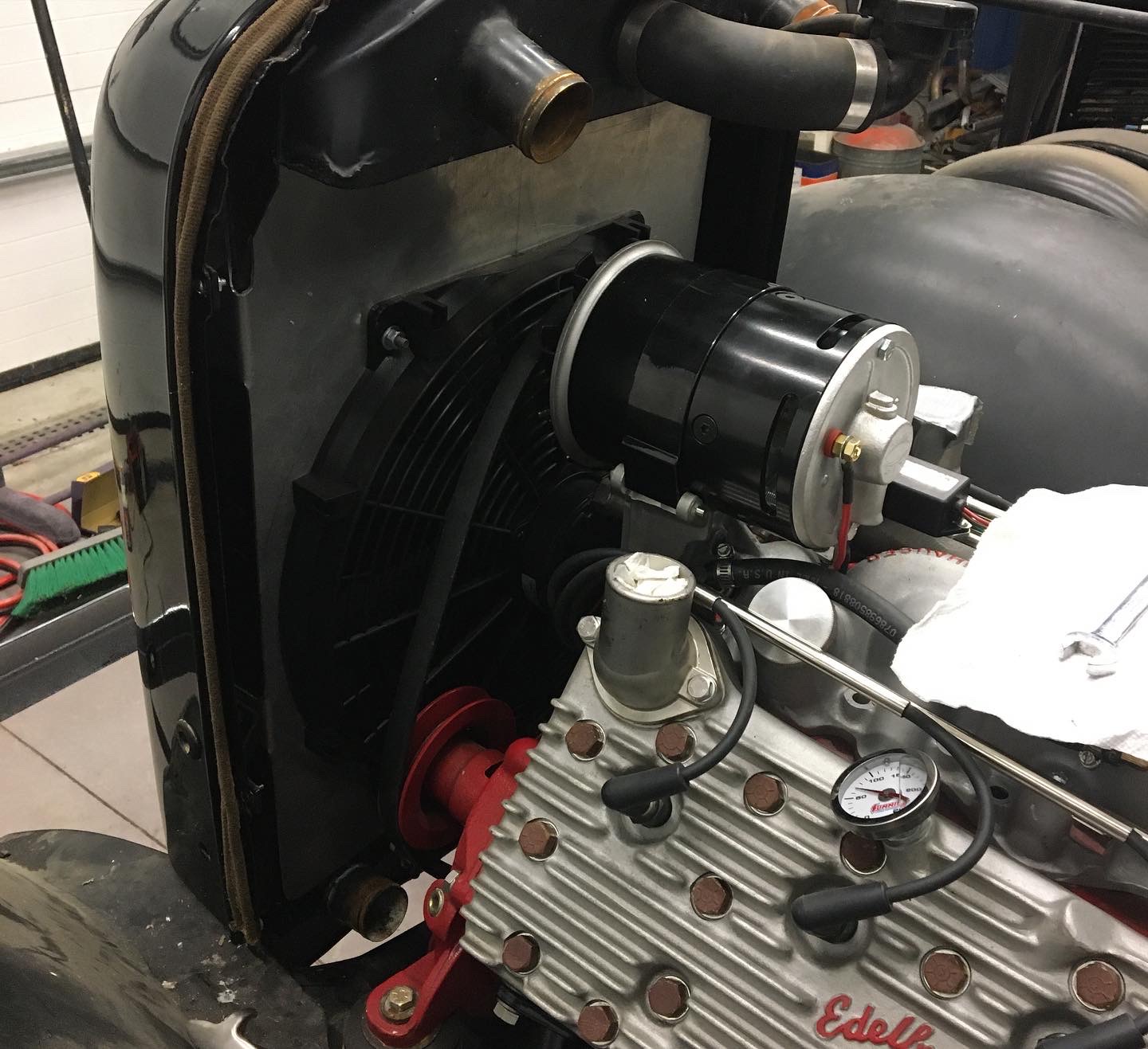

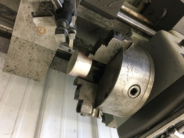

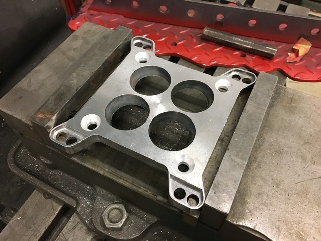

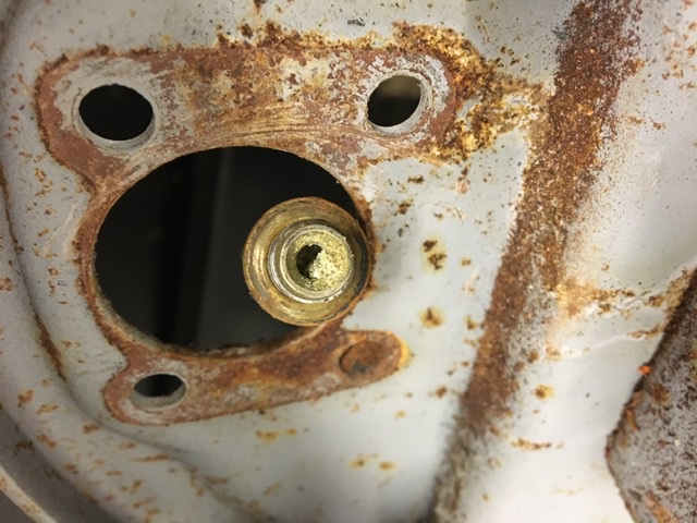

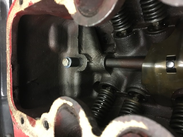

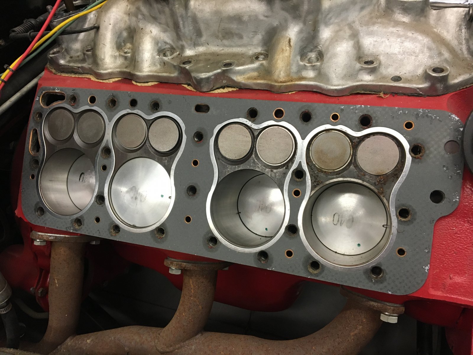

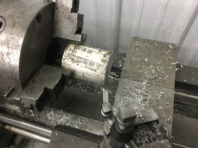

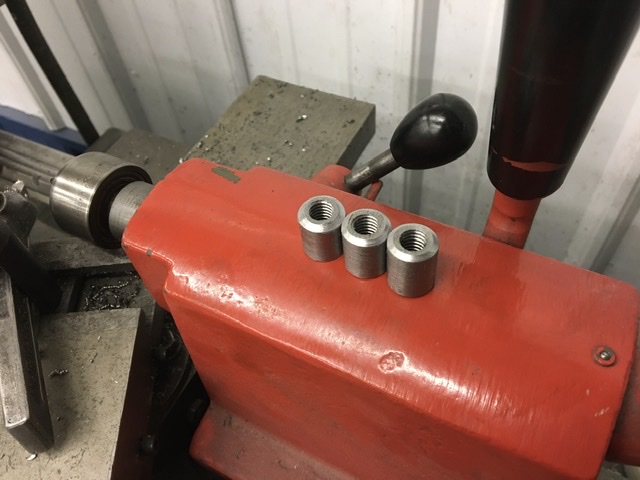

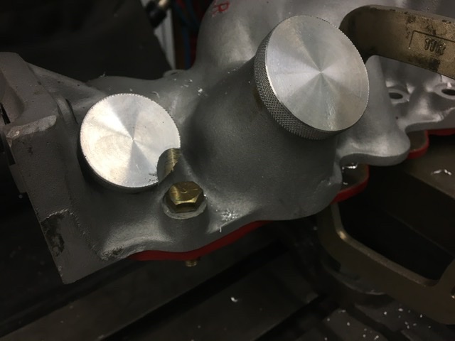

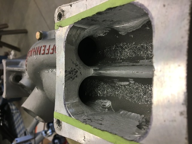

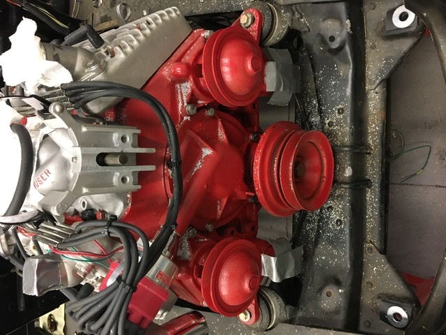

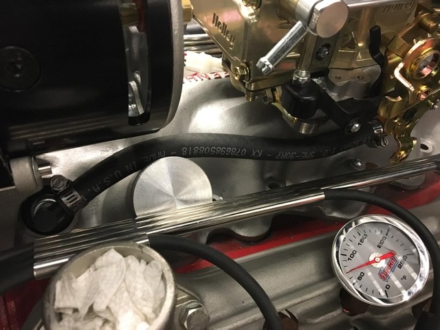

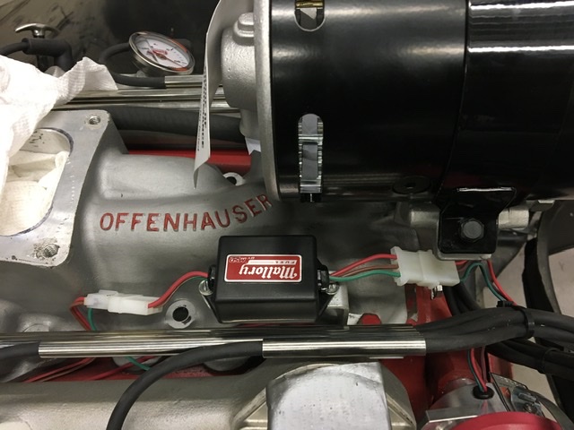

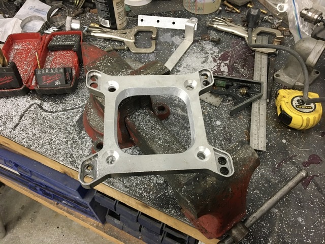

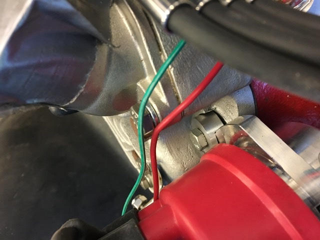

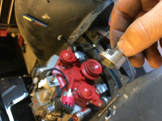

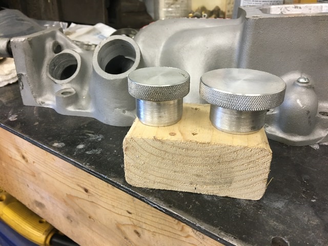

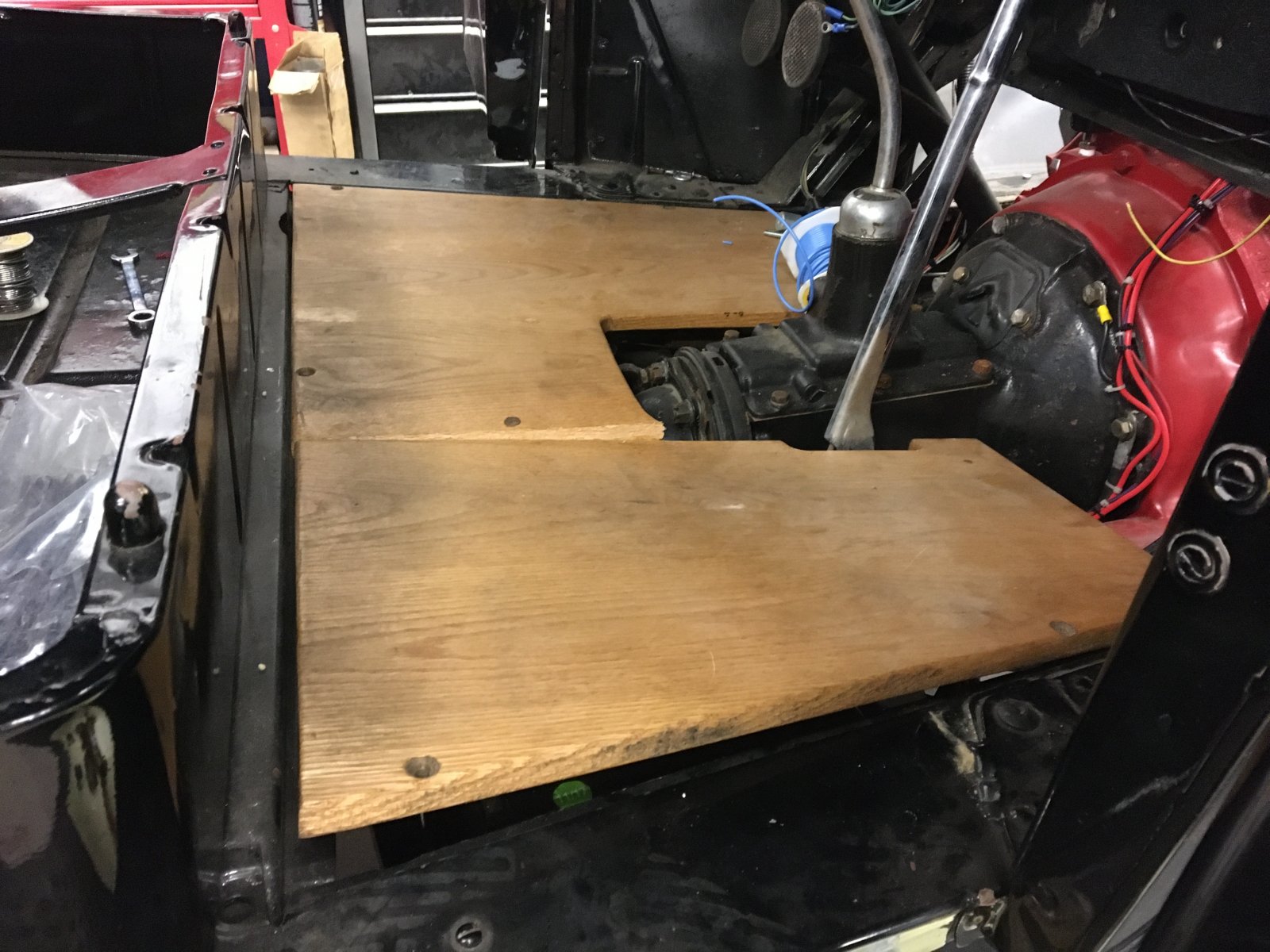

    Few more updates.. worked on the intake and generator/alternator setup.. had to clearance the front part of the intake so the mount would slide down..
    8A809725-4B56-4753-AE52-83533135FC98.jpeg 9B1749C3-C7F0-4228-B7E9-EAE382496DD1.jpeg

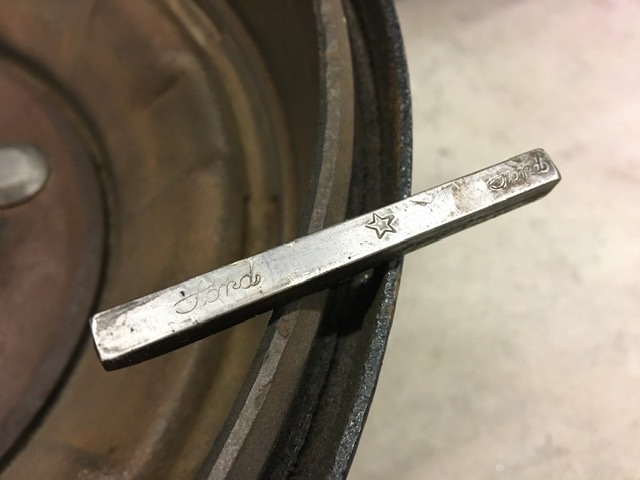

    while doing the rear brakes kind of cool to see the old stampings in the key ways 1E067EE1-D7C4-4B4E-8DCE-D2365FFA8B18.jpeg CC64858E-1E53-447C-BF93-92B5570CB5E5.jpeg 6AF03002-8492-4581-B4E3-18AA836FBC8F.jpeg ECE2475C-8AE2-461E-9EB6-88F14D97AA90.jpeg A5568127-D47A-430E-8C55-147587691EEB.jpeg DD6AFFF4-8A59-4D4E-AAA8-B6EE1EEFF81B.jpeg 021C0931-C9B2-4C97-B20F-BD8227499F64.jpeg 37A20F3D-6142-4659-9AE6-746F4D6EF029.jpeg 6ADFEE24-9450-48F6-BE40-78A74ADEC89E.jpeg 668BACE1-E57A-4894-B41D-F2F46C471C78.jpeg 5BB98FB6-15B7-4744-B381-D8FE25F097AD.jpeg AC95BA08-81E9-4733-8C34-F3D52DF8948C.jpeg 85914BD0-A0C5-4949-AF87-A0606C9BF515.jpeg

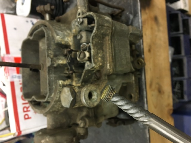

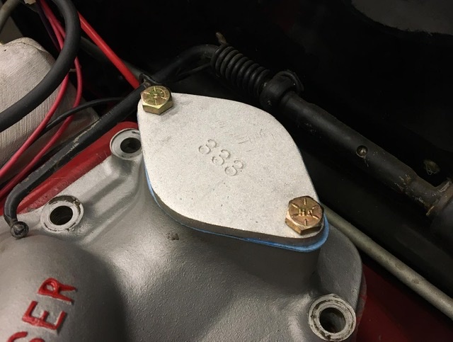

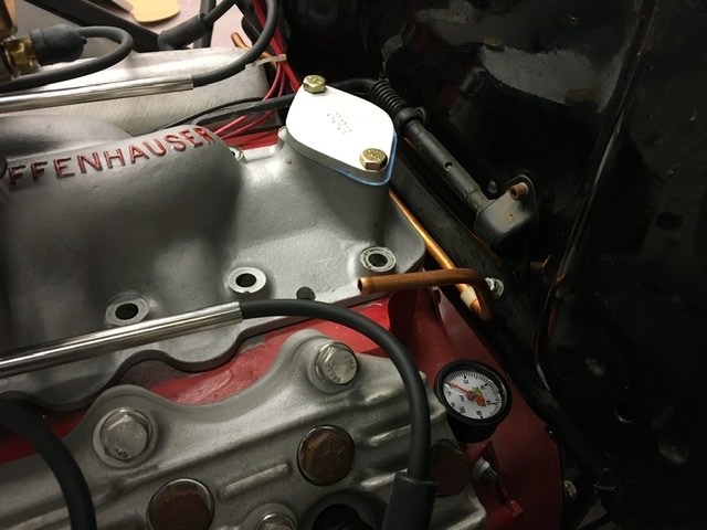

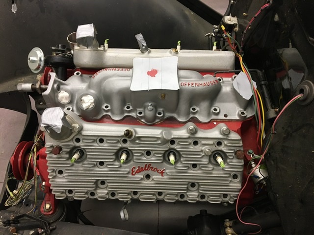

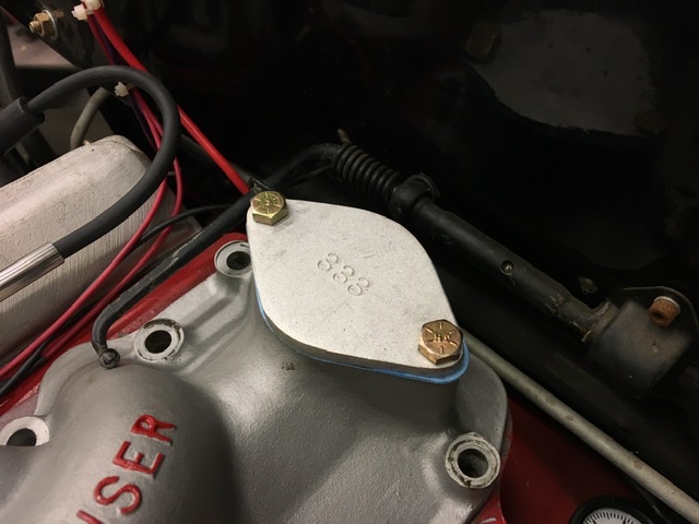

    ended up buying a new Holley 390.. had two wcfb carbs but they were missing linkages and with so many different variations of the wcfb I couldn’t find the linkages for them... due to wanting to get it going broke down and bought the new one..
    Had to remove the one plug to put the pcv valve in its place. Didn’t take the time to think about how the motor actually vented the crankcase.. so moved the pcv idea from the where the fuel pump was up to where the road draft tube/plug was E3297839-FE83-498B-9CE9-CC4A4F2A686A.jpeg
    I believe if I remember right this truck had an earlier (59a) motor when I first looked at it years ago and it sat down lower in the frame.. which would make sense of why a lot of the stuff doesn’t seem to be in the right place or line up with the 8ba in it now
    E21D8118-8757-45AD-8D8D-277F445242BC.jpeg 3679F53F-7BB0-4F09-B515-DA9A01F47D33.jpeg D0FEBAF2-66A8-4A9C-BF86-97DD11663A4A.jpeg C9A10BF5-2119-4600-8839-843ABAFD8A2C.jpeg

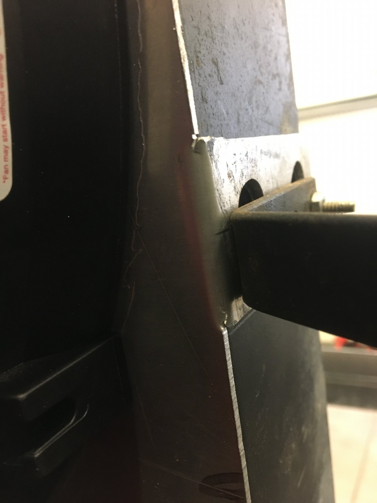

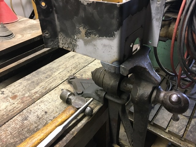

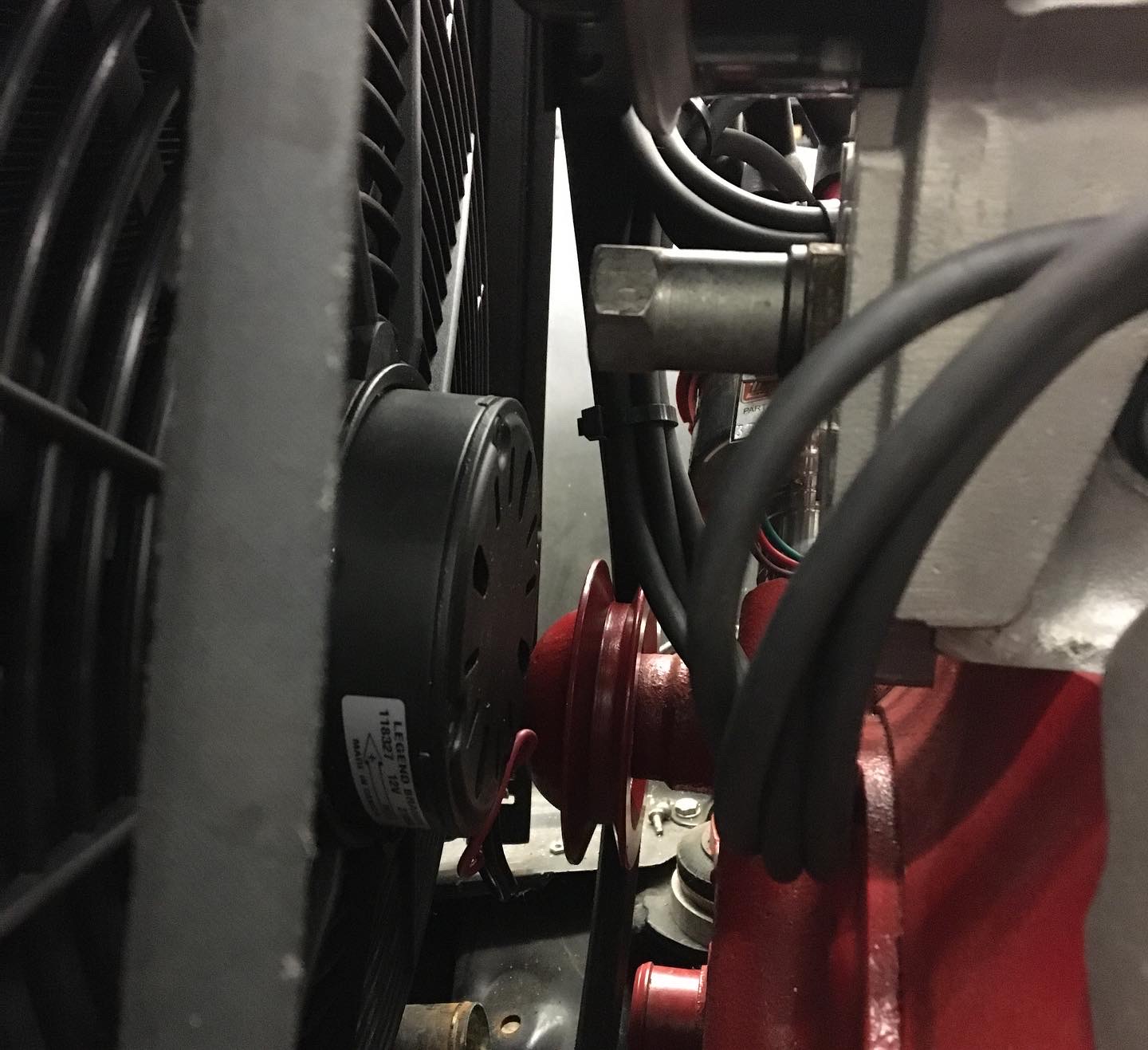

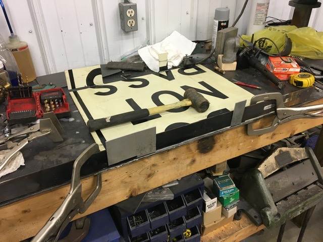

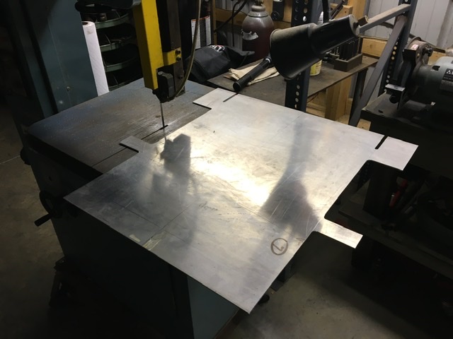

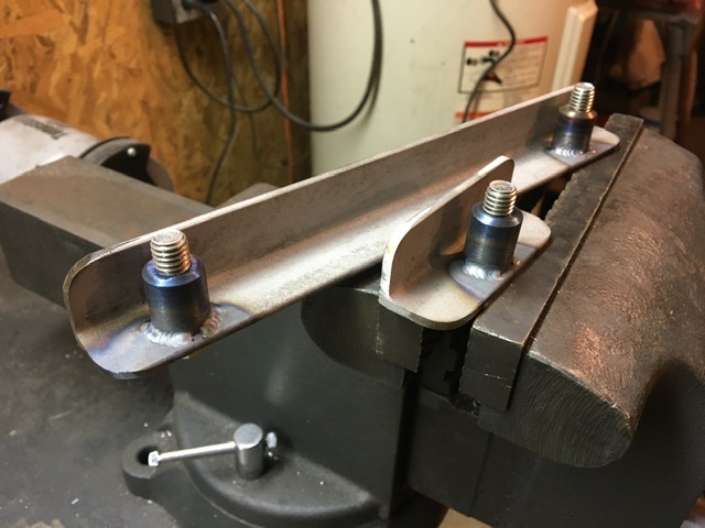

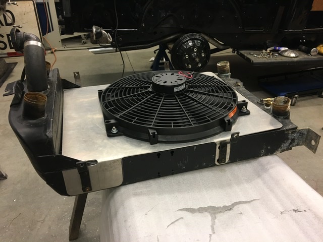

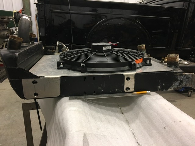

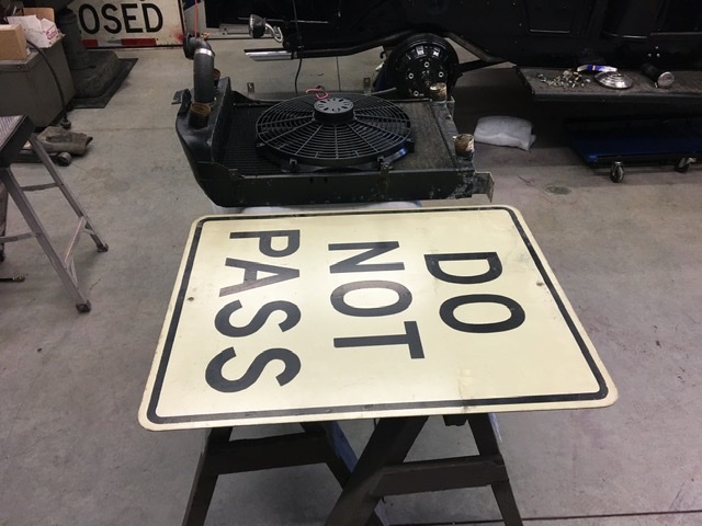

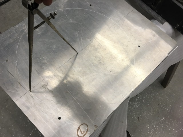

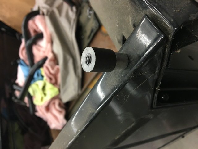

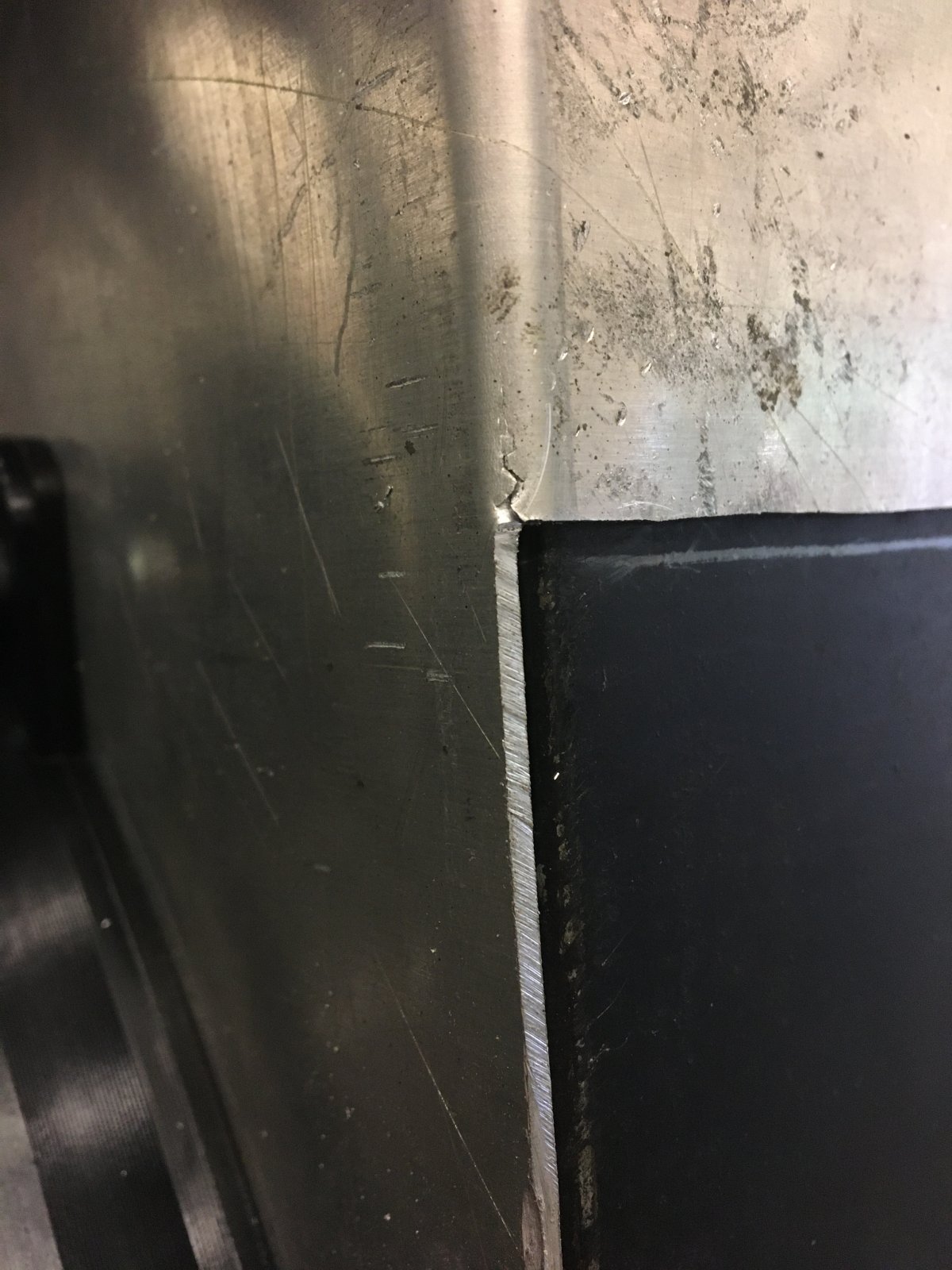

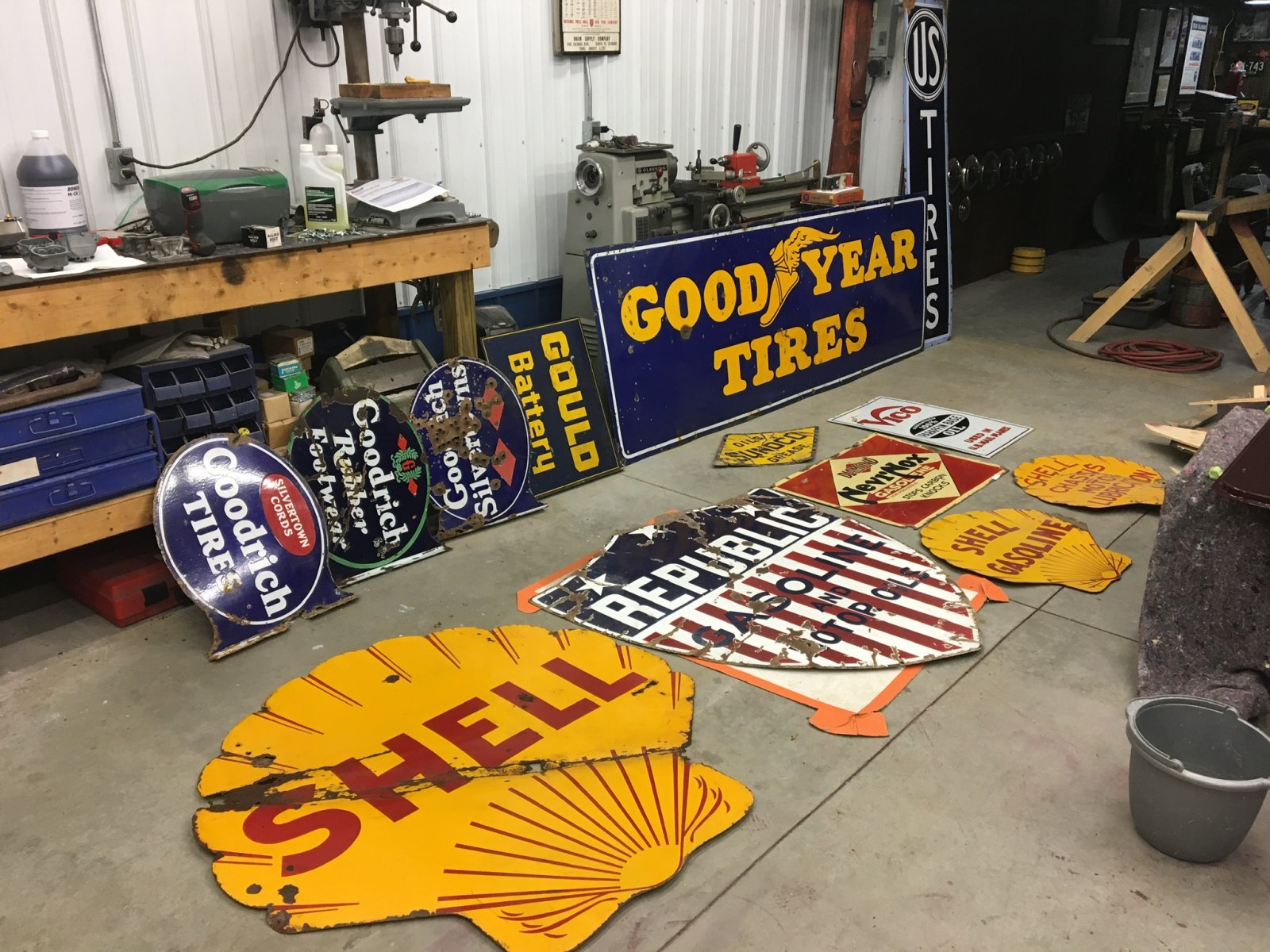

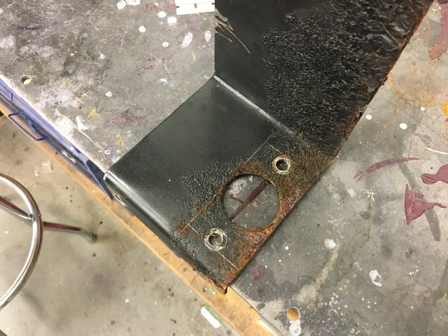

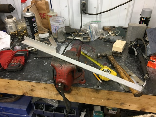

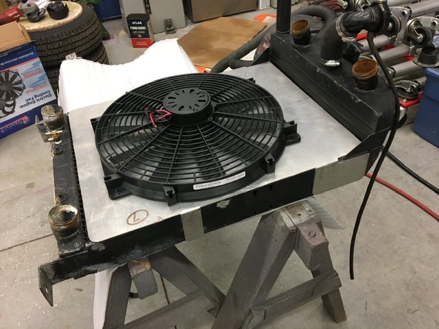

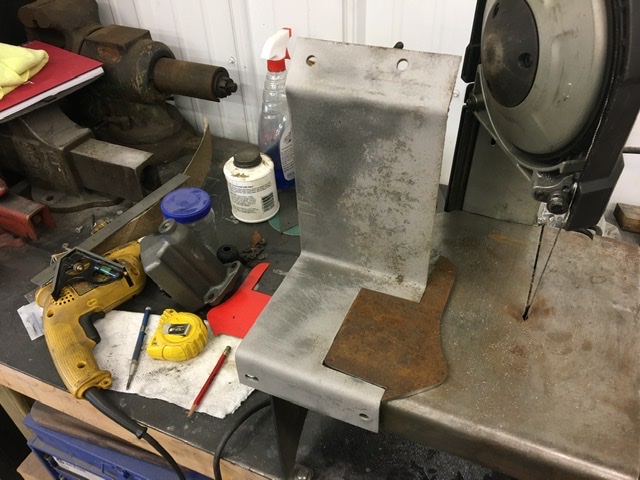

    Unfortunately the stock fan was just not gong to work.. I was running it through my head a million ways to make a fan mount to get a mechanical fan in there... but since I’m limited on time I went the electric route..
    Found out recently that metal prices are through the roof so used what I had laying around.. will strip it and paint it anyway..
    517D6B42-D245-4DCF-BF2E-2F89645D244C.jpeg 4CC8066F-7134-41E8-AC17-B055406CBD88.jpeg FCC6E260-1174-4044-ACDE-ADCD4CDC0DC2.jpeg 5428FC1E-8BDE-4351-91B2-40179B554C3B.jpeg 02447505-DEF6-49AA-BADF-95AC4A5D5642.jpeg E02B8D04-248F-4646-B906-D8200DEF0FDD.jpeg 072C5FFD-83DD-4331-9D10-22976255A3F1.jpeg 7A28D43A-BD45-4BA8-840F-08D94C82586E.jpeg
    176D5A95-B8D5-42A2-9227-D3501F872B94.jpeg 225D2262-E186-432C-ABC5-F97B34E22E9E.jpeg
    not sure if this is a sign I need to start eating better but while laying in the floor board doing some wiring it decided to let go.. I think I’ll just blame it on the wood being old and dry..
    Also it appears that when I chose to resize the images it’s flipping some.. so maybe from here on out I will just not resize them so the won’t be all different directions.
    hope to get the fan wiring finished today and get the gauges changed.. the bus hubs for the capillary tubes should be here tomorrow..
  27. warhorseracing
    Joined: Dec 26, 2006
    Posts: 2,831
    warhorseracing
    from cameron wv
    @twenty8tudor Three questions. Did that sign have the 3M reflective material on it? How did you strip it and get it that clean? Lastly with sign material being not just Aluminum but an alloy. How did you get those 90 Degree bends without it snapping off? Very nice work but I have never got them stripped or bent that good.
    loudbang and olscrounger like this.
  28. twenty8tudor
    Joined: Oct 5, 2010
    Posts: 889
    twenty8tudor
    from Ohio
    I figured they had to be more then just aluminum how tuff they were lol.
    Not sure what brand but this one wasn’t reflective.. my brother used to work for the county highway department and they went through and replaced all the non reflective signs.. that’s where this one come from..
    the two on the p***enger side did crack right on the corner of the bends. I drilled the corners and left the radius when I cut up to it on the band saw.. maybe that helped.. But all I did to bend them was clamp then and bend the up with the hammer.
    6FE7E4DF-2DB2-43DA-8ABC-1086F8B220AE.jpeg CF55DA1C-2550-41F8-B585-186C6374088B.jpeg
    I plan to take my tig and either do a fusion p*** or run a bead on the bends just to make sure that isn’t cracked inside and it won’t snap after vibrating for a while.
    must not stripped yet, the vinyl part is facing the radiator. It was just a single sided sign. If it gives me to much trouble I might not strip is since it can’t be seen anyway. Hope that answers what you were wondering.
  29. warhorseracing
    Posts: 2,831
    warhorseracing
    from cameron wv
    That explains the stripping and those cracks most likely will not migrate but your outlook with either running a fusion p*** or a bead will help. Thanks for the reply.
