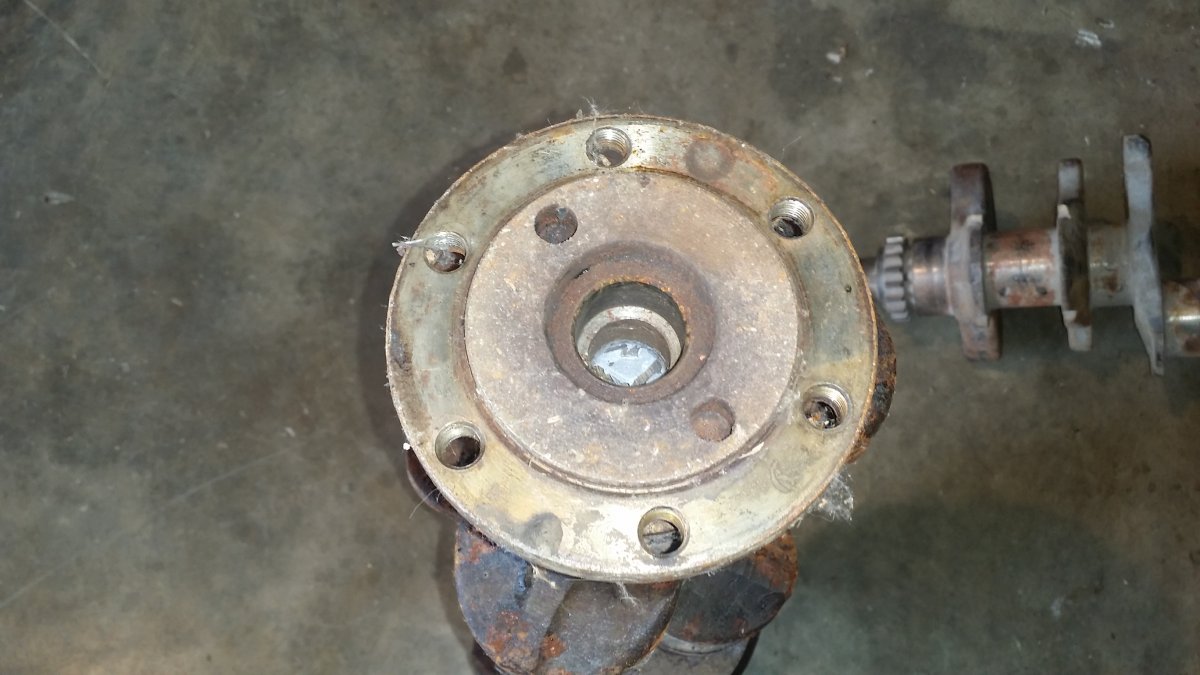

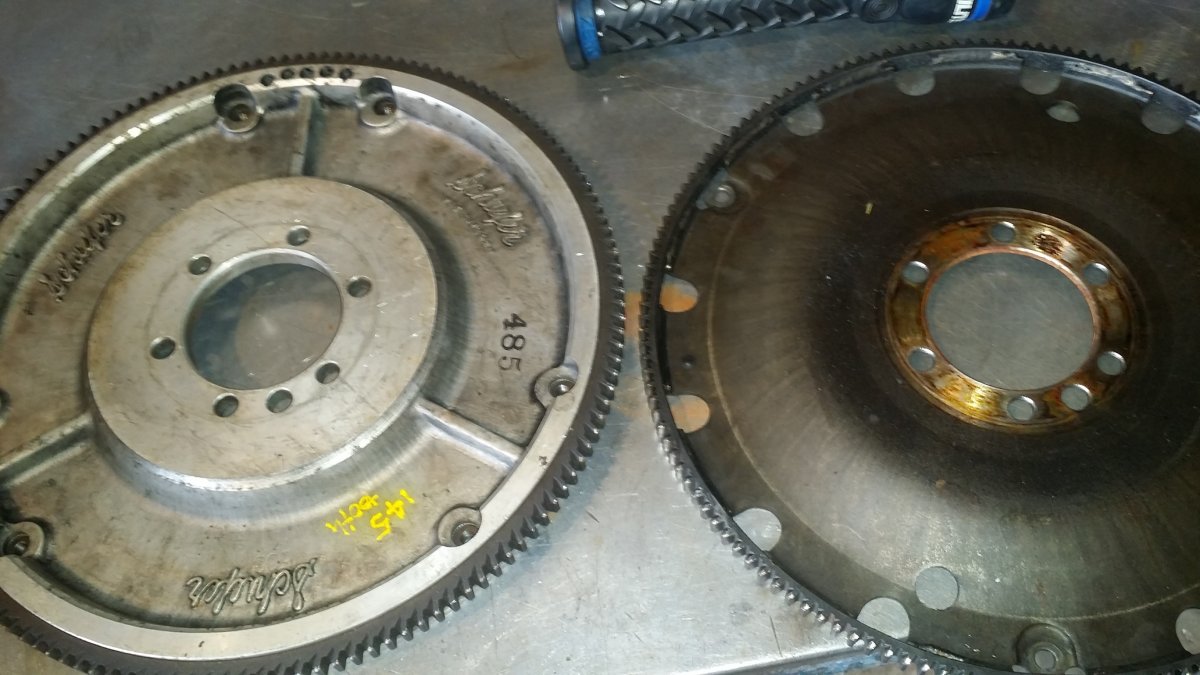

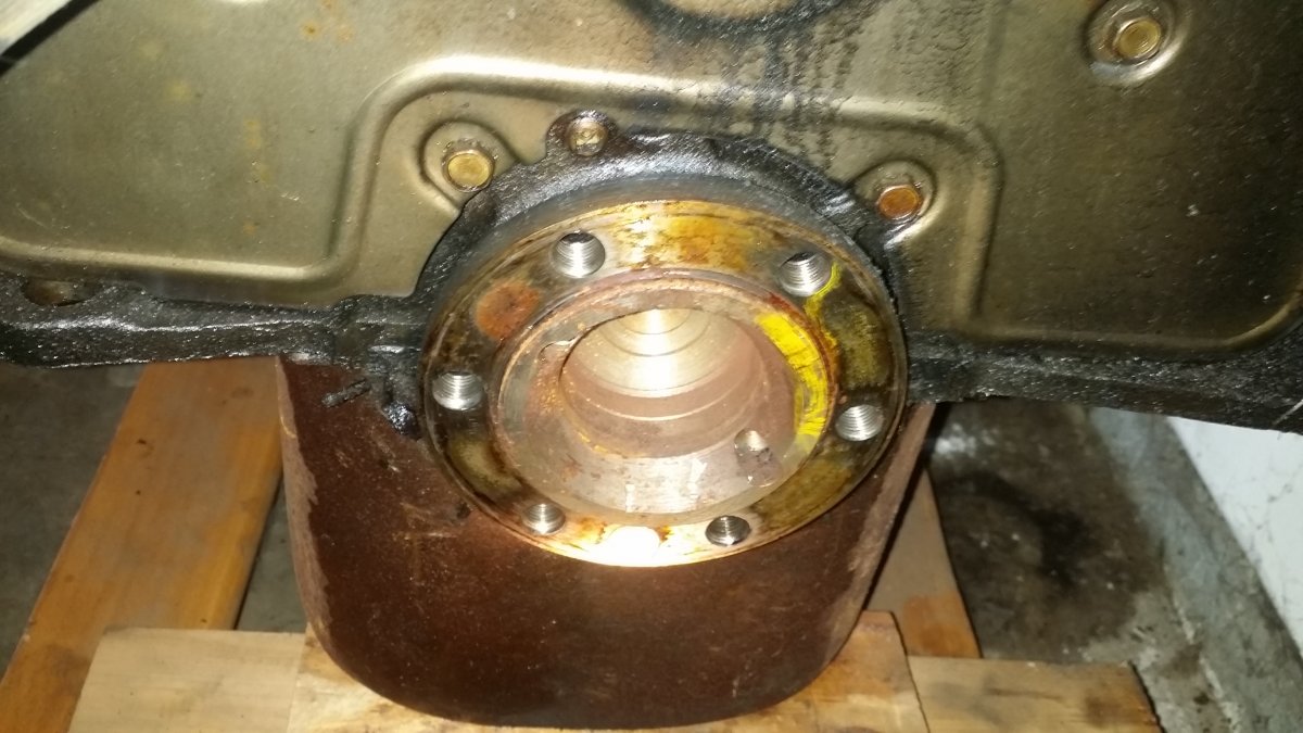

    dug into my spare engine and parts pile,
    the '53 Dynaflow Olds engine's crankshaft appears to be dimensionally the same as a typical crankshaft at the flywheel end with the exception of the chamfer and larger bore in the end.
    flywheel bolts up the same with 145 tooth ring gear in same location.
    you should be able to have a bronze bearing turned to fit the opening and your transmission input shaft.
    pix:
    top: '53 Dynaflow crank
    middle: Shiefer fly on left Dynaflow on right
    bottom: '54 crankshaft drilled for pilot bearing with bearing removed
