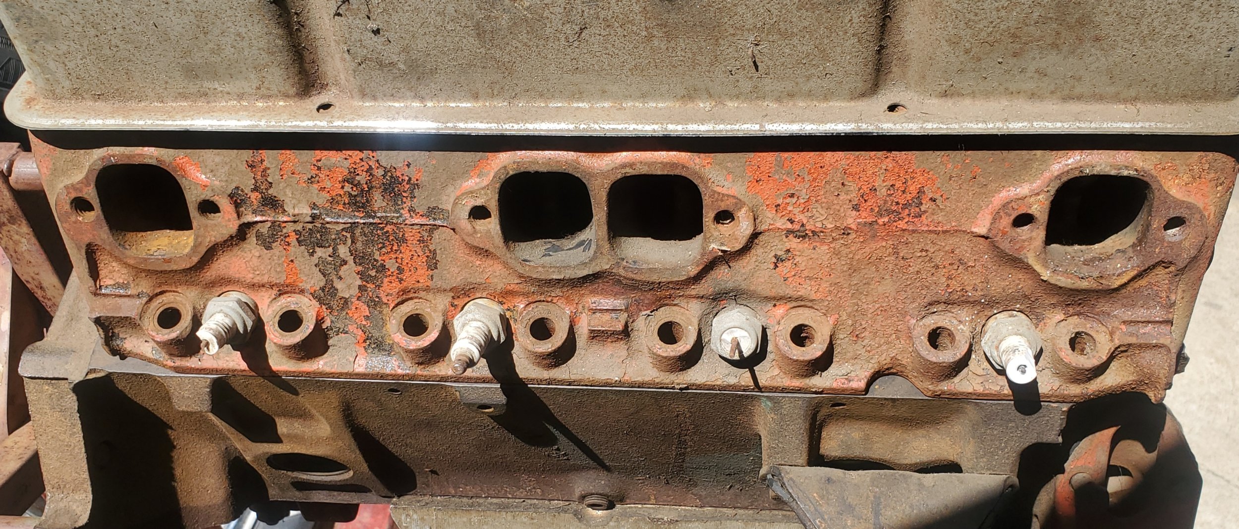

    Heads are cool too...462 casting camel humps..2.02s ported and screw in studs..

    Having worked on small block checks for fifty years thirty three of it full time in my own machine shop I have never seen that main girdle / cap arrangement. I think your first concern should be making an oil pan fit and seal! All the rest is straight forward engine work. Unless your planning on racing it you'll want to lose some compression and likely the cam.
