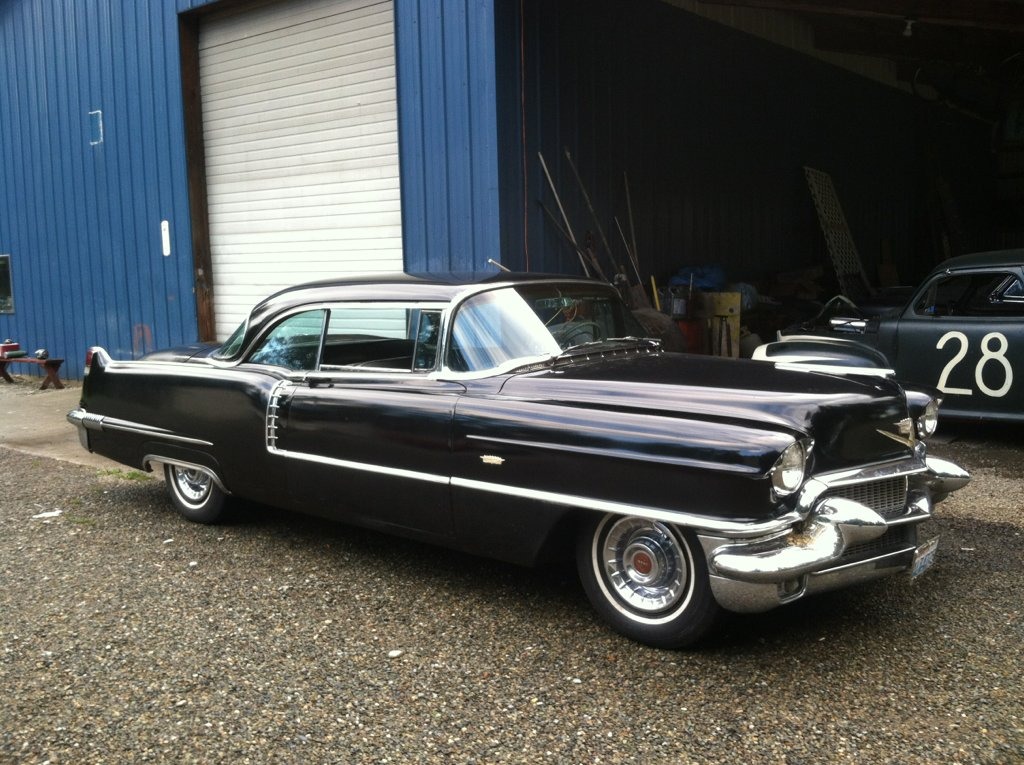

    Found a few things that need to be fixed. Broken speedo cable, speedo is locked up, battery is not being charged when running and the vent cables are froze.
    Anyone know if I need to drop the column a little to pull the speed? I took the four screws out and the bottom cover on the column off. Do I need to discounnect the vent ables from the speedo?

    NO, you don't need to drop the column or the instrument cluster...and you shouldn't have to remove the cables...you should be able to get your hand up in there ...it's simply a 'collar' around the speedo cable that unscrews...

    I have the cable unhooked. The speedo is locked up and I'm trying to figure out if I need to unhooked the vent cables in order to pull the whole speedo out so that I can send it off to get it fixed. Took the four screws out in the speedometer and it still wouldn't move.

    There's prolly more than four screws holding the speedo ***embly in, if that's what you are trying to remove...on a '55 there's about 10.
    And to answer your first question, yes, you will need to drop the column to remove the instrument cluster.
    Perhaps you are talking about the heater controls on the side of the instrument cluster and not the "vent cables"...you would need to remove the heater cables...and those are just "loops" of wire that fit over the controls-usually one small screw holding each one on to the cluster.
