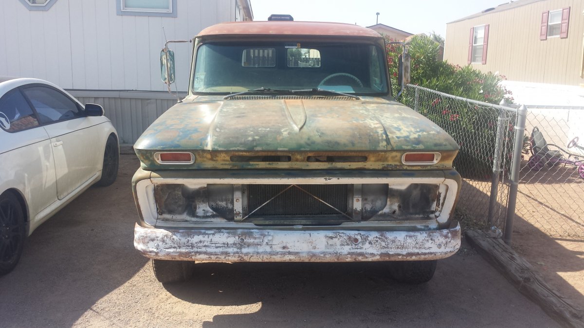

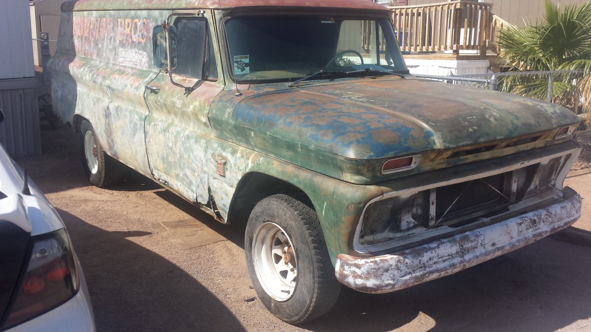

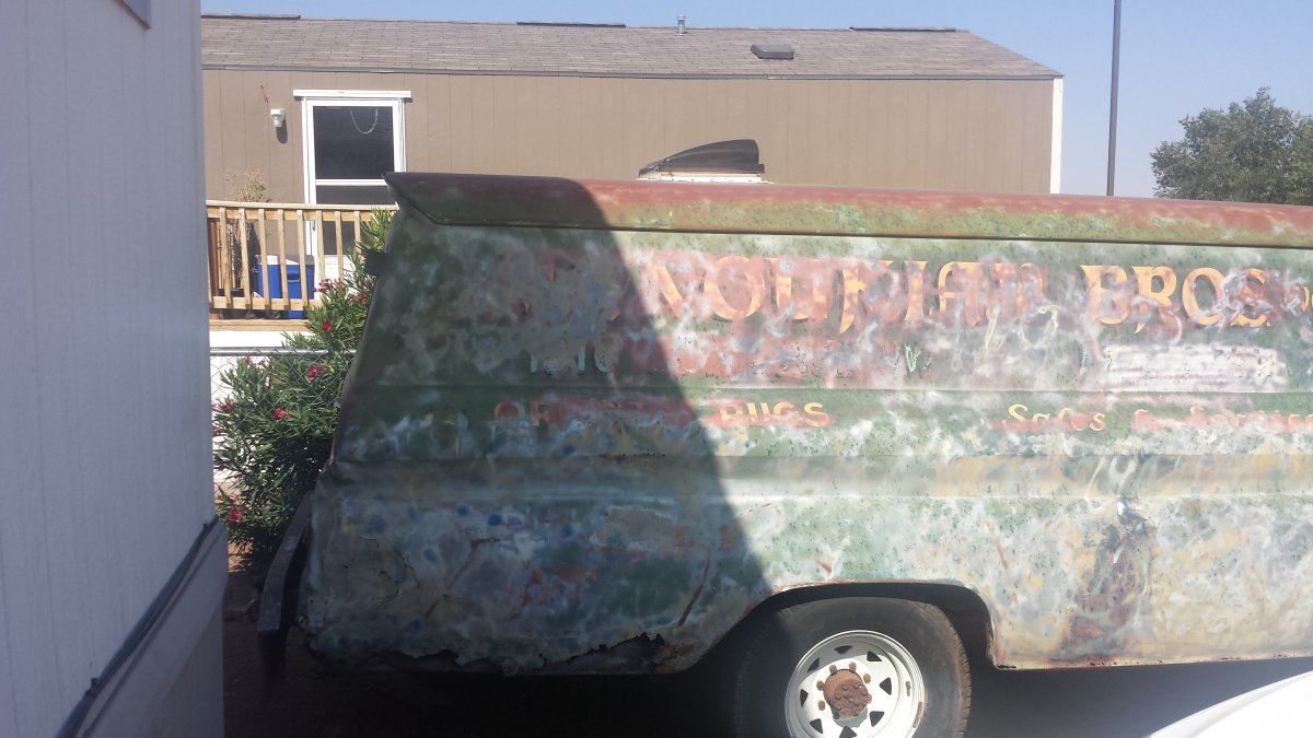

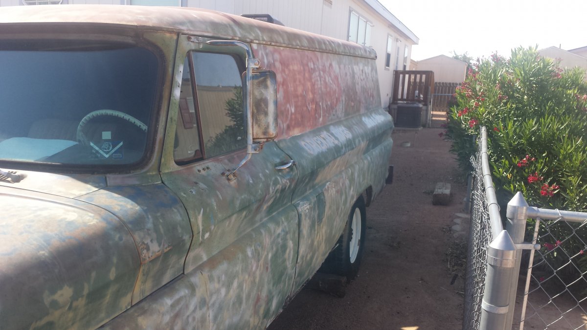

    64 at home 1.jpg 64 at home 2.jpg 64 at home 3.jpg 20160527_163058.jpg here is my 64 panel found her in a field, she had been there since 1997, now she is home, and the fun begins

  16. Flamed48

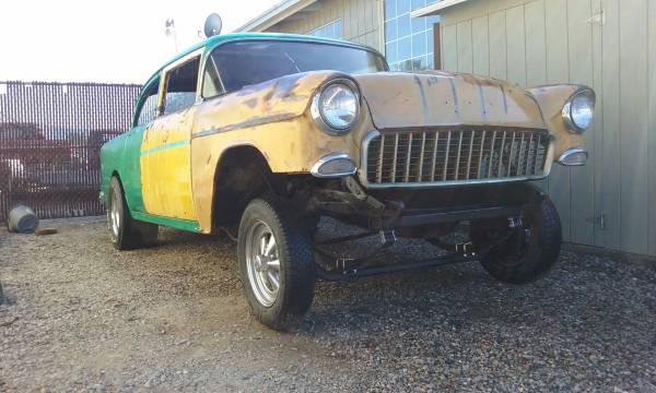

    Joined: Apr 19, 2011
    Posts: 688
    Flamed48
    Here's a *****in 150
  17. low budget
    Joined: Nov 15, 2006
    Posts: 5,566
    low budget
    from Central Ky
    That could be cool if you could get all that spray paint junk or whatever it is off, you need to probably start you own thread dedicated to it, I like the old lettering even tho I cant make out what its says............you could fix the bad spots on the bottom and blend them in with the patina it has under all the funk after you get the funk cleaned off.
