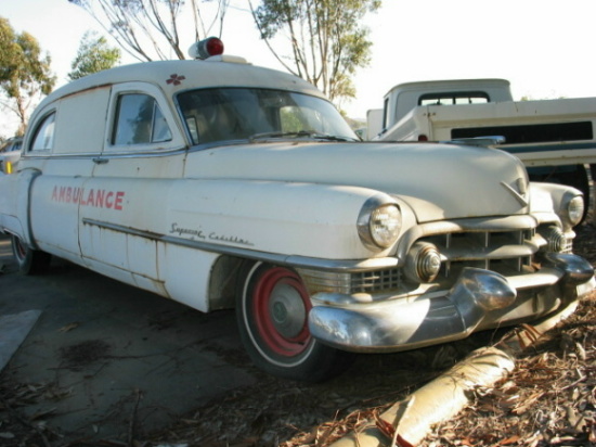

    Picking up this '51 Ambulance tomorrow. 2.5 flat tires, 23K original miles, 2bbl 331, and a 3-spd manual. I've only looked it over twice for a few minutes each time. From memory there was a 12V battery in there and an aftermarket electric fuel pump slapped on the driver-side fender. I know all about firing an engine that's sat for a long time and bringing vehicles back from the dead, but is there an easy way to tell if this thing has been converted to 12V before I go putting juice to the siren, spot, and other stuff? I don't want to fry anything. It's an old Navy ambulance if that makes any difference. Were they 6V originally? Anyone know if the rims are tube type? From the looks of it the tires are original as well. Most of the gee gaws are there. Not sure what I'll do with it but I have a hard time passing up cool junk.
    Am loading it on my trailer, but still don't want to mess anything up. Any advice and info welcome. I found a few service vehicle sites but nothing that has much really good info on the drivetrain and trinkets.

    it looks like a superior. los angeles area, pm me for info on where to get tune up stuff. just give it a try...but if you cant figure it out, id be happy to take it off your hands :)

  11. I thought Superior, too.
    There will be a plate, probably on the cowl with the builder's name, number, etc.
    You didn't think Cadillac built this, did you?? They didn't.

    says superior right there on the fender, guys
  13. Yepp and it looks like its got the "S" hubcaps there too!

    Yeah, it's a Superior Cadillac. Semantics, I guess. To me it's a Caddy. Build plate still riveted to dash with model number, Navy info, etc. Hubcaps, cigarette lighter, etc. all there. It's pretty complete. Figured I could sleep on the gurney when I'm in the doghouse with the wife.
