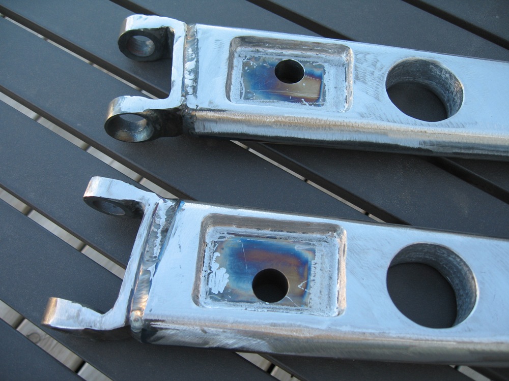

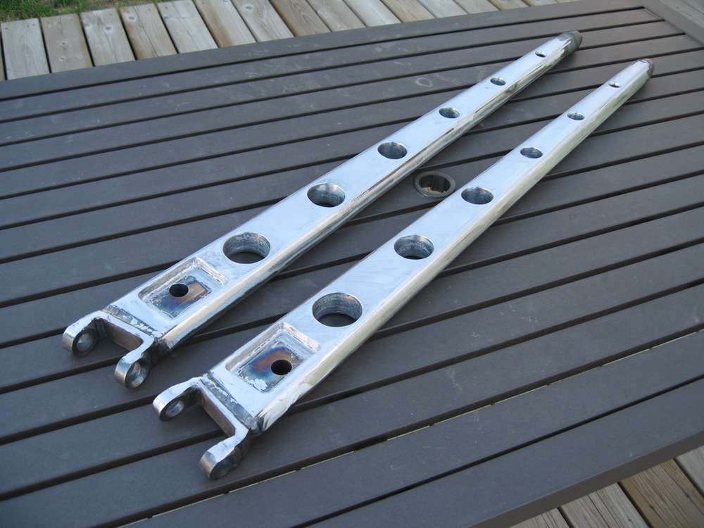

    Not sure how Shadow Rods did theirs. I did mine the old fashioned way , fabricated by hand and TIG welded from solid steel with full penetration welds.
    And yes, a ton of fab and welding work. I like how they turned out though.
    I now have a different axle mounted, a forged So-Cal rather than the Magnum in the pics.
    It's drilled too.
    Larry.

    informative thread, I like the inserts with the mounting holes!
    did you make the entire piece?

    This turned into a very cool thread, are those bones that Blue one fabbed solid or tapered square stock, I studied that one picture for a while can't tell, I like this bolt better than the welds, the bolt is the bolt, no penetration issues there, but did you weld that bolt on to the shackle ***embly? If so, did it stay grade 8 or was the heat treat lost to the weld process?

    The perch is welded to the end of the bolt. Larry (Blue One) is obviously a gifted fabricator and mechnically inclined, his seup seems to be better constructed and more well thought out than most. I'm sure it will work fine. As long as the bolt stays tight and isn't allowed to work at all. Still, I don't think I'd use this type of suspension on my car... It's just as easy to use a forged perch pin that p***es through the bone and is welded solid on both sides.

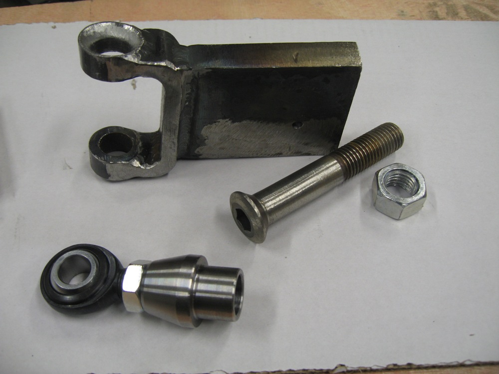

    If you take a look at the pictures, you can see I fabbed the bones from bent 11 gauge cold rolled sheet. Nice and clean material cold rolled and thicker than 1/8" hot rolled sheet.
    By bending them and then welding the shells together they make a very strong tubular member and the end where the spring perch is located is 1" thick solid steel back towards the first lightening hole.
    The lightening holes will actually make the whole works stronger too as they have the tubing through the holes and are welded on both ends.
    The grade 8 bolts were saddle ground to the shape of the spring perch and I Tig welded them on, should be very strong and it's doubtful anything was lost in strength.
    :eek: Gee thanks . I have been a welder- fabricator all my life ( am now 56 and started at 17 ) and now (last 13 years) teach welding and inspection, metallurgy etc.
    In the field my specialty was TIG pressure piping and vessel work, a**** other things.
    With the back up plate I explained above all tied together with the lower shock mount nothing will move and it should work well.

    Love the construction of the bones, You don't think you lost anything by welding the 3/4 grade 8 to the shackle? That would be my only fear. I can't see the other side of it, did you put in a cotter pin or use a cinch nut or lock nut? Did you make your frame from flat stock welded together, what gauge and steel type did you use? Thanks

    See post #48 above. The nuts will be full thickness nylocks on final ***embly.
