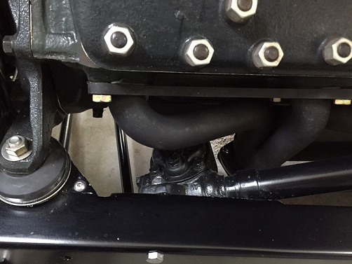

  2. Any picture in regards to your steering setup ? Trying to see where the box is .... behind the left wheel ? Tasty roadster sir.
  3. 19-c
    Joined: Jun 15, 2009
    Posts: 1,097
    19-c
    I used a 40 Ford box. Its tucked nicely next to the flathead. Oh my does that cross steering work nice!

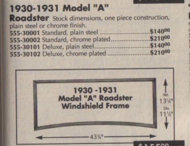

    19-C who started this thread hasn't been on the site in about 5 months. Randy Gribble, who owns Lake City Rod & Custom in Watertown, South Dakota might be a good contact to track him down (he mentions Randy in an earlier post) although I think I heard Randy may have retired. A search still brings up his shop.
    As far as your windshield chop, there were two different stock sizes used in 30-31 - one for the Standard model (fairly rare) and one about 2 inches shorter on the Deluxe model (much more common). Nice looking car, sounds like you're enjoying it!! 19-C might enjoy knowing it's present status!!
    Here's a windshield pic from an old catalogue.
