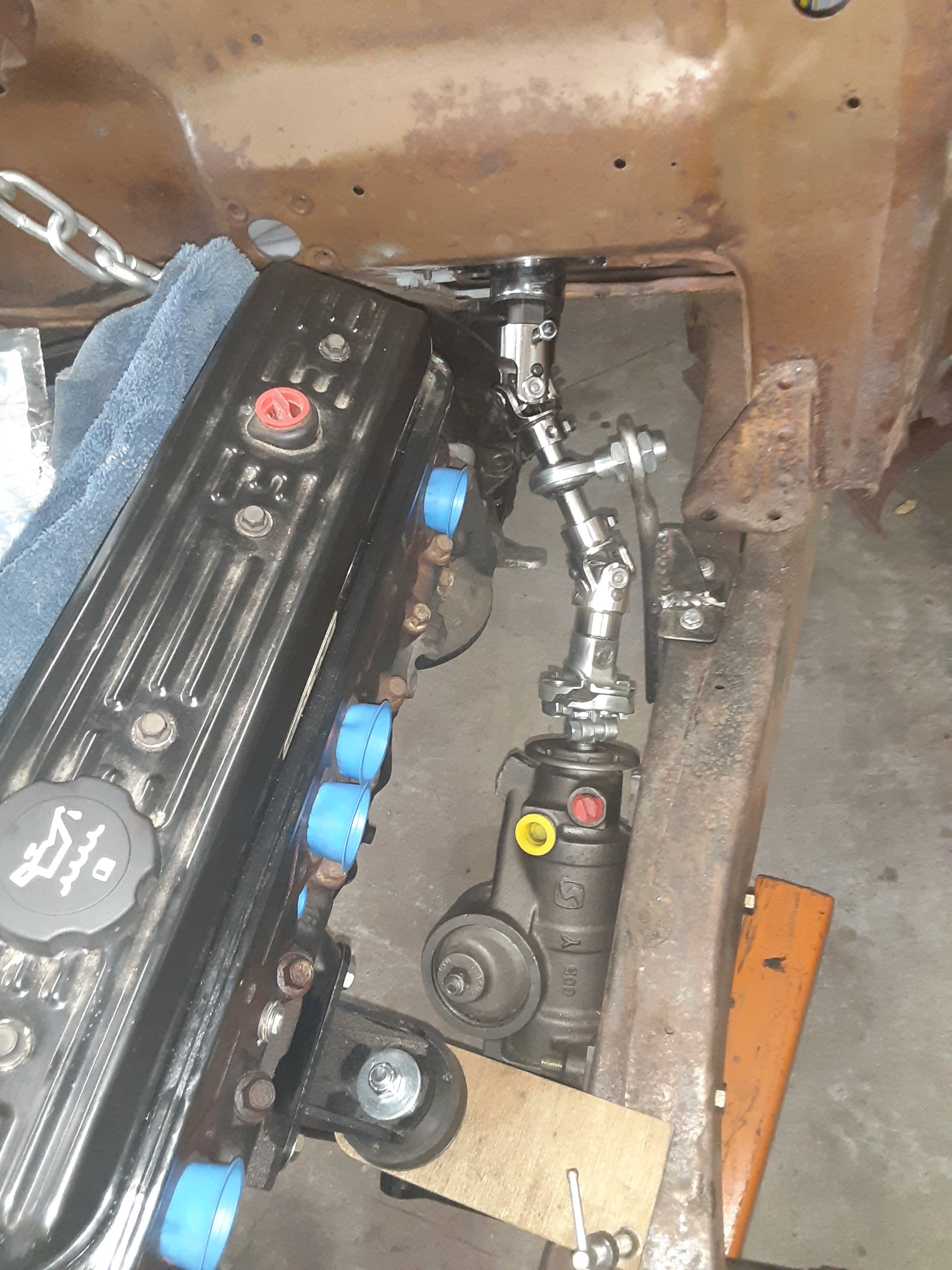

    I could use some good reference pics. I’m back to work on the 39 Pontiac. It’s a Series 25, which is basically a 39 Chevrolet coupe body with a Pontiac firewall, frame and fenders.
    While attempting to fit an SBC , I’m having fits along the drivers side. The car was originally a 6 cylinder. The SBC is obviously wider creating a squeeze along the left rail where there is so much stuff going on; exhaust, steering column modified with universals and 605 power steering box, the oil filter and the engine mount. I’m also attempting to keep the original front suspension ( and rear end).
    Surfing the net I see SBCs stuffed in a variety of pinch frame, fat fender cars, but can’t really SEE how they navigated the maze.
    As a side note, what I do see is the SBCs are located very close to the firewall. With the SBC being two cylinders shorter than the original 6 cylinder it poses issues getting the fan close enough to the radiator. Moving it forward isn’t an issue (is it?).
    I’ve experimented with the obvious solutions like using a forward saddle engine mount to create room / using an electric fan to fill in that space up front / various header or exhaust options. Regardless of the chosen options, she’s still gonna be a squeeze.
    So all that being said, can we see some clear examples of engine placement in fat fender cars? I need some good pics and a kick in the pants to get me moving forward.

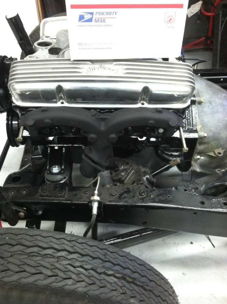

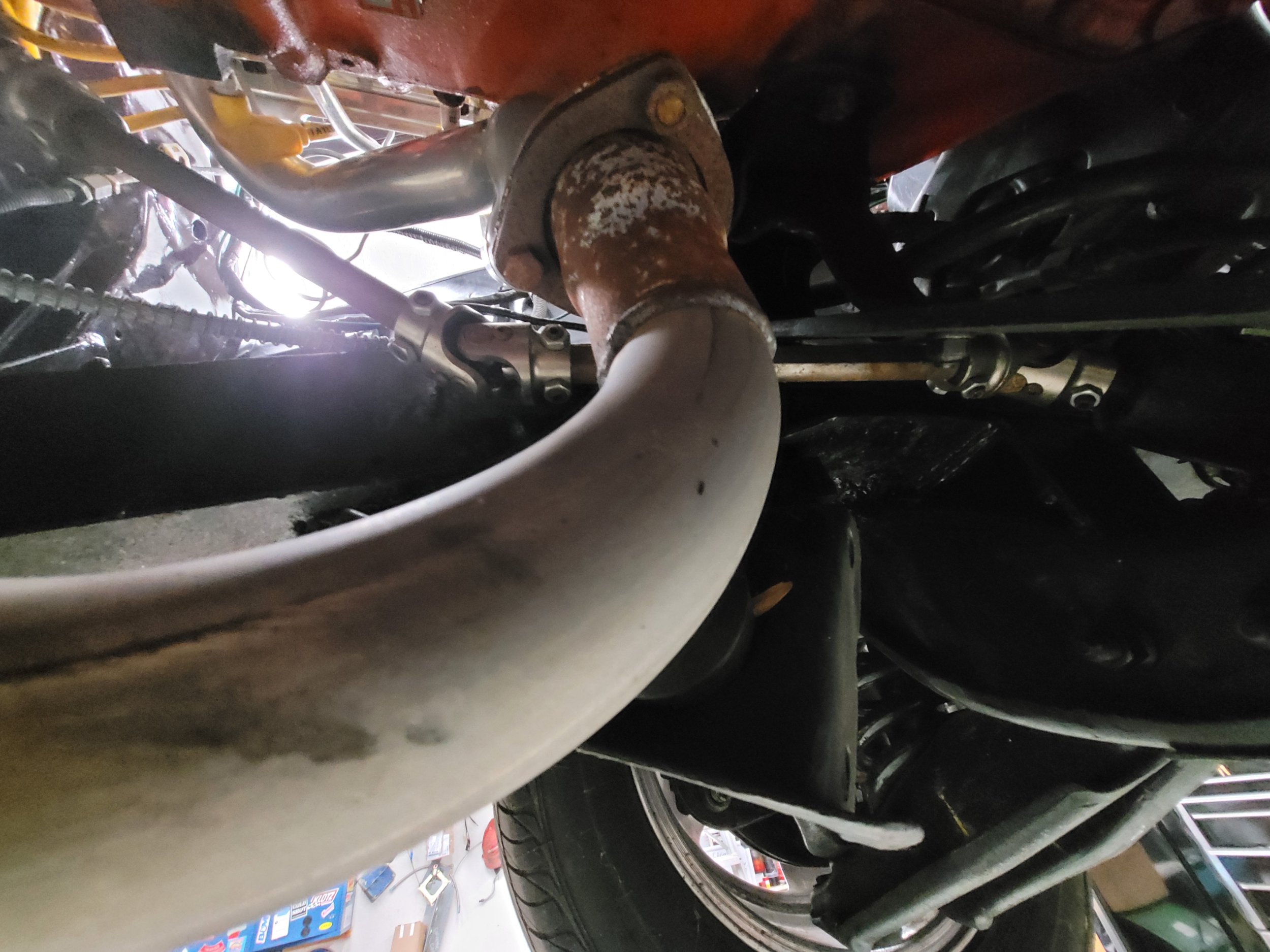

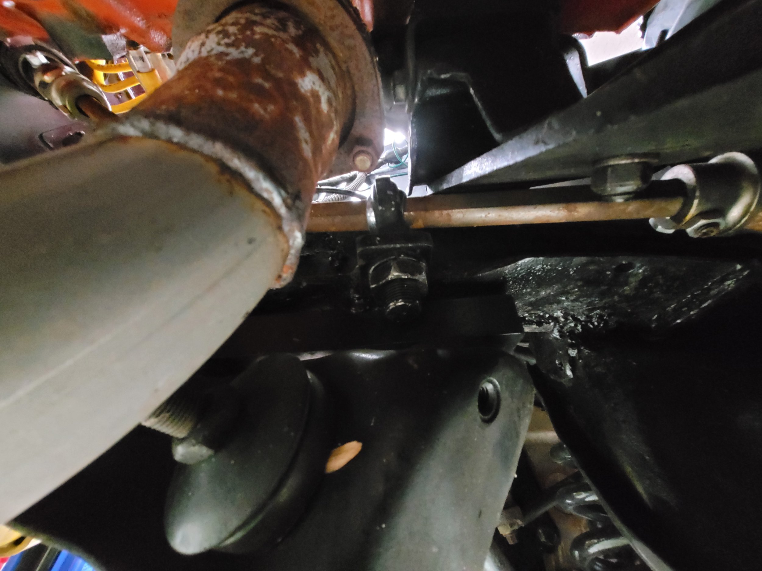

    How about a CE forward offset left mount and Chev truck exhaust manifold to get the around the front of the steering like is done on Fords.
    Maybe there is a reason for it; but if you got rid of the rag joint on the steering box and hooked the U-joint on directly; the joint angles would be a whole lot better and there would be no need for that Heim end shaft hanger.

    Now we’re thinking I like the RH rams horn on the LH side.. hmmm. And the offset mount is a good idea also.
