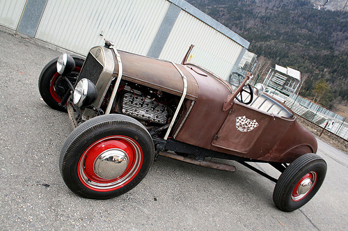

  4. need louvers ?
    Joined: Nov 20, 2008
    Posts: 12,901
    need louvers ?
    If you do a search here on the H.A.M.B., there is already a thread on "T"s on "A" rails that is a couple pages long. Judging from the pictures posted the above member prefers his cars a bit lower than you can get with a stock "A" frame. For more modern build like his I can agree that using a stock frame is maybe not the best way to go. If you are looking for more of a traditional highboy kinda look, I would definitely use the "A" frame and follow loosely the Mike Bishop/ Vern Tardell book as to how it should be set up.
    As far as putting the Plymouth wheels on, they are just a standard 5on4 1/2" pattern used by moder Fords and Mopar forever. To put them on a stock "A" chassis would require simply redrilling the bolt pattern in the drums... But then again, with your parts list your not going to be using stock "A" brakes, either.
    From the parts list you describe, (and it's a good one!) it looks to me like you should grab the afore mentioned book, do some searches here on the board, and just see what it is going to take to put this combination of parts together. In my humble opinion, a late "T" on "A" rails with a neat period powerplant and detailing is about as good as it gets!
    Your last quick question about the pickup bed is answered by a simple "yes". That was part of the deal with the last of the "T"s, the abilitie to swap out the turtle and the box at will. It isn't so easy that you would do it all the time on a whim, but it not hard at all.

    Hi louvers,
    Thanks for your response, and the photo. I think I've been through most of the previous threads including the classifieds already. Maybe I could put all of those photos in this thread to help other folks in the future find a nice condensed list. Here is the front view of the roadster you posted. I saw some reference to that book, is it that good?
    Thanks for the compliments on my list, I hope it will come together well. I'm not sure of the grille yet, so I'm going to have to keep thinking about that one.
    I didn't realize the lug pattern swap would be so simple. Also, it's very exciting that it could be either a roadster or a pickup. I like that idea alot.
    Thanks!

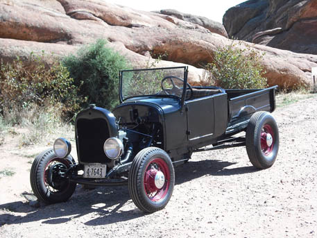

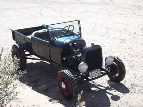

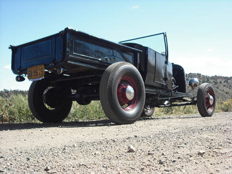

  12. Here are a couple of examples on A frames, but old style with bangers.
    Also Bob Wilson's with a Desoto, but on 32 rails. Bitchin car!!:cool:

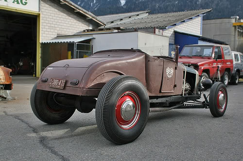

  16. titus
    Joined: Dec 6, 2003
    Posts: 5,191
    titus
    heres one
